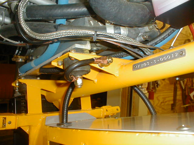

Hey guys,
I came up with this idea for a good ground attach point for the ground cable to airframe point. Its a GM side post extention that is made for external amps in cars and I think it will work better than just bolting the cable end to the airframe. It is made out of brass and with dieletric compound should make a nice solid connection. If any want the part number let me know. They are available at any NAPA store. Also there is a "thinner" 3/8" nut for the back side of it that can be found on a GM starter. It leaves the "2 threads" extruded that the DAR's like. Someone may can come up with an AN nut. I just robbed a starter and used the star shaped locking washer.

That is very clean looking, and should be a solid ground.

Paul, I think you may have the meaning of dielectric backwards. I did for a long time then finally looked it up and realized I had been doing the opposite of what I really wanted.
"A dielectric, or electrical insulator, is a substance that is highly resistant to the flow of an electric current."
That plane is looking NICE!

Are you 100% sure about this? If so I have one hell of a mess. All my electrical system appear to work fine and test good. I used it to prevent corosion.
Dielectric Silicone Compound Stops Electrical Failures. A “MUST” for all electronic and standard ignitions. Meets OEM specifications. Only Dielectric Silicone works on HIGH ENERGY IGNITION SYSTEMS. Prevents mis-readings. Seals out moisture and corrosion. Recommended for sensor connections, computer connections, solenoids, truck pigtails, plugs, ignition modules and coils, marine connections, lighting systems, batteries, and terminals.
This is from the mfg. website

I found this over on the Matronics AeroElectric list;
"Hi Wayne,
Here's my understanding:
Properly designed electrical connectors make gas-tight connections
between the conductors. This means that as well as squishing all of the
air out of the interface, closing the connection will also squish out
any other liquid/grease in the joint, including dielectric grease.
Applying dielectric grease to a properly designed connector will not
interfere with the conductive properties of the joint because the grease
will get squished out of the places where the joint is gas-tigth.
However, applying dielectric grease may stave off corrosion at the
margins of the joint. At the margins (edge) of a connection, there may
exist narrow (microscopic) crevices/voids, which can be the perfect
environment for corrosion of the materials used to make the connection.
Matt- "
