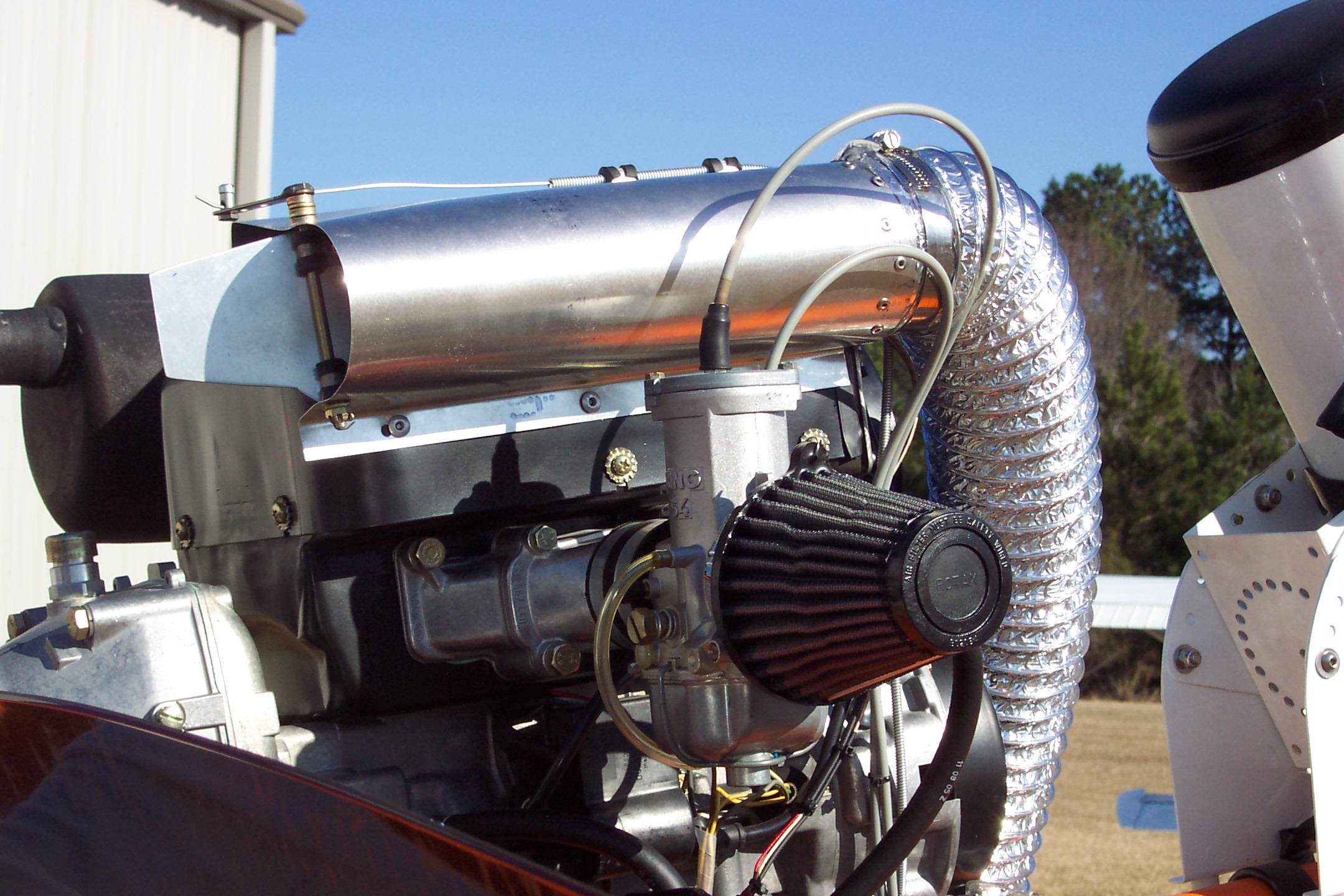

So my Rotax 447 Bing 54 carb Firestar has been at another airport for 2 days now... the reason...
When I apply full power and take off about 30 seconds into the climb I loose engine power. I can run at partial throttle and get back and land, but the full throttle will kill it.
I have a couple theories...
One is a bad/wrong size main jet...
but I took it apart and verified it was clean and the right size (it's a 165) and today it was an internationally standard day temp wise (65F) at sea level.
My other thought is maybe the carb is not vertical and tilted too far back during the climb and therefore the bowl level is tilted and uncovering the jet?
I'll attach a picture of the carb...
Any other thoughts on what it may be...
Ground run is good, I adjusted the clip to #2 from top and re tuned the carb on the ground.

I think I recall you talking about that Mike...
Even though I use a normal gas can, I now ALWAYS put my fuel through a Mr. Funnel before it goes in the tank... I think your story inspired me to go get one.
but I don't think the builder of my plane did that and I actually didn't the first couple times I fueled it, I used a regular funnel, until I read your story.
I'm most definatently going to clean and inspect the entire fuel sytem...

When this exact same thing happened to me it was a split in the fuel pump diaphram. My airplane had the same symptoms.
Won't hurt to pull it apart and take a look.
This was why I installed a low pressure electric pump and just removed the stock pump. I put in a more reliable one.

My similar story was that my electric backup (Facet) pump (plumbed in series) developed a faulty check valve that restricted flow just enough so that I'd only notice it at full-throttle. Replacing it with a new one fixed the problem.
-- Robert
