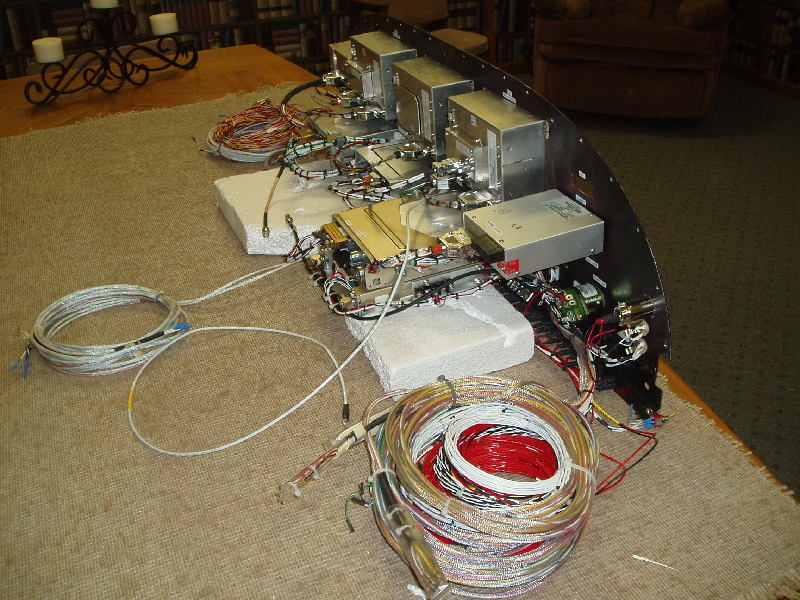

armywrights(at)adelphia.n Guest
Posted: Thu Jun 15, 2006 8:11 pm Post subject: Panel Design was Digiflight IIVSVG |
Could you or others please post some pictures of the backs of your panels so
I can start getting a mental image of possibilities?
Rob

Tim(at)MyRV10.com Guest
Posted: Fri Jun 16, 2006 3:36 am Post subject: Panel Design was Digiflight IIVSVG |
Dick, that is a beautiful panel and the layout looks to be great.
You'll like flying behind it. They did a good job for you.
Congrats on having the panel done, it's a real milestone.
Russ, it looks like you have yours home and are playing with it now,
I bet you're like a proud new father! I can't wait to see it
at OSH this year!
Rob (and others), you're right to want to worry a bit about the
back of the panel. I assume you really don't care about the
backside of the panel, as much as you mean the subpanels and
inside upper firewall. There is a lot of stuff that goes there,
and it gets hard to find convenient space.
My best advice is to try to use as much of the space as wisely
as you can, and then you'll find room for everything else.
First look at the large items, like the Lightspeed Ignition
if you have one, and the WSI receiver or XM receiver if you
have one. I put those on the inside upper firewall. In the
case of the lightspeed, I put it on the opposite side from
my radio stack to give a little extra margin in case there
was some electrical noise coming from it (there is not).
The WSI is mounted next to that, behind the radio stack.
All of my fuse boxes are on the subpanel on the front side.
Just put them wherever convenient, but OVERESTIMATE the amount
of spots you need....like if you think you need 8 on the avionics
bus, then do 12. You'll find that even with good planning during
the panel install, you'll probably want one or two more
than you thought. I used breakers for most major things, and
items that I'd want pullable for safety reasons (trim, AP, flaps)
I used fuses for things that I could just ditch easily by using
the E-Bus. (Weather, certain lights, ANR power, other stuff like
that.
Sensors like MAP sensor converter, and your Encoder if you have
one, aren't really very large, so they're easy to find space for.
There's actually quite a bit of space behind the panel, if
you're creative. I cut a couple of larger holes in the
subpanel that you'll see on my site. They weren't necessary, but
the largest one is kind of handy for reaching or looking through
to access upper firewall items. The only things forward of
my subpanel that aren't on the firewall are my e-bus schottky
diode, my stall buzzer, and my avionics fan. Most other things
are aft of the subpanel or on the aft side. So I could squeeze a
bit more on there if I wanted....but it gets a little harder.
So I wouldn't stress too much, as long as you plan for the large
items....and think wire runs all the time. Like when going from
my GRT to my engine for EGT/CHT probes, I have a strategically
placed subpanel hole and then one through the firewall. It makes
it a nice straight run. Laying out the panel is the hard part,
but it isn't as hard to come up with panel-forward placements.
Again guys, thanks for sharing the photos. Those are great.
