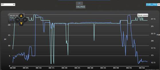

You could download your engine data from your EFIS, and look at both
fuel pressure and fuel flow simultaneously. I don't think there is an
issue with your fuel pressure sensor, but it would be good to see what
was happening on fuel flow at the same time pressure was dropping. The
mechanical pump is supposed to be able to handle up to -2 psi input, i.e
overcoming an uphill flow on the input side.
There is one other possibility. You could have a leak between the
electric pump and the mechanical pump. If that is the case, the
mechanical pump sucks air through the leak, which reduces the pressure
to the engine, while the electric pump will over come this.
Rule out the chance of an air leak between boost pump and mechanical
before assuming that mechanical pump is bad.

Here’s the Fuel Flow and Fuel Pressure overlaid. The dips are consistent when I turned off the electric fuel pump. An interesting anomaly is that the fuel pressure is higher during taxi with the boost pump off.
Finding a fuel leak is pretty straight forward, especially with the aid of the blue dye. How do you find a connection that doesn’t leak fuel, but does allow air?
bob

On the ground, throttle and mixture full aft, idle cutoff; turn on
electric pump with tunnel open and cowling off. After pressure comes up,
look for leaks. Anything that lets in air under suction will leak under
pressure. Ideally a couple observers, one in reach of the switch to kill
pressure as soon as leak is spotted.
pump off.
bob
