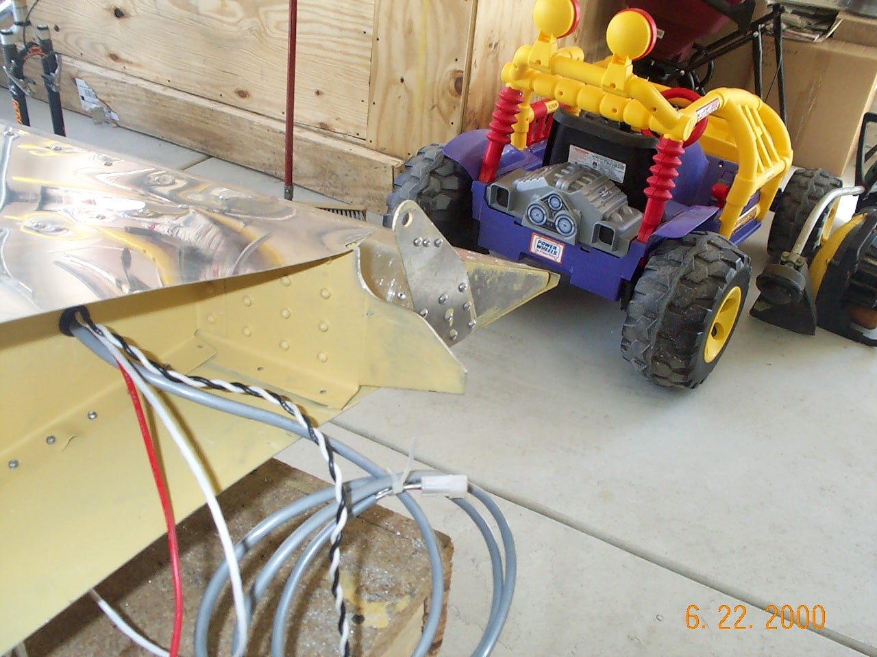

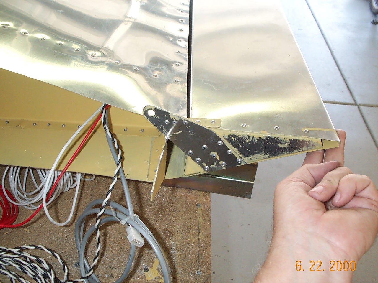

I am trying to get some information on the location of the aleron horn. I purchased a "90%" complete kit. And the aleron horn contacts splice plate just past the rear zee. Is this the correct location. Also any pics of the cut outs for the ib/ob wing sections would be appreciated.
Larry,
I think you are talking about 6-V-7-7. There is a note on the plans that state to "trim then to clear aileron control horn" so that you get the proper travel on the aileron. I've attached 2 photos where you can see that I've removed some metal to allow the spec'ed aileron throw.
Jerry Latimer
