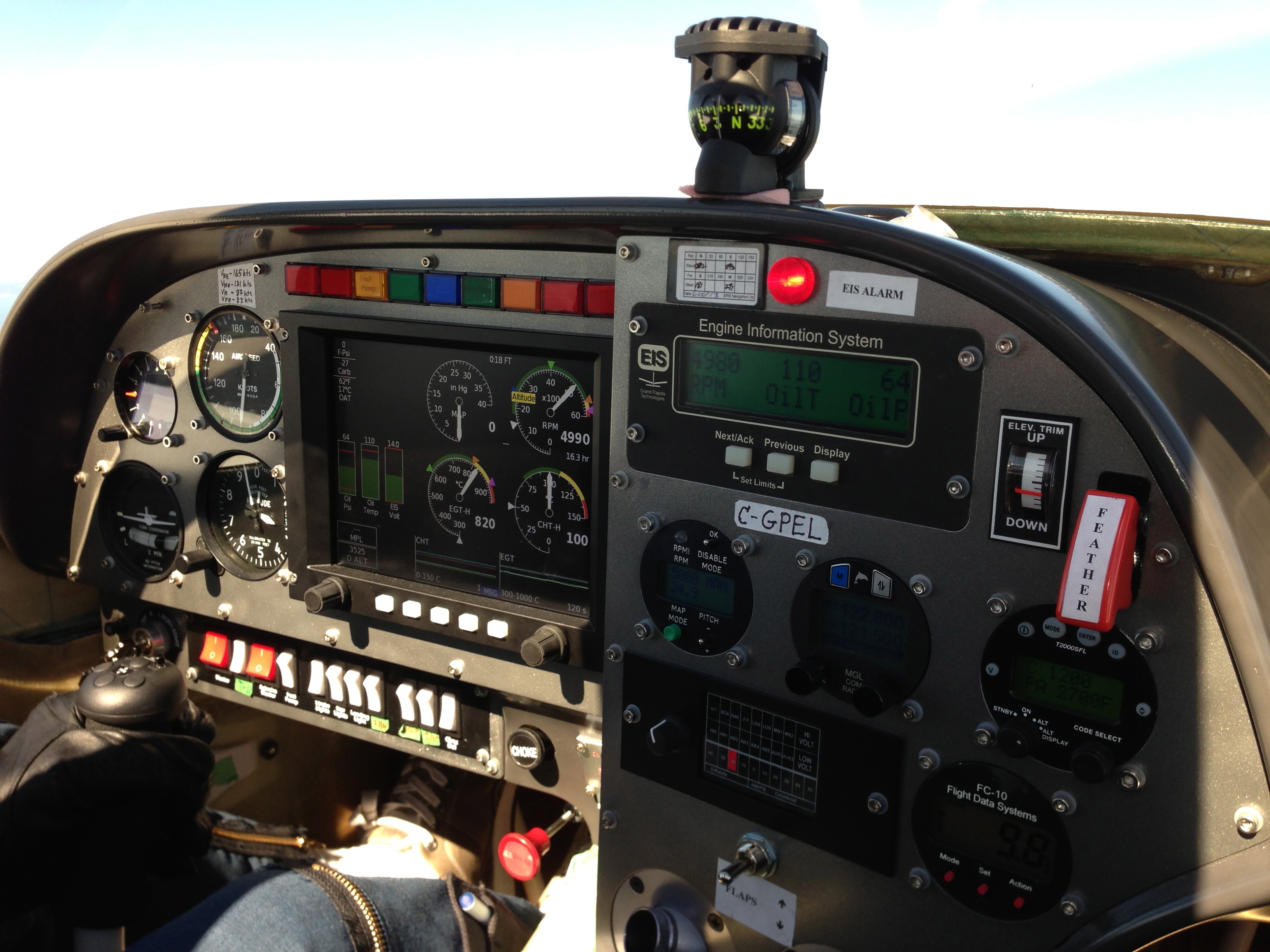

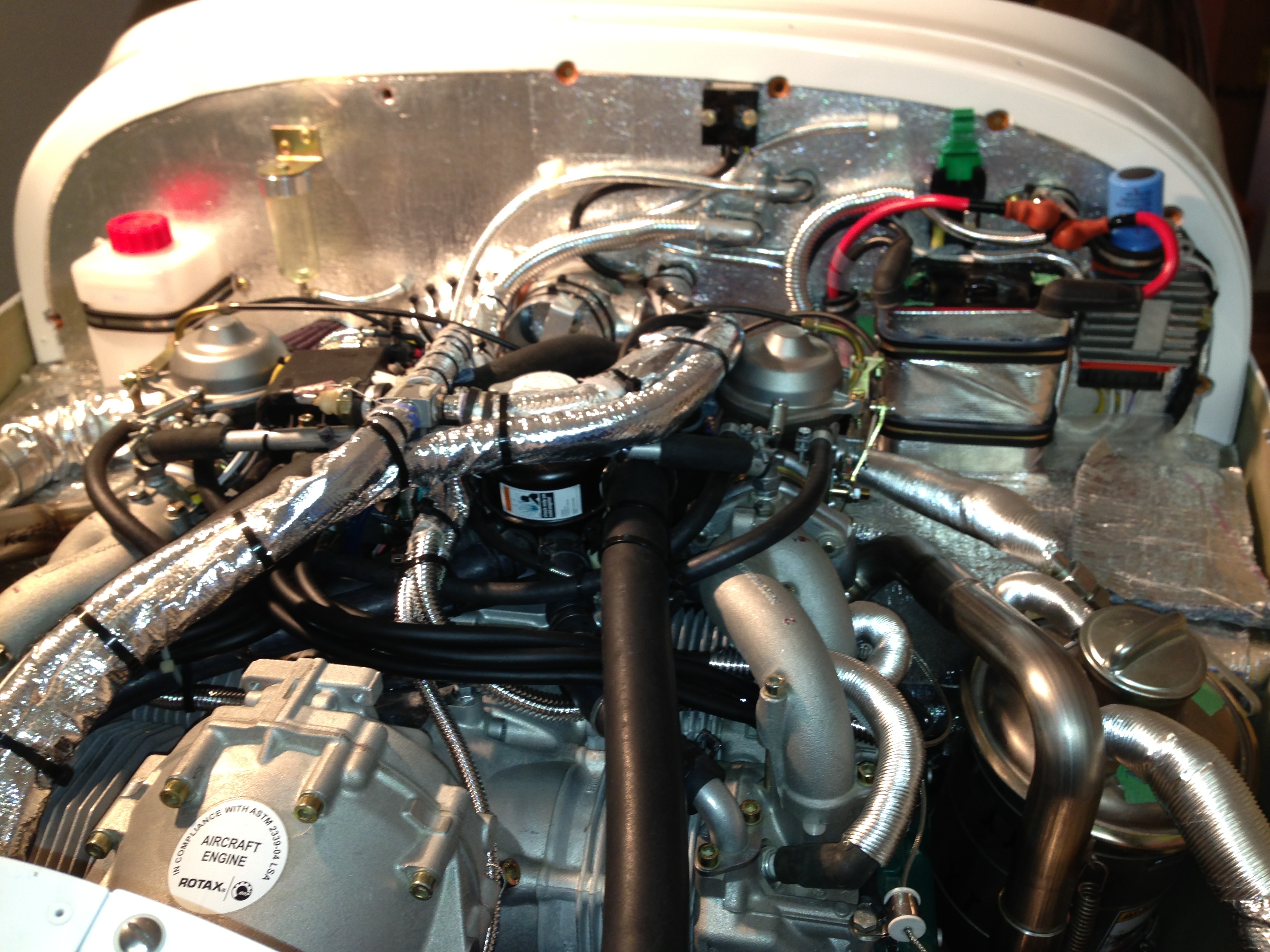

I have the same combination: Classic MK1 installation and standard starter
on 912S. Lithium Iron pulls through no problem. I exchanged for the new E
Module and new Flywheel. Absolutely no kickback on starting 9even with
brand new engine), I shut down after waiting a few seconds on a single E
Module and the starter pulls through no problem. I have a GRT sport based
glass panel, MGL radio and Microair XPRD, the entire panel draws 2.5 amps.
I had the panel on for 2+ hours and the battery was still good for a
start. The largest available 16 cell Lithium battery has 9 AH which is
smaller than the Odyssee but because of very low draw no problem. The
912ULS needs no electric fuel pump to run and I isolated the entire
electric panel with a 35 amp circuit braker in case of fire.
