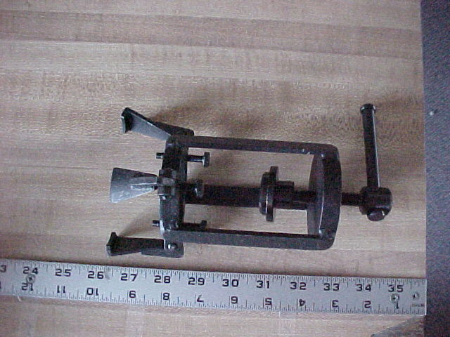

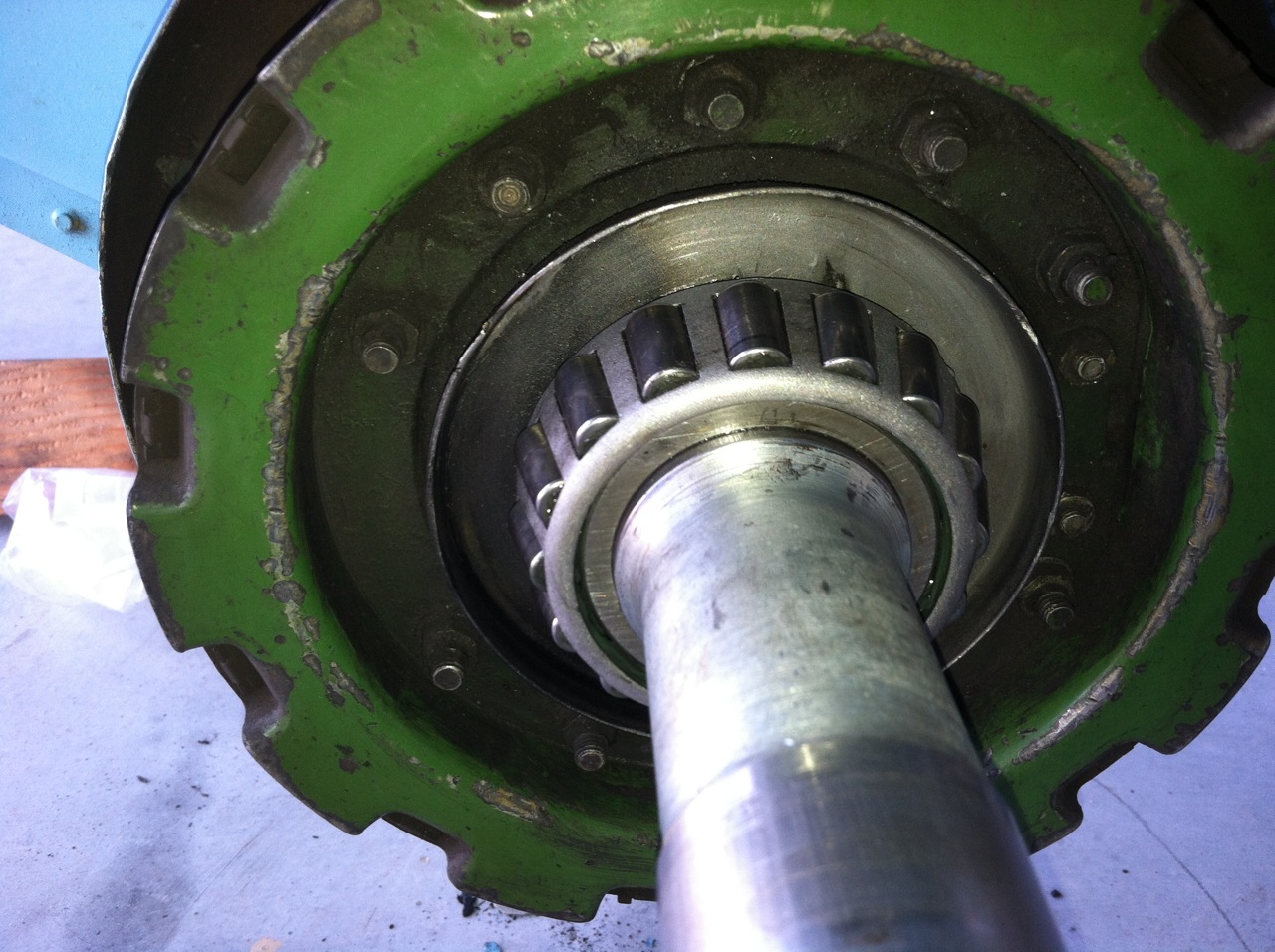

I've attached 2 pictures below. My inner wheel bearing and a picture of a CJ bearing puller Doug sent me.
Has anyone had success removing an inner bearing locked on the axle with out cutting or torching. I've tried some gentle prying with large screwdrivers. It looks to me like the picture of the bearing puller will only pull off the outer bearing by pulling the wheel first, but if it does work on the inner bearing I'm all ears. Just seems like it lacks length on the tabs to get a good grab on the meat of the bearing. perhaps it's meant to pull the bearing (breaking it) in sections?
I'd like to hear what others have done in this situation.

PostPosted: Fri Aug 23, 2013 8:36 am    Post subject: CJ wheel bearing removal Reply with quote
Hi Keith;
I tend to call that the outboard bearing. In any case it is the one in your
photo. The bearing puller in the photo is for that bearing but it is a two
part puller and Doug has not shown the other half.
The other part is a cone that ties the rollers, cage & race together as one
unit.
I will try to get a photo for you.

jackpot
Joined: 13 Jul 2010
Posts: 65
Location: Las Vegas, Nevada
PostPosted: Fri Aug 23, 2013 3:30 pm    Post subject: CJ wheel bearing removal Reply with quote
Just a thought. I know they are very difficult to remove sometimes. Here is an idea. How about packing the inside of the hollow axel with dry ice. Use a wooden dowel to pack it in the axel. It might shrink the axel just enough to make the bearing removable. Won't take much shrinkage. As I said just a thought. Gary. N22YK.

Hi Keith;
I tend to call that the outboard bearing. In any case it is the one in your photo. The bearing puller in the photo is for that bearing but it is a two part puller and Doug has not shown the other half.
The other part is a cone that ties the rollers, cage & race together as one unit.
Walt

PostPosted: Fri Aug 23, 2013 4:29 pm    Post subject: CJ wheel bearing removal Reply with quote
This spray may work to freeze the shaft while penetrating:

PostPosted: Sat Aug 24, 2013 8:40 am    Post subject: Re: CJ wheel bearing removal Reply with quote
Walt,
I found a pic of the piece you are talking about and think I can see how this would work!
Attached below:

PostPosted: Mon Sep 16, 2013 6:48 pm    Post subject: Re: CJ wheel bearing removal Reply with quote
The bearing removal tool supplied by Doug pulled the bearing off with ease. Forget the pry bars, screwdrivers, dry ice, etc. Best 95 bucks I've spent.
