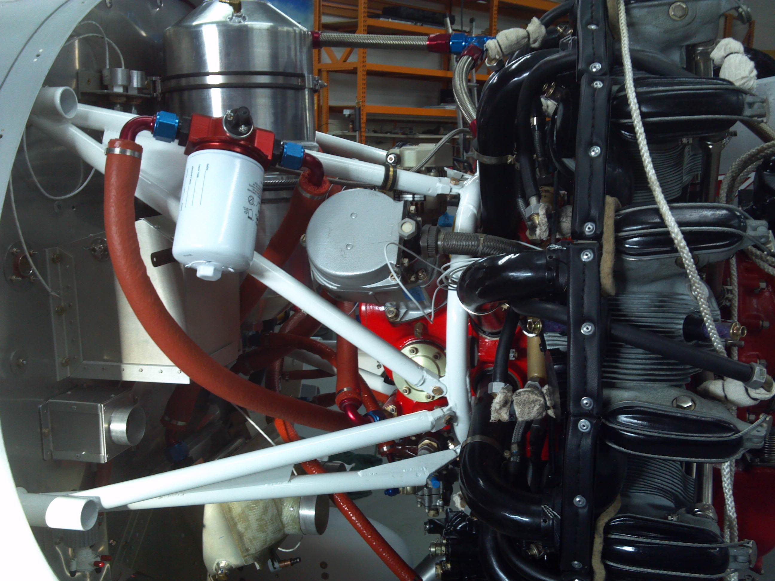

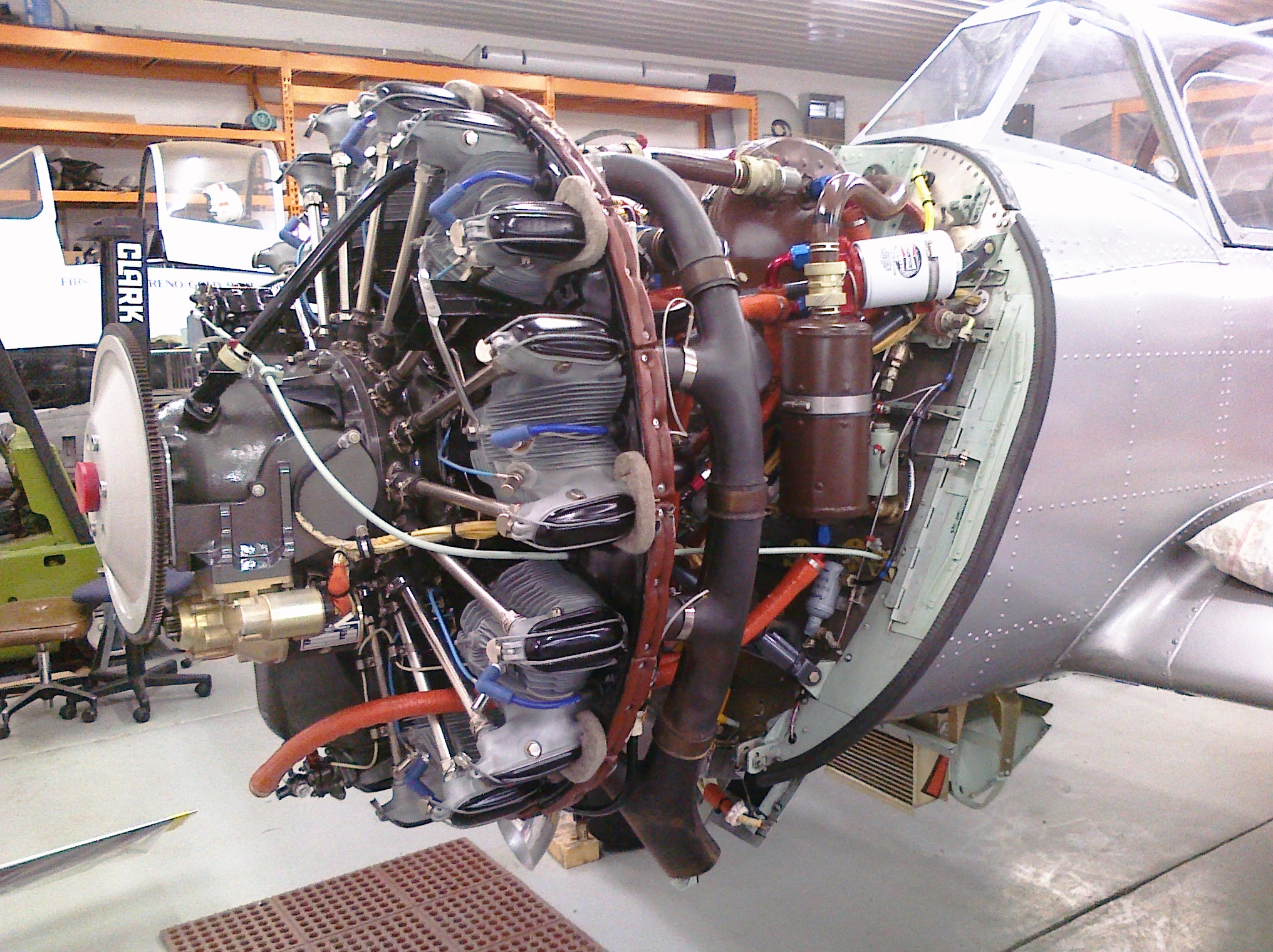

This shows filter location on Yak mounted under the oil vent tube connected to the engine mount . This is a Hamburger . You can mount is somewhere else. One is on the YakTW the other is on a Radial Rocket.
