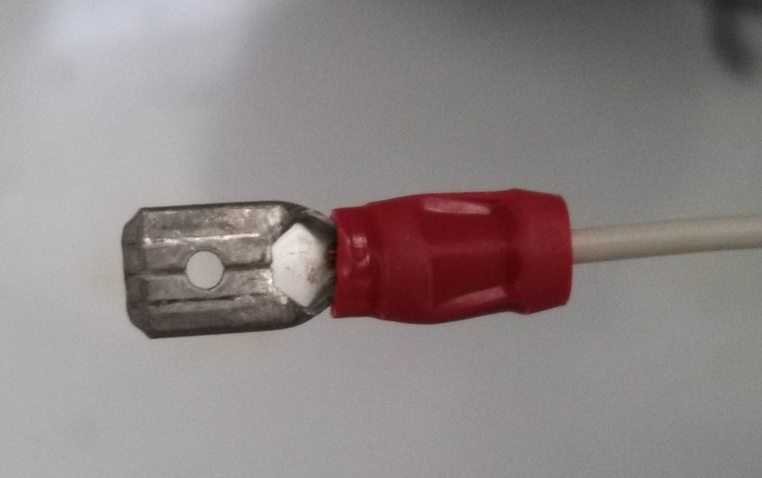

I'm hooking up the the CHT/EGT probes to my Grand Rapids EIS. I had a couple bad crimps on the male spade connectors but I didn't have enough spares. GR sent me some extras but they changed to a different style and those don't work in my AMP 47386-R crimping tool.
I've poked around on Mouser, but all I can find are ring and butt splice. No luck on tabs.
Any suggestions on a PN?

Probes do seem to have varying connectors. Those for EI probes have a
bit of a bump in the middle but both male and female are fast-on fully
insulated.
On Dynon the insulation is rounder, and the male spades do not have
insulation over the spade, just the crimp area. I have had some luck
matching up what I needed for extras at either Radio Shack or Home
Depot, just being careful to only select ones with translucent nylon
insulation, not opaque vinyl.
Haven't run into ones that don't use same crimp as any other ring or
fast-on terminal. Seems odd that they would supply a connector that
doesn't use a standard crimp.
