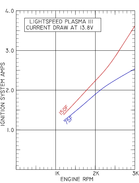

It took awhile to find the plot . . . but here's a set
of curves for current draw taken in the laboratory on
a number of Plasma III ignition systems.
[img]cid:7.1.0.9.0.20130905103652.020fab50(at)aeroelectric.com.0[/img]

I have dual LSE Plasma IIIs. Here are the current draw numbers Klaus shared recently for Box version "B". Your mileage may vary depending upon box vintage...
Box on, engine off: ~0.2A
Engine at idle power: ~0.8-0.9A
Engine at cruise power: ~2A
Jay

As Jay uses the singular "Box Version B". I assume the current draw would be double for dual LSE III's . Correct?

2.0A at 'cruise' is consistent with the data taken assuming that you cruise at 2200 rpm and the electronics package is in a 75F ambient. It also assumes a 13.8v bus. Since these ignition systems are fitted with wide range switchmode power supplies, they will consume constant power for varying input voltages. So if you're operating in a battery-only endurance mode, the current draw at end of battery life (10.5v) would be on the order of 2.6A at 2200 rpm.
John
Yes . . . that is PER system . . .
