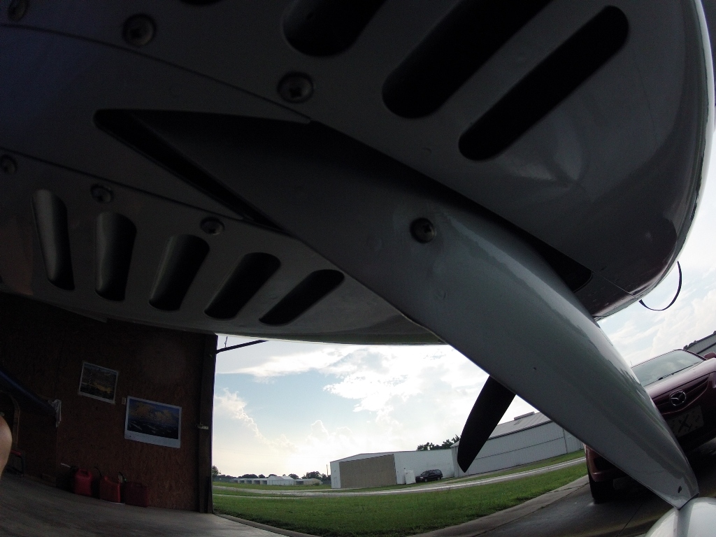

I have noticed some apparent heat damage around my nose gear strut fairing right around the area where it exits the cowling to the first screw that attaches it to the gear leg. Seems like the fiberglass has gotten a little warm and changed shape with some of the weave showing through the paint. Have others seen this or know what can be done to prevent it??

Posting some photos would be helpful to assist in answering your question. Are you sure that it is heat, or could it be that the fairing is in a bind when it is installed and it's trying to twist? I haven't noticed anything on mine indicating heat was an issue. Do you have any reflective heat mat on the lower cowling?

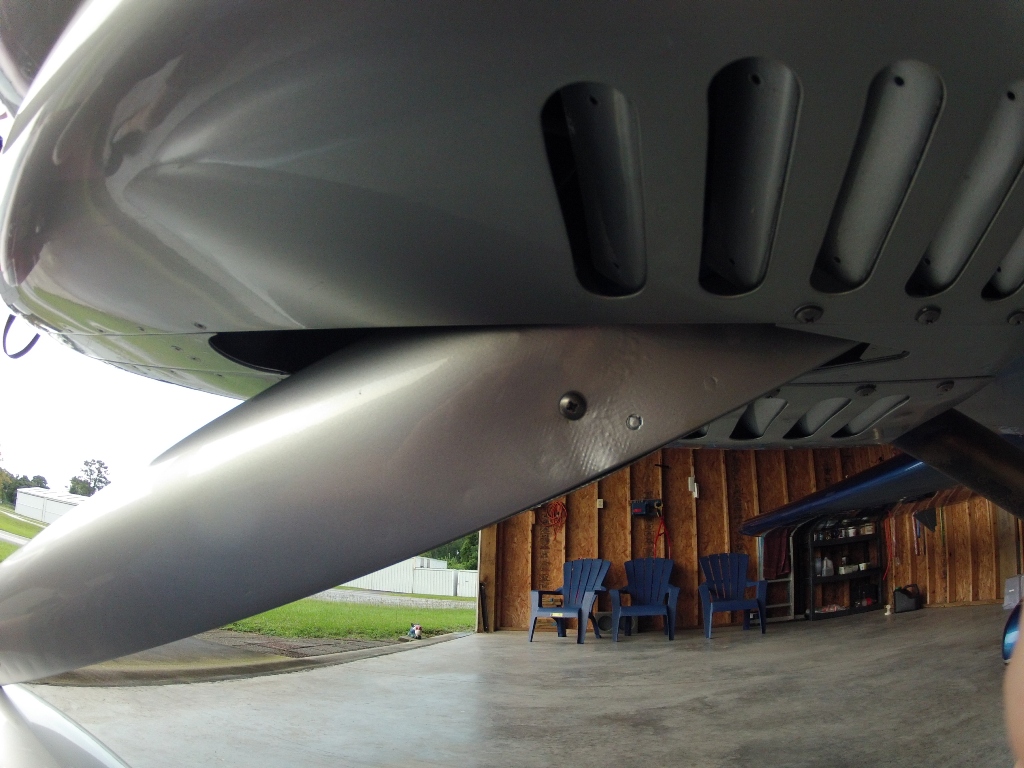

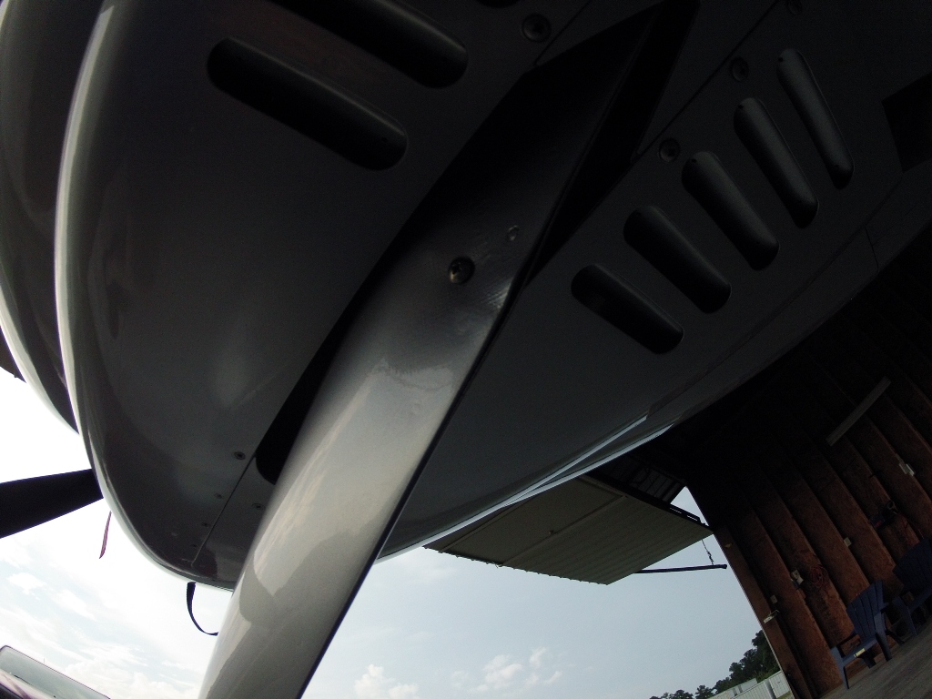

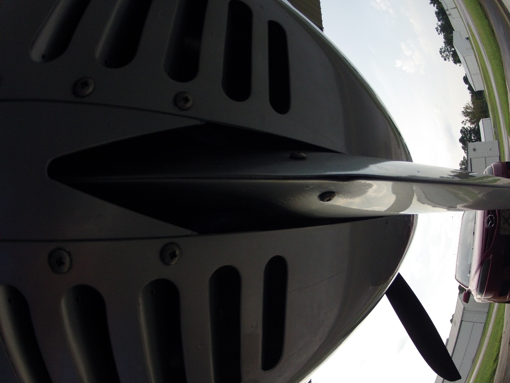

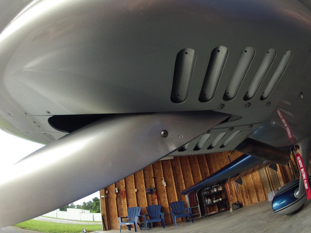

PostPosted: Mon Sep 02, 2013 3:12 pm    Post subject: Nose gear leg fairing Reply with quote
Here are the pictures. I am wondering if hot air is coming in from the top
and kind of dead heading at the screw attach triangles on the leg - or the
whole leg has a lot of heat too.

It almost looks like the nose gear leg brackets are distorting the fairing. Almost like the front of the fairing is resting on the gear leg to deeply. My 4
Attachment screws are much closer to the hinge edge of The fairing than yours. I don't have any photos, but I will take a look this week and see if that's the case.

It sure looks like heat concentrating at the screw -- checked for exhaust
leaks, heat muffler leaks? Have you also checked for fuel overflow (hot
start flooding, etc.)? There would probably be fuel discoloring if that
were the case.

While there is typically a negative pressure gradient that sets up cowl
exhaust air to go down the nose gear fairing to the nose wheel pant, I
suspect this is not heat damage as much as the fastener working the fairing.
Looking at the photo, you have the same situation I had on my plane - the
fairing needs to have a backing on it so that you don't deform it when you
tighten the mounting screw.
As a general rule, anyplace you have thin fiberglass held to something like
a small steel plate with a fastener you must add reinforcement. On the nose
gear leg fairings I added 4-6 bids of glass reinforcement on the inside
where the fairing rubs on the gear leg bracket. This adds a lot of strength
to the area where the screw goes through as well as the needed spacer so the
mounting screw does not deform the fairing. The same practice goes for the
wheel pants, some areas like the outboard bolt hole get much thicker layers
of glass than others. On the front gear pant don't forget to add some glass
reinforcement on the inside about 6" up from the tire cutout. I had the
wheel pant split in this area, as have others. On the front shoulder belt
to cabin top mounting screws I added (Cool bids of glass on inside, 6"x10" or
so in size centered on the screw hole. I did not consider the thickness of
the cabin top glass adequate after I got done countersinking for the
mounting screw.

I had to build up on the inside of mine 1/8" at all four locations. Weekend job for you coming up.

Thanks to all on the replies. I guess my case is a bit isolated. I do
remember adding glass to the lower attach points but I don't remember if I
did to the uppers - it is drawn in a bit by the screw but the gopro camera
lens might exaggerate it a little. Easy enough to go ahead and pull it off
and add some glass as you say below, and check for any exhaust leaks. I did
not see any fuel residue around it.
