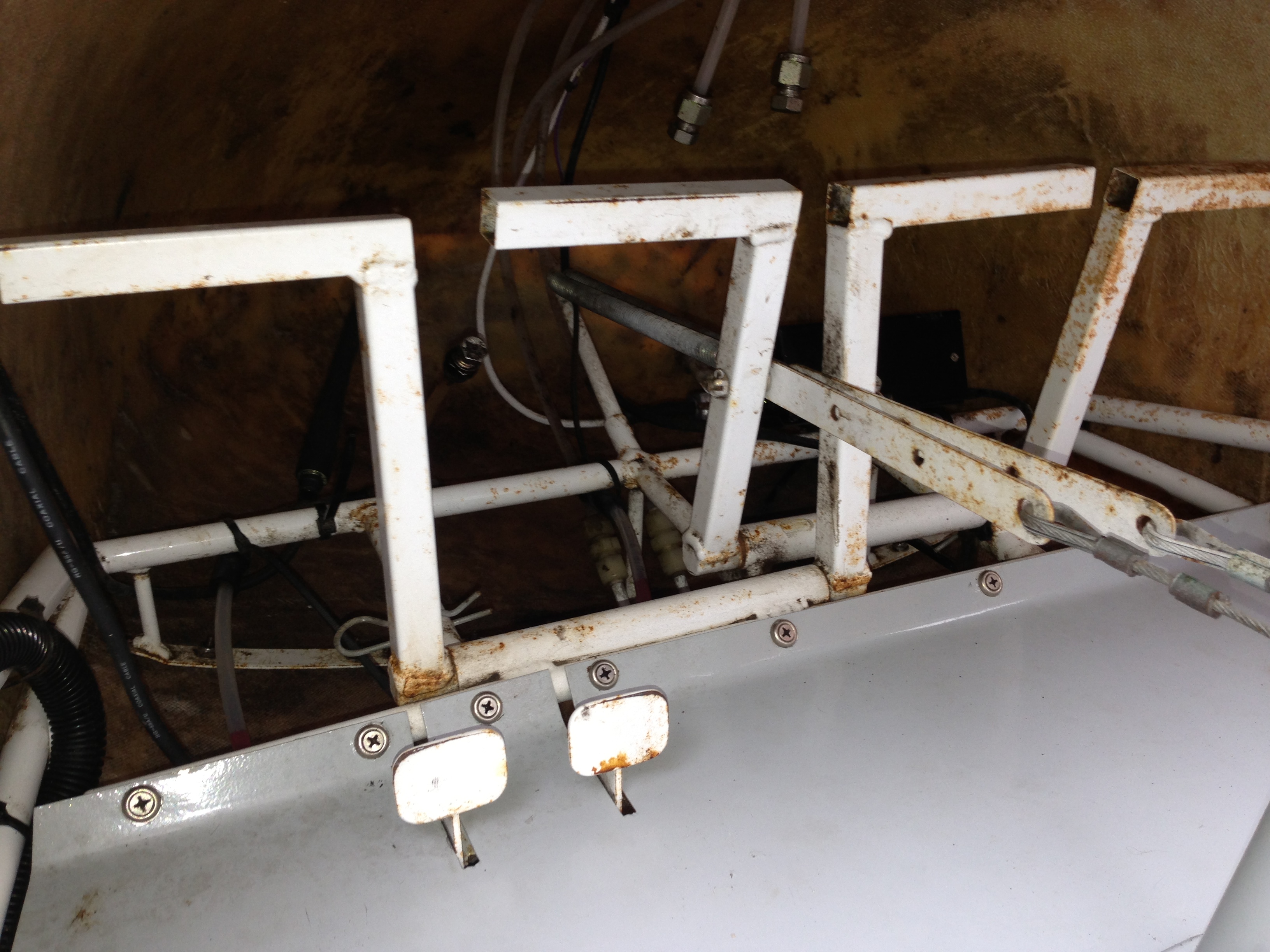

Hi All,
I have some places on the frame where some rust stain is showing through the paint. The paint in most areas isn't chipping off and this looks almost like a stain on the paint. See attached picture. I'm curious about the best way to deal with this. I'd obviously like to avoid any radical stripping until I'm ready to replace the fabric which is still in good shape.
Locally I've been told everything from a light sanding and repaint with a rust resistant paint to treating it with a 'rust converter' and then repaint with an epoxy based paint. If this has been discussed before I can do a more through search of the list.
Allan

PostPosted: Thu Aug 22, 2013 8:07 am    Post subject: Light Frame Rust Reply with quote
Allen,
From what I understand, the proper way to deal with "light" rust corrosion is with a quality
rust converter. There are many brands available.
See:
http://www.corrosion-doctors.org/MetalCoatings/rust-converter.htm
I have seen A&P's use them at annual inspections on rust spots exactly like yours. The
stuff works extremely well.
Mike Welch

PostPosted: Fri Aug 23, 2013 4:10 am    Post subject: Re: Light Frame Rust Reply with quote
CURIOUS - Is this rust underneath EPOXY primer?

PostPosted: Fri Aug 23, 2013 7:55 am    Post subject: Re: Light Frame Rust Reply with quote
My understanding is it was powder coated then primed and painted but I don't know what kind of paint. (Not my build). I'm trying to find out though.

PostPosted: Fri Aug 23, 2013 4:35 pm    Post subject: Light Frame Rust Reply with quote
If it was powder coated it is unlikely that it would be painted, too. Powder coating steel typically involves a phosphoric acid cleaning, the powder is applied by electrostatic deposition and then baked to fuse the powder into a continuous plastic coating. Therein lies the problem, once the coating is pierced in any way, or if the phosphoric acid dip is eliminated or too long a time passes between the dip and the coating operation corrosion is sealed under the coating and the staining shown in your pictures results.
Up to you as to how you repair it but AC 43-13 1b is a good place to start.

PostPosted: Sat Aug 24, 2013 1:25 pm    Post subject: Re: Light Frame Rust Reply with quote
I have seen a few spots of rusts also at the weld joints on my powder coated cage, I mean crap what do I do now. I was told the tubes were oil filled to prevent corrosion, at least that's what Donnie told me before I bought my kit... Donnie's gone now from Kolb.....
Rick Lewis

PostPosted: Sat Aug 24, 2013 1:53 pm    Post subject: Light Frame Rust Reply with quote
Rick Lewis
(VW Watercooled Engine)
If the rust has made it through to the powder coat from inside the tube,
you've got more serious issues than what paint to use. Smile
The acro guys treat the interior of the tubes with linseed oil, weld the
entire structure shut, & weld in an inflation valve & air gauge. If the
gauge drops to nothing, they know that the fuselage has cracked somewhere.
Charlie

PostPosted: Sun Aug 25, 2013 6:52 am    Post subject: Re: Light Frame Rust Reply with quote
After seeing a Firestar cage with the lower rear tubes rusted thru I decided to drill all the lower tubes in my Firefly and treat them with Corrosion X. When I inserted the aerosol tube in the 3/32 hole and pressurized the 2 lower rear tubes I could hear pressure escaping out the rear of the tube. The area that is flattened for the boom thru bolt is not sealed and I would think that any Kolb washed or exposed to rain would slowly take on water in the lower rear tubes.
