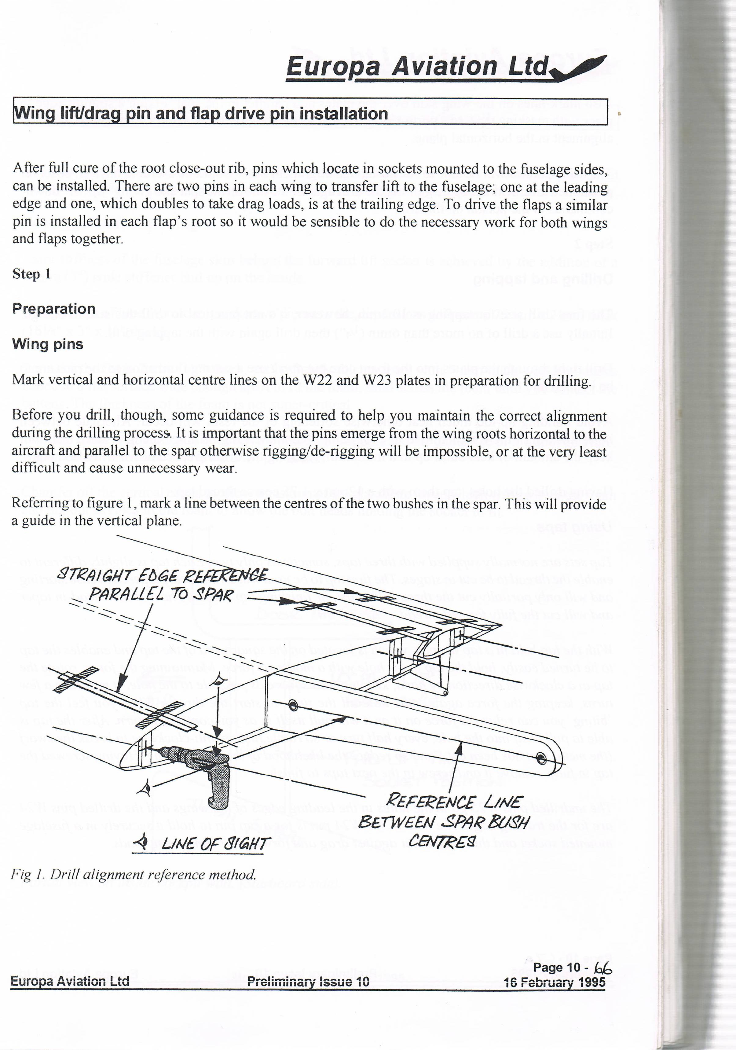

Hi all, so im building a classic and am just finishing off my wings. In the combined manual chapter 26 it says that the holes for the wing pins are already drilled and tapped (you XS people dont know what your missing out on!! ) but i need to drill and tap mine myself, so does anyone have the original instructions for measurements to position the pins? Many thanks

Do you mean the 2 lift/drag pins in the wing root? If so I can scan and send
the appropriate pages. However, prepare yourself for a shock! Check out
mandatory mod 74 on the Europa website. The rear pin needs to be changed
for a longer one with a big washer and nut on the back inside the wing.
There is a variation of the instructions for mod 74 which allows you to go
in through the rear close out.
Let me know if you need the pages and I will scan and send in the morning.
Pete

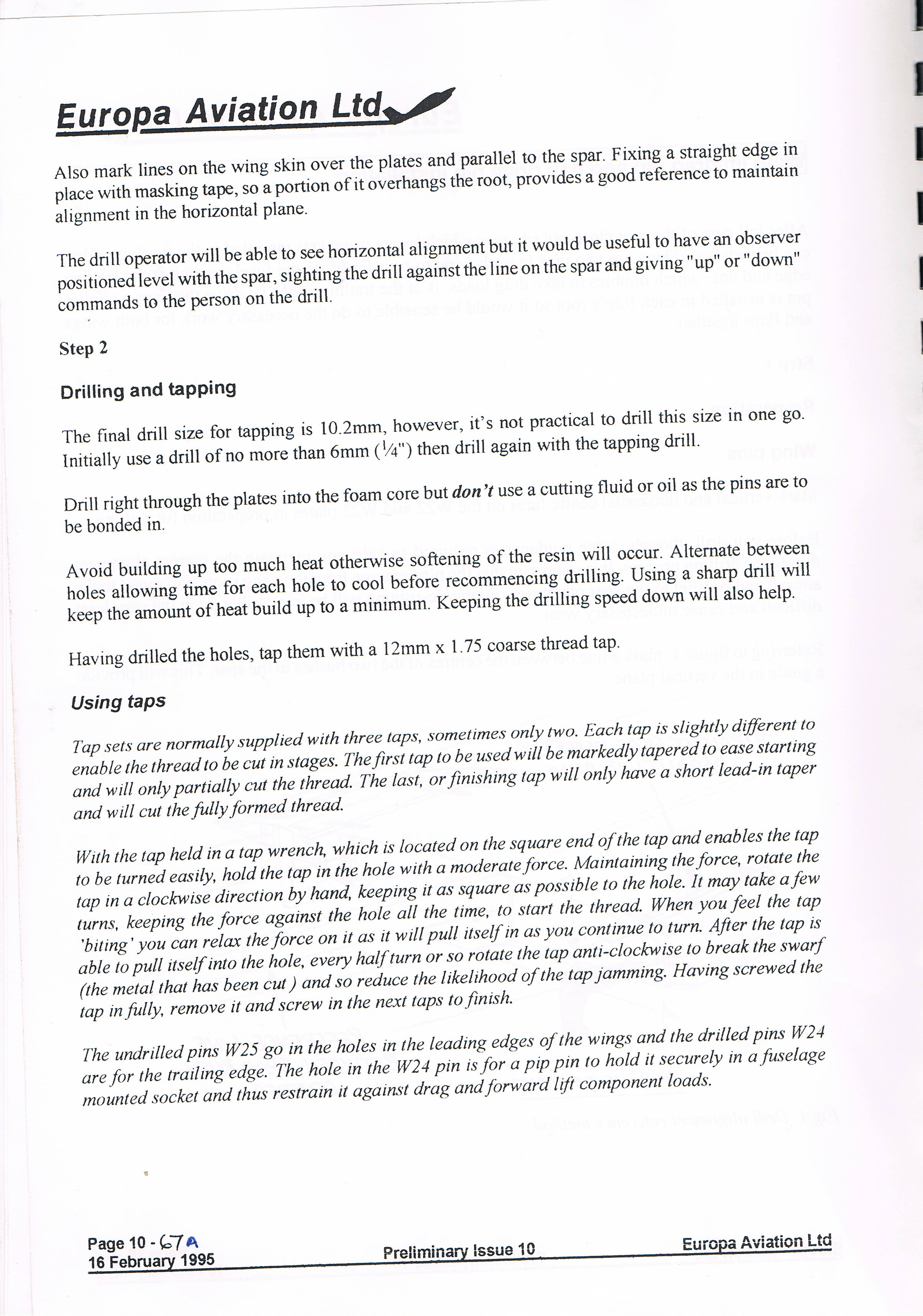

PostPosted: Sat Aug 17, 2013 2:04 pm    Post subject: Wing lift and drag pins Reply with quote
Here you go. The information you need is to be found in Chapter 10 - 67
of the original Fuselage manual - looks like it was overlooked when the
"Combined Build Manual" was compiled. I have scanned both pages for you
and also included the mandatory mod that you will need to incorporate in
your Classic Wing.
Nigel
On 17/08/2013 20:59, spcialeffects wrote:
Hi all, so im building a classic and am just finishing off my wings. In the combined manual chapter 26 it says that the holes for the wing pins are already drilled and tapped (you XS people dont know what your missing out on!! ) but i need to drill and tap mine myself, so does anyone have the original instructions? Many thanks

Thanks Nigel its that first page that I'm after. I couldn't remember who sent me the wing layup papers (using the uni cloth) before (thanks again). I am doing mod 74 but there is no way of incorporating this before having skinned the foam so I have to cut a hole in the skin to fit the mod. Fortunately it hasn't got any filler on it so this makes it a little easier.

One other question please. The instruction page above says to drill the flap pin in the middle of the plates but the combined manual gives an off centre position. Why is there a difference of position and which is best to use?

PostPosted: Sun Aug 18, 2013 9:23 am    Post subject: Wing lift and drag pins Reply with quote
Sorry, don't see to have a name for you! I would very
much advise putting the pin in the middle of the plates.
When William Mills plane broke up in. Mid air on a Max
weight VNe dive there were two things that failed and it
was never decided which was the primary factor, (although
I prefer the notion of the tail plane fixation having
failed). However one was that a front lift pin had been
drilled into the front edges of the 3 plates in the wing
root, reaching the edge of one and overlapping another,
which meant that it was taking considerable strains on a
metal to fibreglass joint which is not in the owner's long
term interests! That is not exactly a reason for being
central but a very good reason for not being anywhere near
the edge as I dare say that you cannot know precisely
where the deeper plates are situated.
Regards, David Joyce, G- XSDJ
