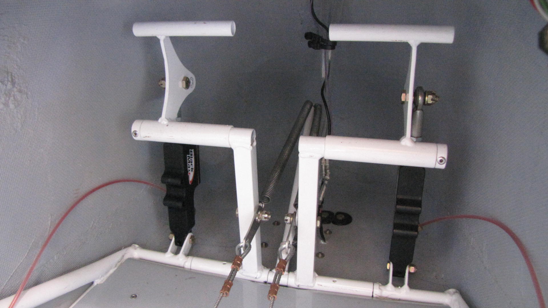

The picture of a new factory-built FireFly shows that the longitudinal axis of a rudder spring must bend whenever a rudder pedal is pushed. Would it be better if the spring on a pedal that is pressed is allowed to relax?

The rudder pedal springs on Kolbs do relax when that pedal is pushed. They are in tension and shorten when the corresponding pedal is depressed.

I made a small T bracket for the forward spring mount to eliminate this problem. Drilled and riveted to the 4130 cage tube so the bracket will not rotate. No binding or flexing of springs. Simple to make with 2 pieces of tubing and a triangular gusset.

I should get a 3/8" dia aluminum tube 8 and 3/4 inch long to hook the springs to so they're stretched 1 and 3/4 inches to get to the pedals in neutral since that is what the plans call for.

Doug, From the picture it looks like either A) the tube that fixes the end of the springs is too short, or B) the springs are too long. You need to have the springs in the relaxed length when that rudder pedal is fully depressed, not when the pedals are equal, i.e. rudder centered.
