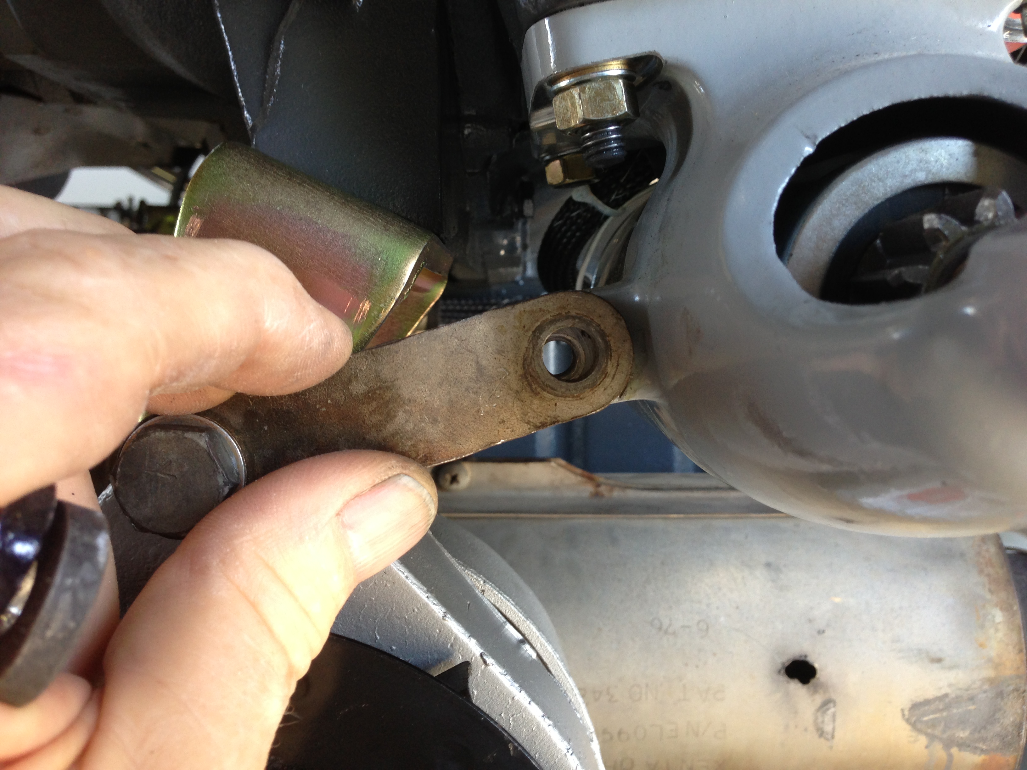

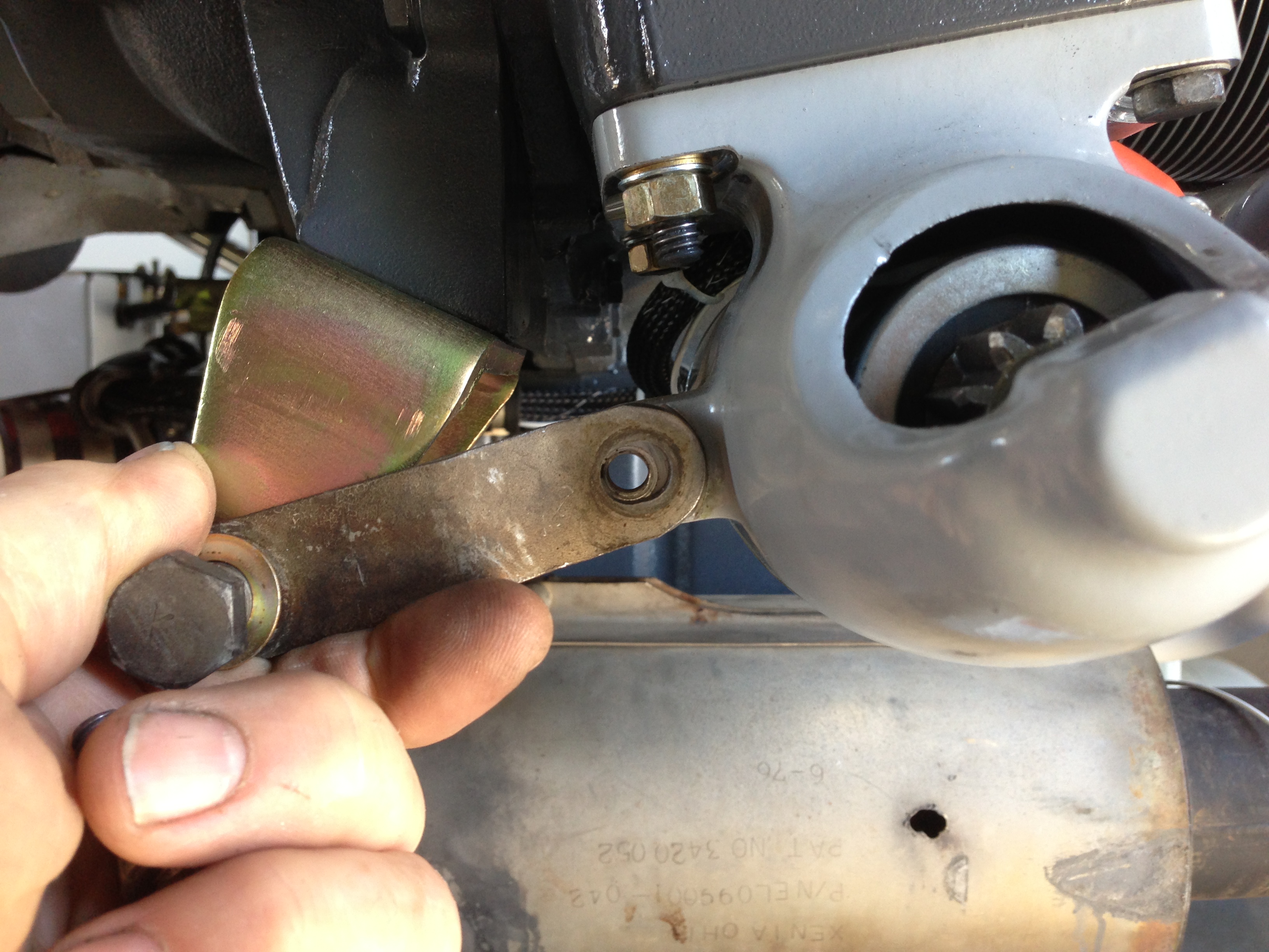

Is it me, or are others having trouble with the 149-12LS starter?
When these starters first came out, I called Les and told him he needed to adjust the hole by about .020 to make it fit better. This one is off every bit of .100 inches. Not only that, I had to grind off the top of the brace to the alternator because the relief was not deep enough.
