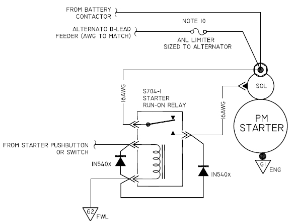

There is a problem to be solved when the panel
mounted starter control is used to energize the
starter's built in contactor. Unlike legacy
'starter solenoids' controlling starters with
Bendix drives, the modern pinion engagement
solenoids have a very high coil current demand
during the first few milliseconds of being
energized. See: http://tinyurl.com/op5cs2g
Failure to recognize this difference in
solenoid/contator performance caused a
kerfuffle over burned start switch contacts
on the ACS-510 key swicch (clone of legacy
Bendix/Gerdes). ACS now sells a diode with two
terminals applied.
[img]cid:.0[/img]
A critical need to install this diode across the
starter contactor engagement coil arose from the
alarming rate at which start contacts in the key
switch were destroyed by overstress when the legacy
starter/external contactor combo was replaced with
a light weight version with combination solenoid/
contactors. Many cars suffered similar failure modes
in their key-start switches.
SB92-01 from ACS originally place thier diode across
the switch contacts . . . wrong place. It was corrected
in a subsequent revision. See http://tinyurl.com/nva2xdy
B&C adopted the philosophy of jumpering the starter
solenoid coil right to the fat-wire terminal on
the starter . . . and controlling power to the
starter though a modern, starter contactor WITH
built in coil suppression diode. The external contactor's
inrush demands on the start switch are a small fraction
of that for direct control.
This philosophy posed a new problem when PM motor
starters began to show up on the airplane. PM motors
have a pronounced counter-emf during spin-down after
the power is removed. This would delay disengagement
of the pinion gear and was commonly called "starter
run on" . . . in fact it was better called "delayed
disengagement".
Starters with wound fields (B&C and some others)
do not suffer this indignity and function well with
the engagement solenoid jumpered directly to the
starter's fat-wire terminal.
In ANY case, the builder's design goals should
include providing a source of solenoid engagement
power that (1) is supplied through a low impedance
source (short and fatter than usual wires) and
(2) avoid running this power through the panel
mounted start switch.
If the starter is a PM version, the builder can
take advantage of the "I" terminal on many modern
starter cotactors and use it to SUPPLY current
to the engagement solenoid. This provides for
instant removal of coil power when the starter
switch is opened and prevents 'delayed disengagement'.
In this case, the builder would do well to have
diode coil suppression on BOTH the external contactor
coil AND the solenoid/contactor coil on the
starter.

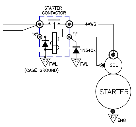

PostPosted: Fri Jul 05, 2013 11:25 am    Post subject: Master Switch/Contactor and Starter Questions Reply with quote
At 01:28 PM 7/5/2013, you wrote:
--> AeroElectric-List message posted by: Ed <decaclops(at)gmail.com>
So....on the SkyTec permanent magnet starter, the diode goes from the little terminal to where - ground on the starter case?
Same for ALL starters with the built in solenoid/contactor.
[img]cid:.0[/img]
.... or like this
[img]cid:.1[/img]
By the way, I only measure approximately .3 ohms from the small terminal to the starter case. I thought the coil would have more resistance than that. The starter comes from SkyTec with a jumper from small terminal to the fat wire terminal.
Yup, that resistance to ground is LOW . . . it gets higher
after the pinion gear extends but the initial current
draw is significant. That's why you use external contactors
or a buffer relay as shown above . . .
I've added diodes to Z22 . . . something I should
have done years ago. Thanks for reminding me.
 Filesize:  66.96 KB
 Viewed:  8819 Time(s)
 Filesize:  55.07 KB

Which starter contactor are we talking about?
One built onto a starter or an external contactor?
When you mentioned 0.3 ohms, the first image in
my head was for a contactor built onto a starter.
These DO present a very low terminal resistance in the
de-energized mode. There's mechanism inside that
demands a ~30A closure current and a more moderate,
~10A holding current. . .
Run of the mill external contactors
http://tinyurl.com/kqphmh
. . . have no such shift in demand and will require
~5A to close and hold the contacts. Further, the models
sold previously by us and now by B&C have built
in coil suppression diodes.

Speaking of diodes, is this overkill?
http://www.amazon.com/Amico-Molded-Plastic-Rectifier-Diodes/dp/B009IN1KB8/ref=sr_1_6?ie=UTF8&qid=1373088088&sr=8-6&keywords=diodes
I can get these, but the shipping is more than the diodes:
http://www.digikey.com/scripts/DKSearch/dksus.dll?Detail&itemSeq=133108363&uq=635086673453750862
I like the 1N5400 series devices which are stocked
by Radio Shack
http://tinyurl.com/pfwlz2v
and Jameco
http://tinyurl.com/qjefqzq
if you don't mind paying for 0.08 each in
packs of 30. They use first class parcel
for small orders . . . these would come to
your door for under $2.
The 1N5400 has reasonably robust leads and
package. Smaller diodes work too but these
are mechanically user friendly, easy to get
and the price is right.
Any P/N in the 1N540x series is okay from 0 to 9
Bob . . . [quote][b]
