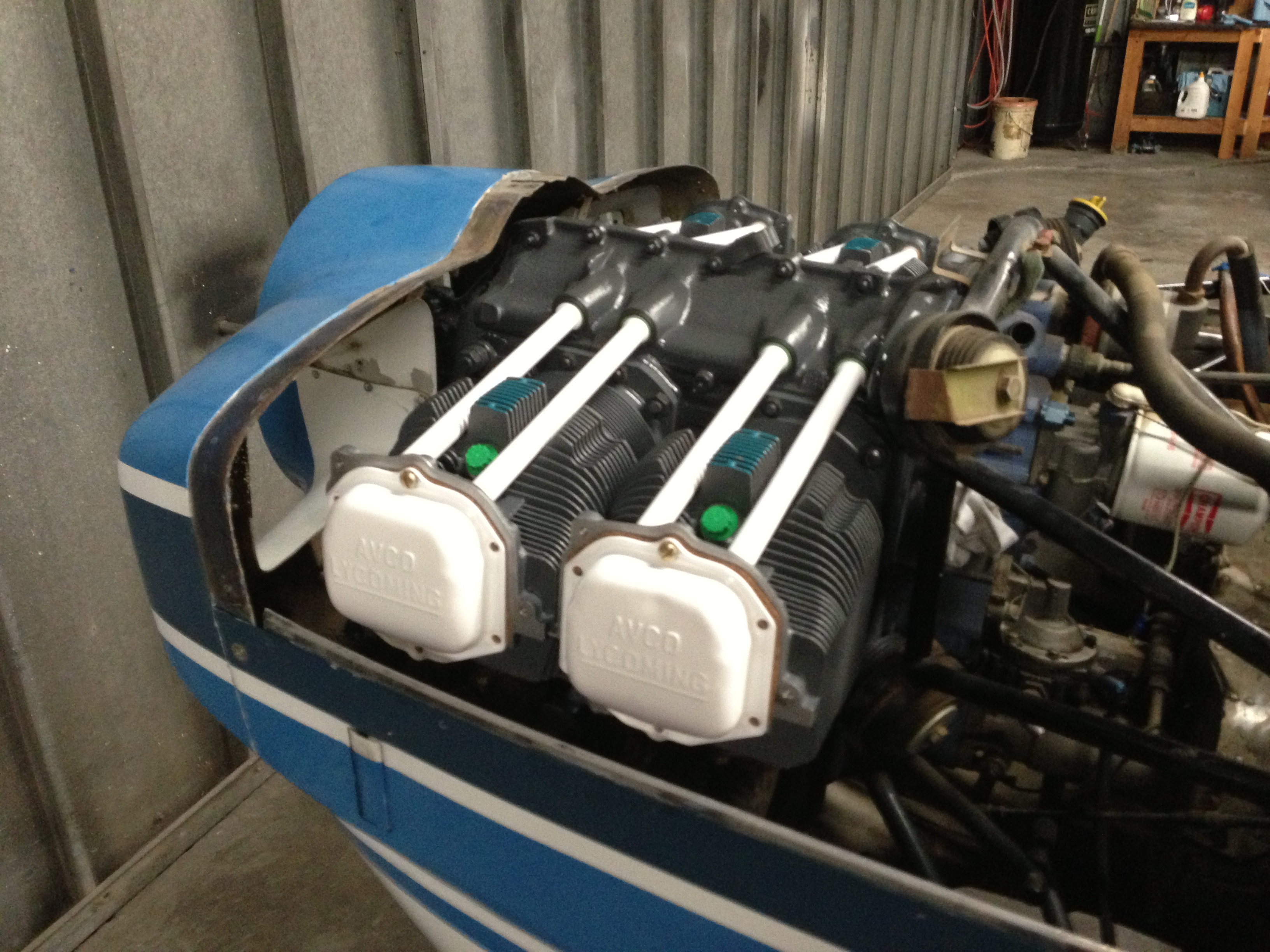

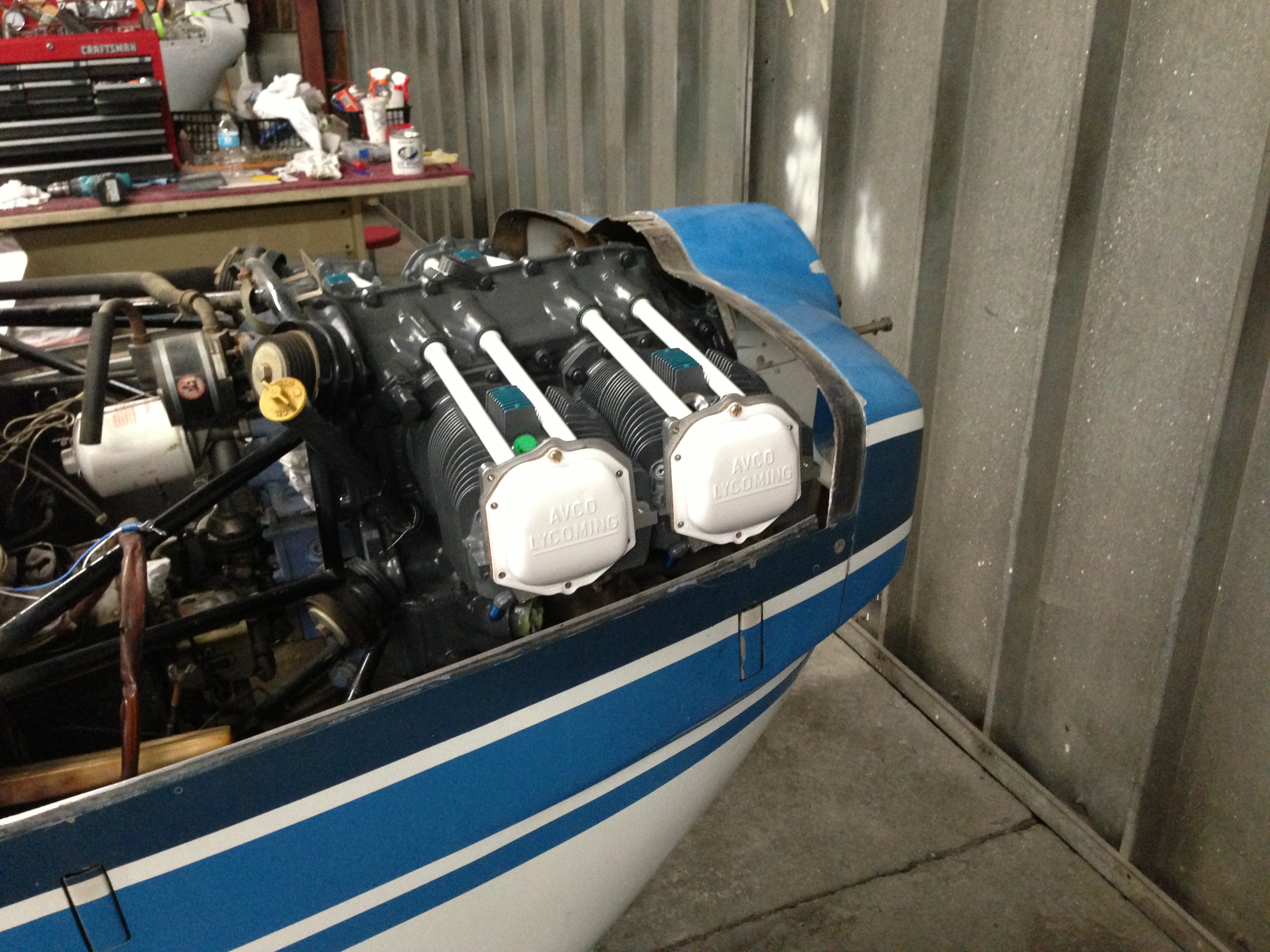

Who stole the baffles?  Also won't run well without being connected to the intake manifold.  Srsly, looks nice and clean.  While I was doing my O/H, Ken B had me strip, blast, alodine, and repaint with silver wheel paint, and it came out really nice.  It's stayed nice for 2 years so far too.   I'd think about doing those in white to match the valve covers and pushrod tubes.
