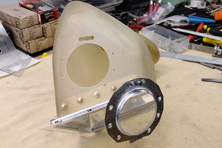

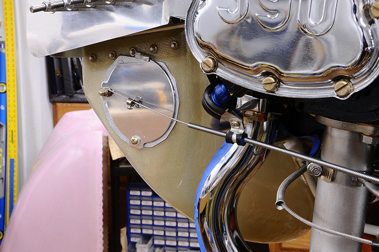

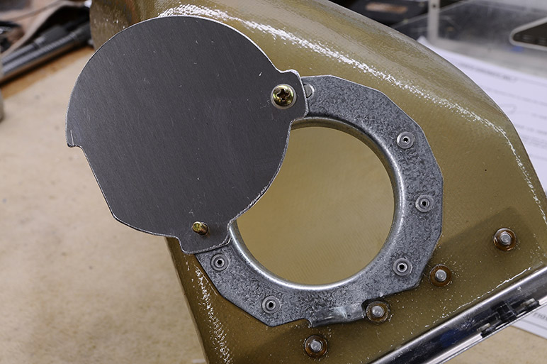

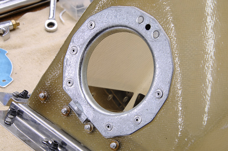

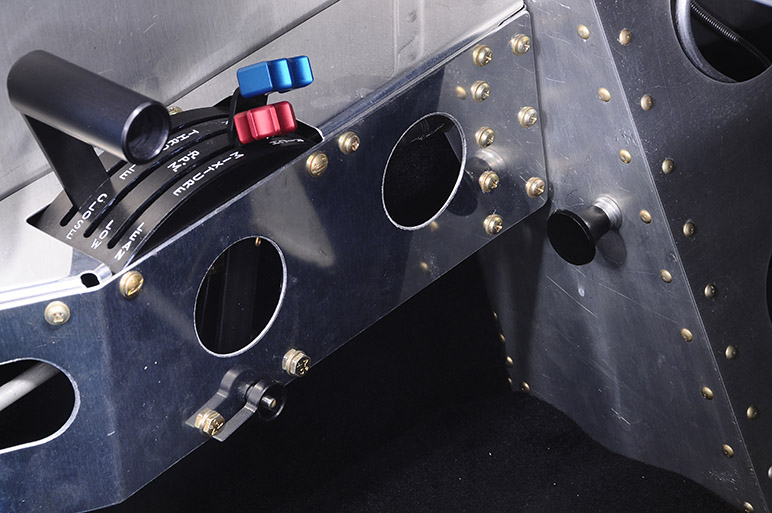

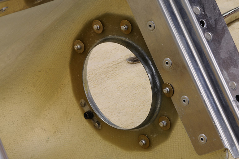

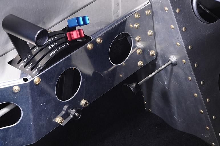

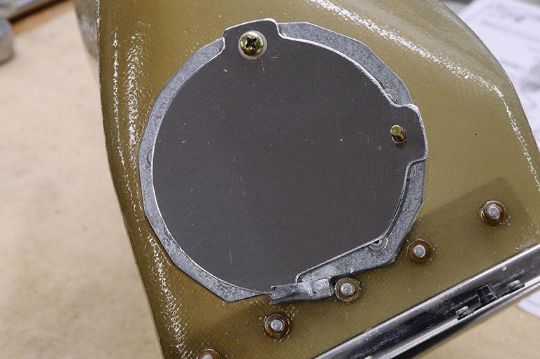

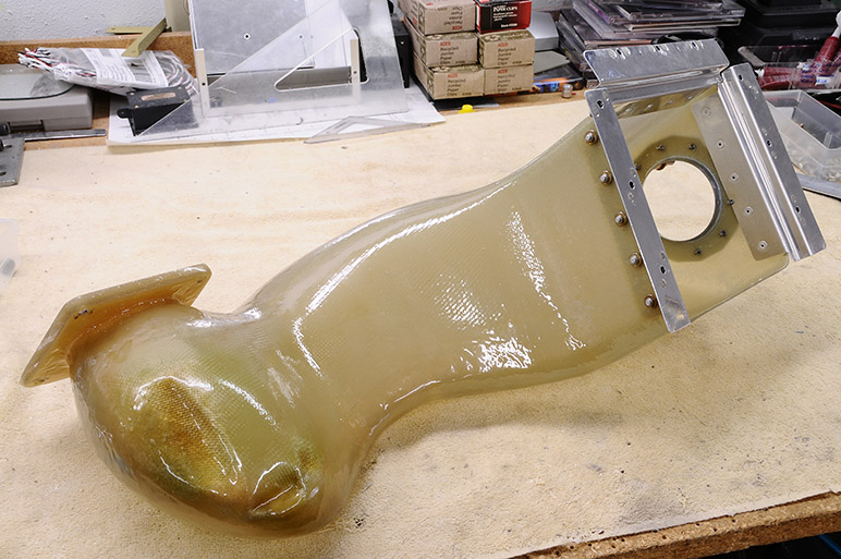

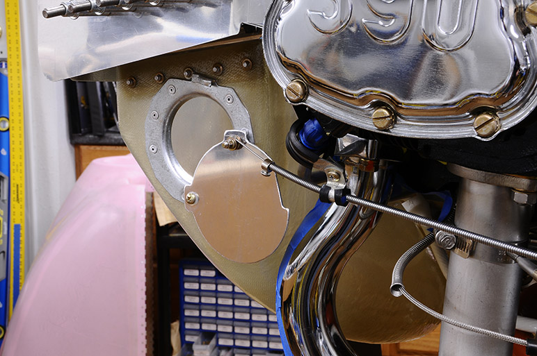

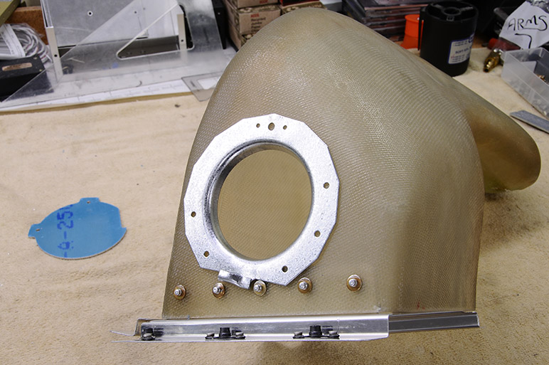

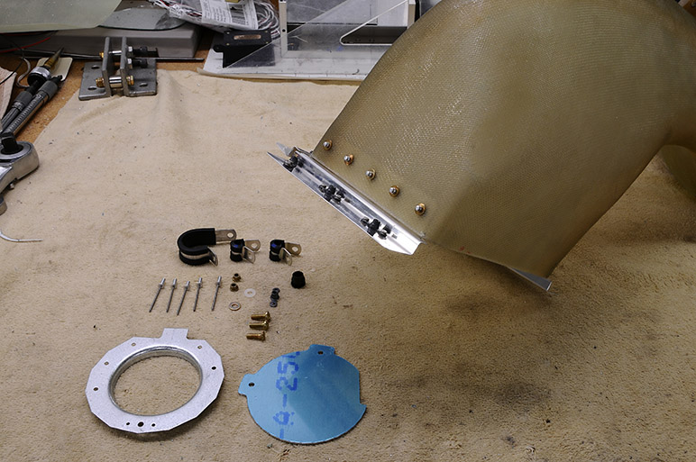

If you design the cable installation correctly, there's no need to remove the cowling. It will work like a normal control. Here are a few pictures of my installation.
