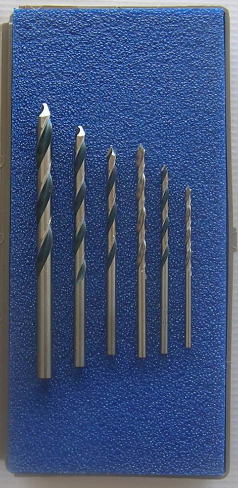

Yes, I did in fact use these very drill bits from Avery to enlarge the holes in the Plexiglass from #40 up to 3/16" for the #6 screw. They work great! Also, I strongly recommend putting a piece of wood behind the Plexiglass with a ClecoClamp before drilling. Didn't have a single problem with any of the holes; and I've got a couple that are a little close to the edge. By the way, the 3/16" hole for a #6 may seem like a lot, but the swimming room greatly reduces the stress on the Plexiglass by any given screw. Consider also that most all of the screw holes are sandwiched between the tube and the fiberglass skirt, so all you really need is the clamping action (and just a little shear action).

[quote]I used special pointed tipped plexiglass drill bits from Avery Tools. Didn't see that mentioned. I suppose you could grind the ends of conventional drill bits to a sharp point.

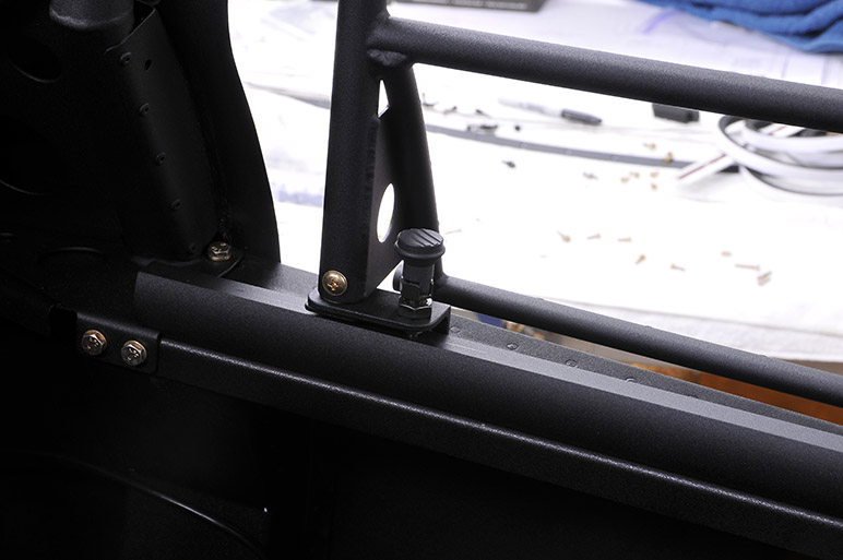

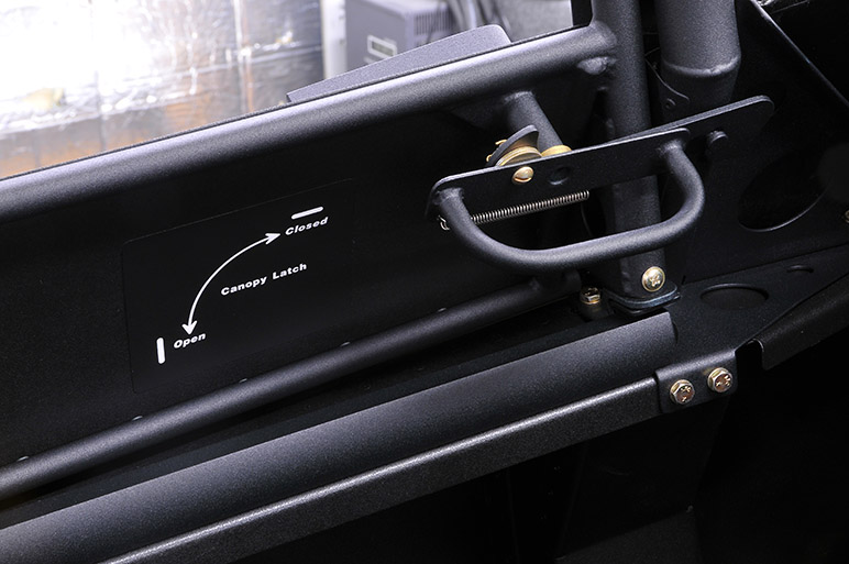

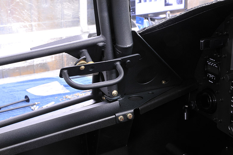

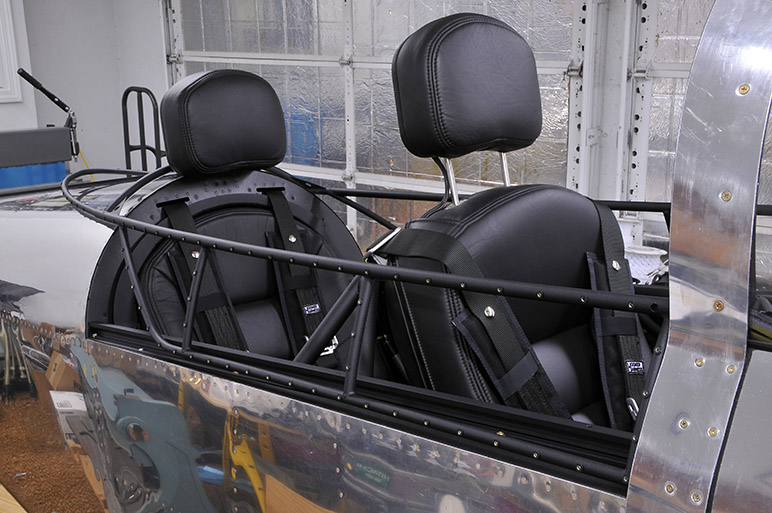

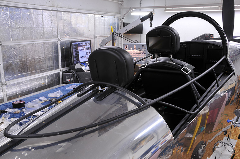

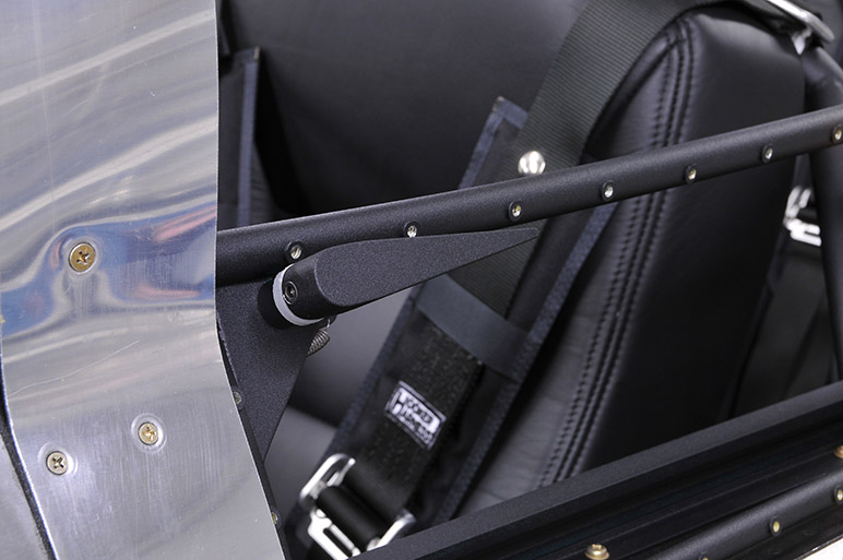

I definitely did consider the very elegant solution of bonding the canopy to the frame. It would certainly reduce the stress factor. For me, however, it presents a couple of problems. One, I like to be able to remove the skirts well after the initial flight for adding dampening and antiskuff material in just the right places. I had the skirts off at least three times after my first flight. The other issue with bonding for me is the painting process. I like to powder coat the frame, then match spray the insides of the skirts, then add labeling. For maximum flexibility, having everything simply screwed together really allows for a high-quality assembly and painting process. Attached are a few pictures from Ruby 1.0's canopy installation to give an idea what I'm talking about.
