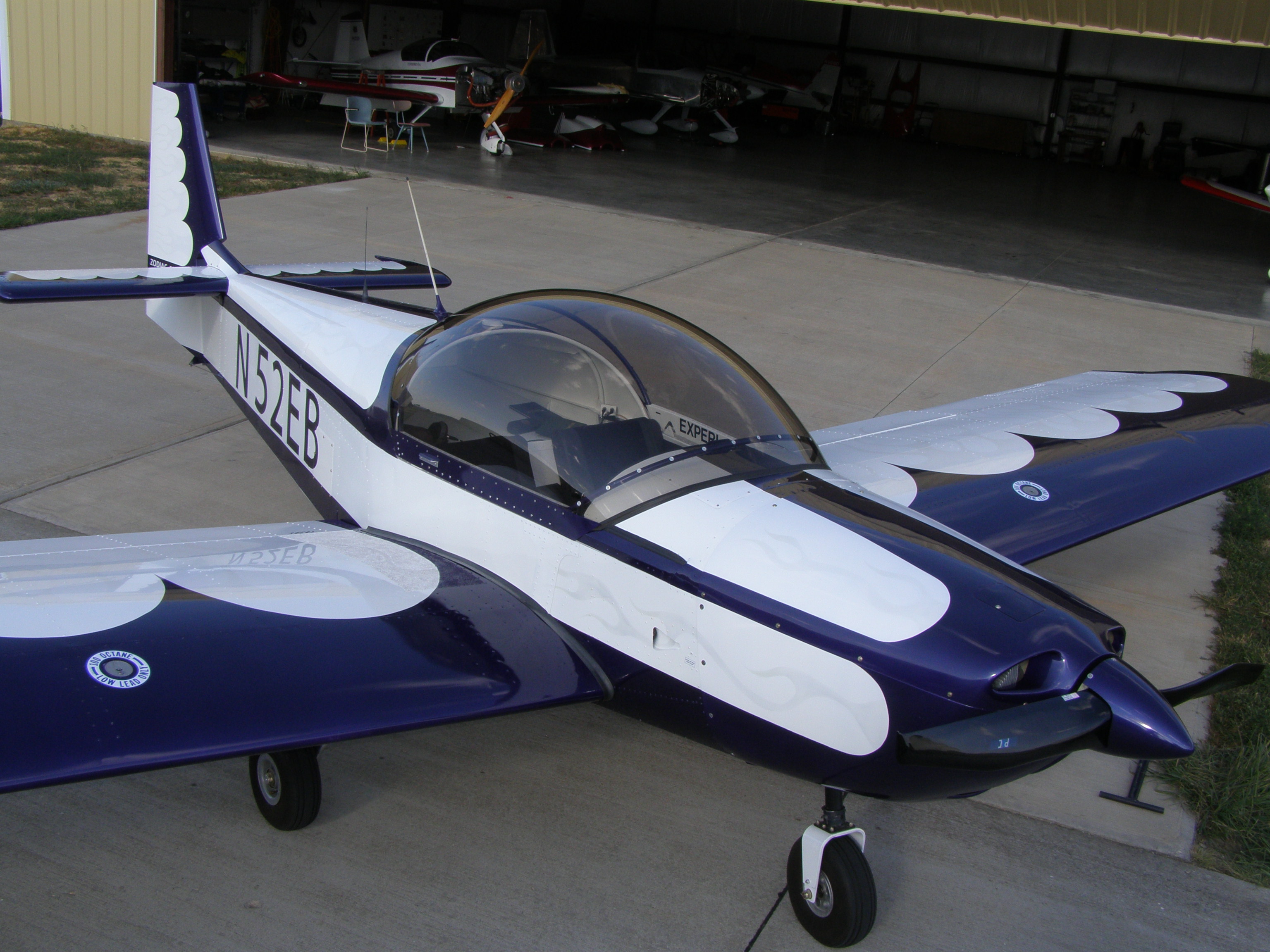

I have a thought...try a Jabiru 3300. I have a Zodiac 601XL-B with
a 3300 and it is very powerful, but not too much for the plane. I have
thirteen hours on it, now and it is great!!

This is a very nice Zodie, Erwin
