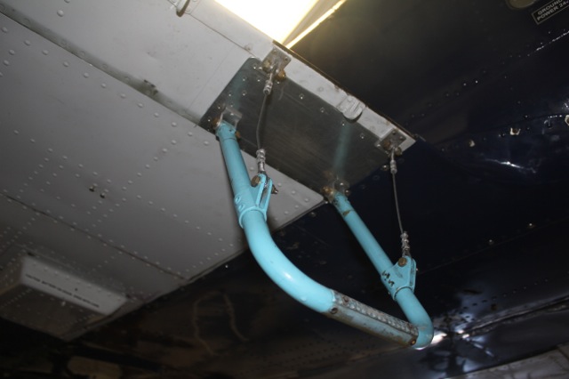

The first pic shows the attached step. We did not bother to remove the existing hooks that are used for the temporary step. That was my personal preference.
[img]cid:38EF0D5D-020A-4DE3-AA01-F0CABB1FEFFA[/img]

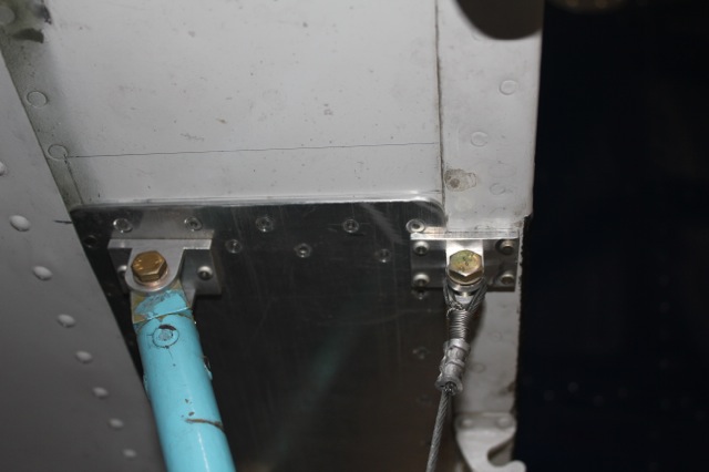

Pic shows undersurface of wing, aluminum plate and the brackets we had specially made. The four brackets cost $140.
The machinist did an incredible job. The trailing edge bracket has a indent so that it marries with the reinforced wing trailing edge and the new aluminum plate.
[img]cid:FCBE8D1E-927B-4FA9-9494-715FD93802E0[/img]

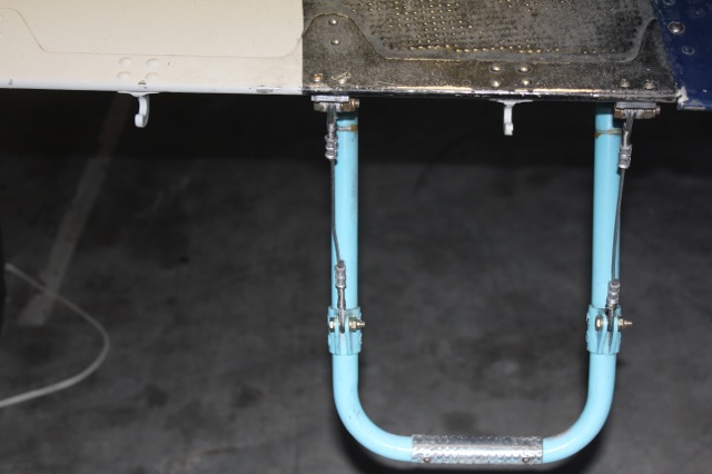

A view of the entire installation. It is STRONG and neat. I still need to paint it, but there you go.
[img]cid:2ED61059-D1D3-4DED-B975-3DEEE381E276[/img]
