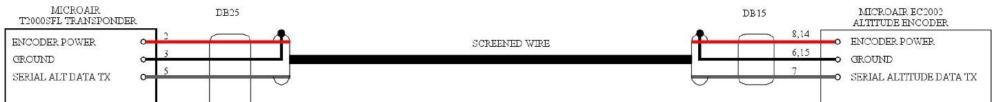

Looking at the page on their pre-wired harnesses at
http://www.microair.com.au/index.aspx?page=186&productID=36
The diagram for wiring their xp to their encoder shows encoder pin 6 (data receive) to be *grounded*.
So, various docs on the Microair website show the encoder pin 6 to be: open, tied to transponder pin 5, and grounded (through the harness) to the case of the transponder.
Anyone have any words of wisdom on the *right* way to do it?
Is this the drawing that has you confused?
[img]cid:7.1.0.9.0.20130421071259.01e610e0(at)aeroelectric.com.0[/img]
It appears that pin 6 and 15 on the encoder are both ground
pins that are tied to harness shield. I doubt that it matters
a great deal whether one or both pins are tied to the shield.
