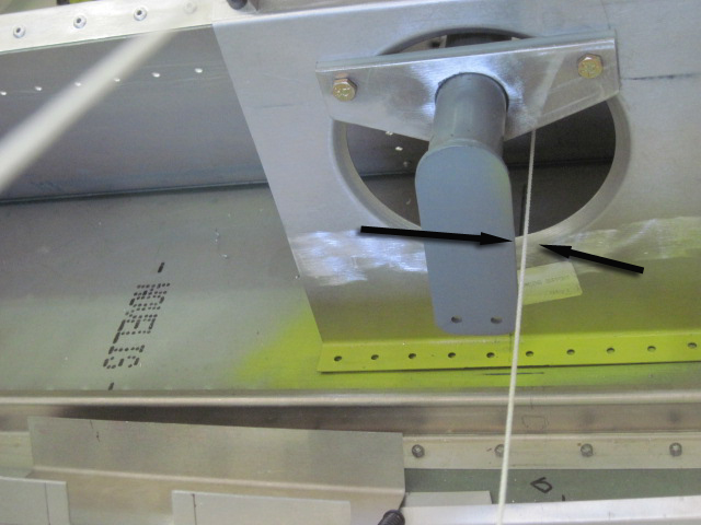

Just a question - I ran a string back from the stick to check the cable clearance. The lower elevator cable seems to run awfully close to the aileron cable attachment point on the back of the torque tube. For those of you who have your ailerons hooked up, does the cable touch the torque tube when the stick is fully deflected left? I'm just wondering if I need to move the hole in the fairlead a little bit to the right to give more clearance?

I know what you are saying. I had doubts myself when building. However, If you build it as it is designed, it will work. Because of the third dimensional movements of the cables, it is almost impossible to visualize or analyze; but trust me, it will work.
