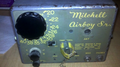

[img]cid:.0[/img]
Powered with dry cells (A and B batteries!) this
transceiver listened on 200-400 KHz (radio range
and locator beacon frequencies) and talked on
120 Mhz VHF. The antenna was a short piece of
wire strung outside the cabin. in some practical
manner . . .
This transmitter was probably good for 100 milliwatts
or so, the receiver was probably in the 10-100 microvolt
class. If you had asked the designer about importance
of SWR for receive (antenna WAAAY too short)
and transmit (WAAAY too long) the response
would probably have cited a quantum leap in
system performance bove light guns, megaphones and
signal flags. Mounted to the panel of Luscome or J-3
in 1948, this radio would allow the TALENTED
pilot to fly an non-precision approach to an
airport using nearby A-N Radio Range transmitters.
[img]cid:.1[/img]

By the way, if anyone stumbles across one of these
radios offered for sale, I'd like to know about
it. It was offered under Mitchell, Motorola and
Gavin trade names but the term "Airboy" seems to
have persisted across all the manufacturing venues.
