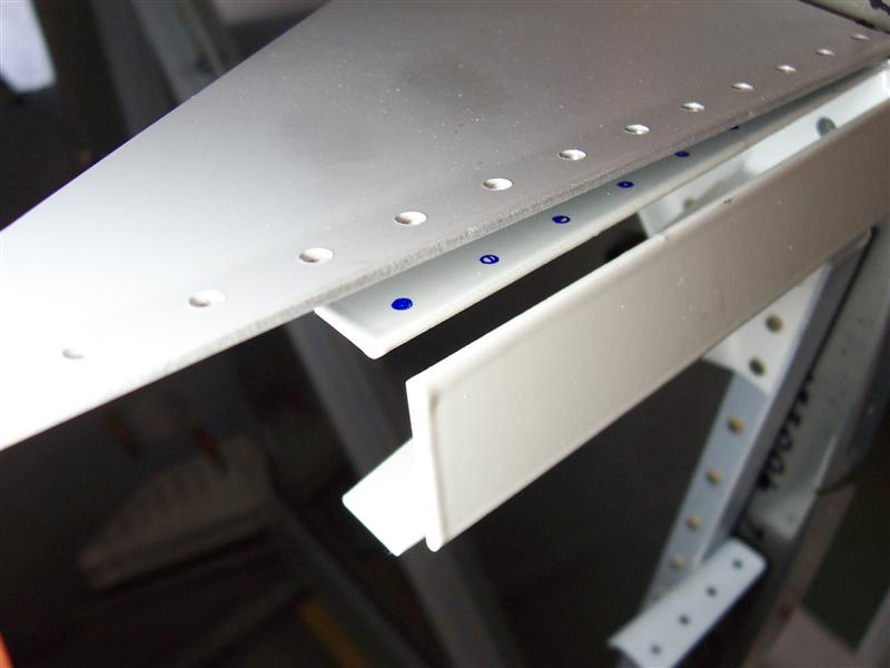

I searched the archive for this problem since I'd seen it before but
couldn't come up with a definite answer. Here's the question. When I look
at the pre-punched holes in the F1001B upper angle and compare to how they
line up with the undrilled upper flange of the WD1002, it's obvious that
I'll run off the edge of the WD1002 with the aft most holes. Pic. attached.
Know some of you contacted Vans about this but never heard the solution. I
can improve the situation a little by loading the bracket ( pulling it
outboard ) but still am not getting more than about 1/16" edge distance, not
enough I think. This is only on the left side, the right will be OK. Want
to solve this problem before going any further and it looks like a new
WD1002L may be that solution. Comments.

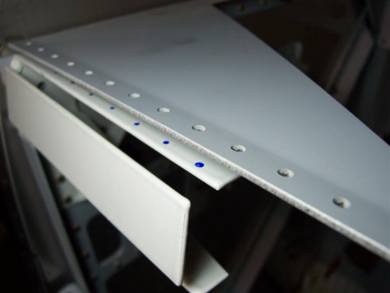

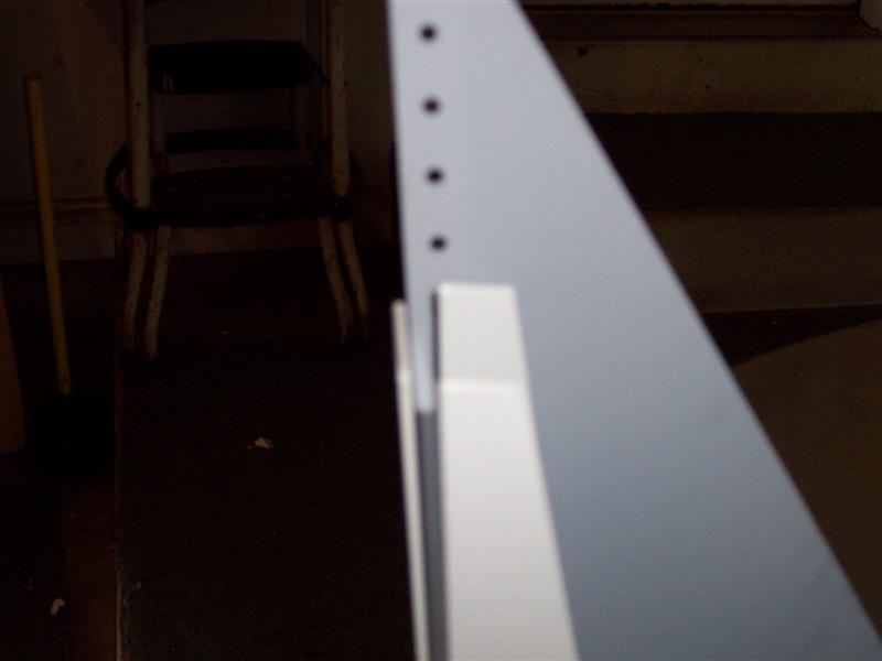

I'm trying to get a good picture of this. I've outlined the rivets on
the flange of the WD1002L and R. On the left, the most aft rivet has a
distance to the edge of 1/16" and doesn't get to 1/8" until the 4th rivet
forward. On the right, the edge distance is at least 1/8" all the way. The
flanges of the weldment and the upper angle are not parallel on the left as
they are on the right. I could get better edge distance if I angled the
drill inboard when match drilling but the upper angle flange has a bend that
calls for a more outboard angle. john

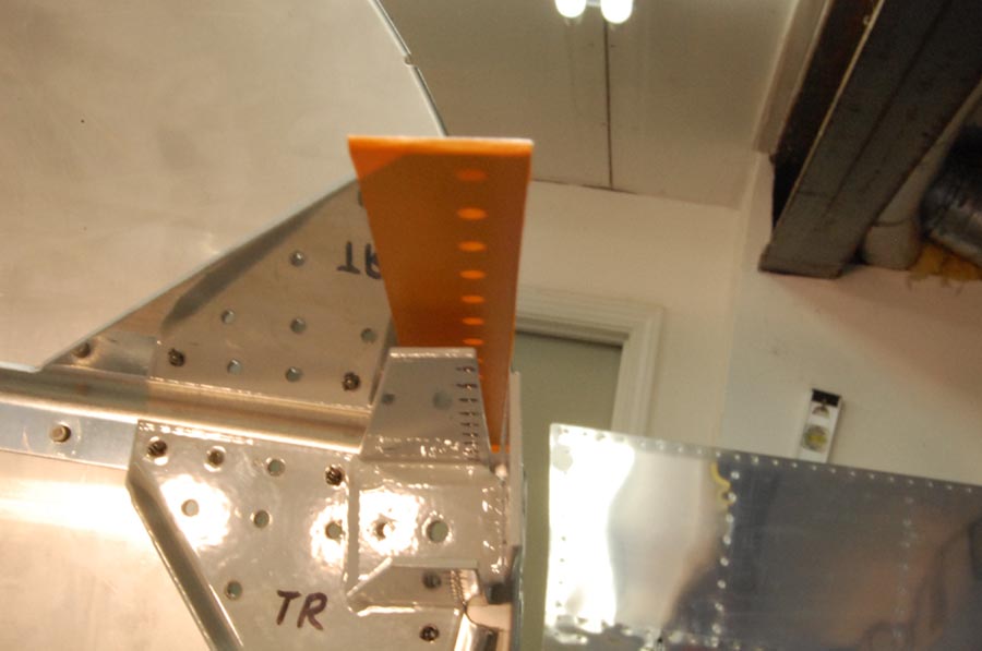

Bringing this old thread back to life in order to document my saga and solution. First time around drilling the firewall brackets, I ended up with insufficient edge distance on the upper flange of the upper (wd-1002) bracket - actually no edge distance. I removed the upper firewall brackets in order to replace them, but had a hard time figuring out what what went wrong. The base of wd-1002 sits on the firewall, partially on top of the base of f-1001b, so these two parts are tied tightly together. The flange of the wd-1002 isn't close to parallel to the f-1001b (see photo, orange tape added for contrast), and since they are rivited together at their bases, there isn't much scope for applying pressure to bring them in line without exerting substantial preloading to the firewall rivets.
Scott Risan was good enough to send me new brackets, so today I clecoed up the right side one, and it looked nice. Edge parallel to the F-1001B. I smiled and clecoed up the left side, only to find that it was quite non-parallel, and there would be no way to get good edge distance. Quit smiling. Eventually discovered, as I was playing with them on the table top, that the base of the W-1002L was ever so slightly rockered across the horizontal axis. Because all the rivet holes across the top are on one side of the rocker, it pitches the flange arm inboard. I threw the bracket into a vice and bent the base just a bit, then did a little filing of that thick powdercoat, till the base (forward side of the weldment) sat flat on the table. Re-clecoed it, and it looks good enough. The high spot on the forward face of the base that caused the rocker is associated with the welding on the aft side.
So, this problem is solved, I post here to alert other builders to be prepared to check the W-1002 for a flat base and tweak if necessary. I also note though that even though my W-1002 bracket arms are now parallel with the F-1001B, they sit 1/16 inboard of the outer edge of the F-1001B. The prepunched rivet holes in the F-1001B that serve as the drilling template are right at 2 edge diameters, so edge space is really at a premium here. Be careful!
