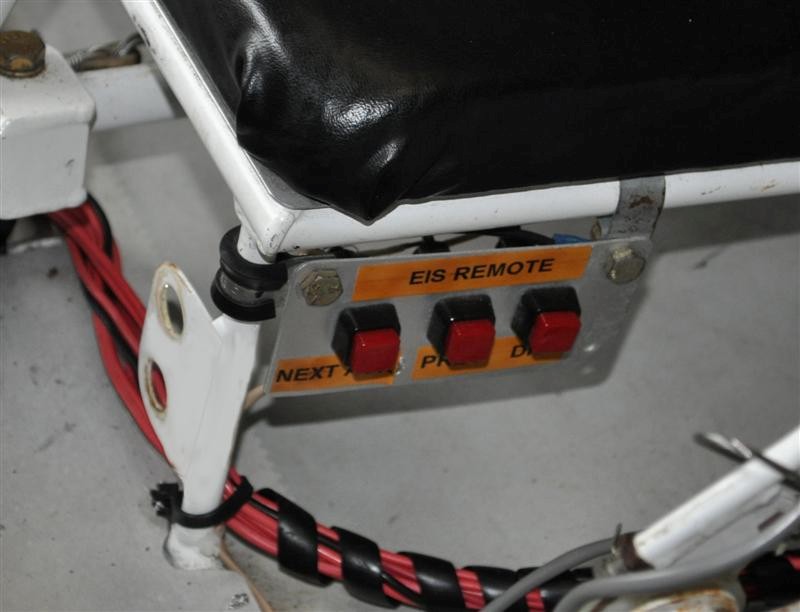

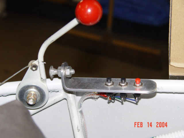

Here's the Factory extension...
They were "Labeled" later...
The extension was free from the company...
The Switches are simple / cheap (contact -open )
Gotta Fly...

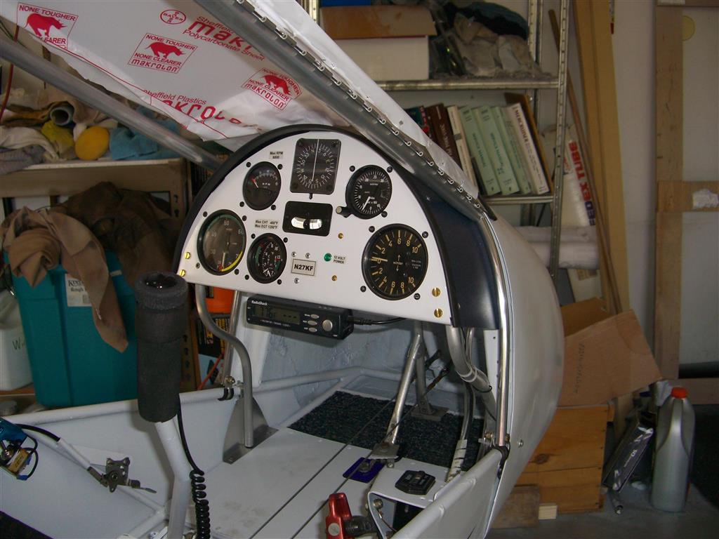

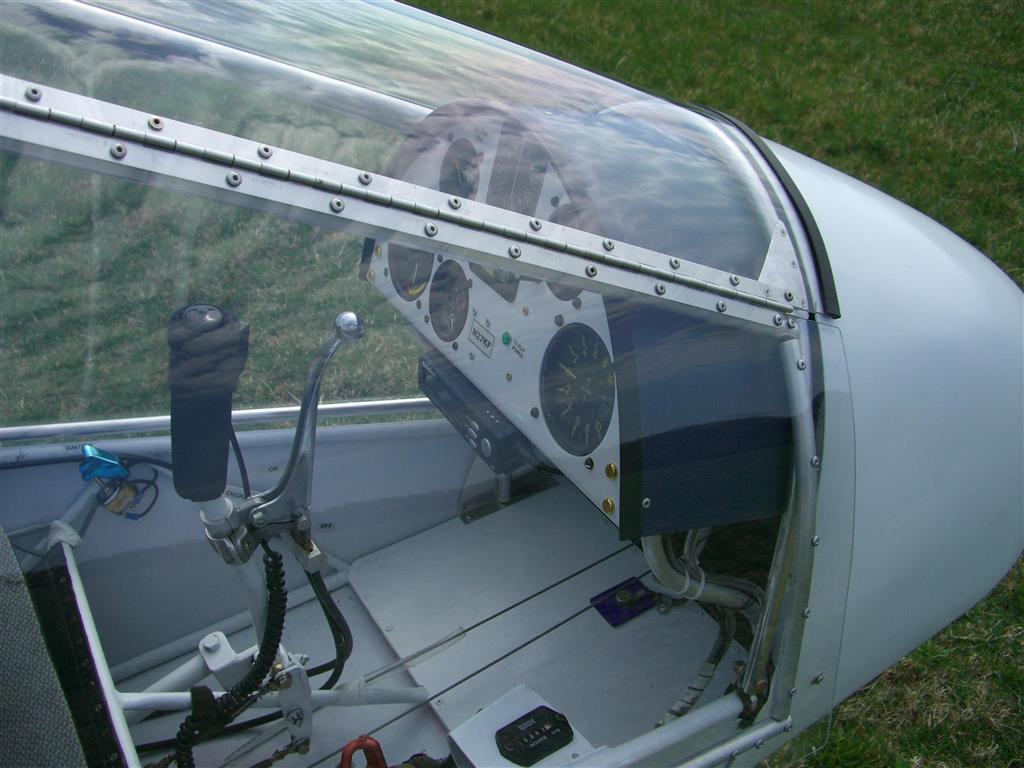

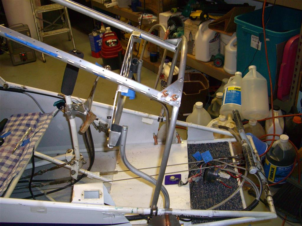

This is what I did to reach the panel. I moved the panel closer.
 Filesize:  102.91 KB
 Viewed:  27128 Time(s)
 Filesize:  108.06 KB
 Filesize:  132.9 KB

PostPosted: Wed Mar 20, 2013 11:36 am    Post subject: Re: Can't reach the Panel... Reply with quote
Ducati SS wrote:
Scott do you still own the Firestar?
Sure. I still own it. I must be in a rut.
Two things I would do differently with the panel if I had to do it again.
1. Paint it black. White looks nice until it is reflecting on the windshield.
2. Make sure the compass sits level in flight. I should have known better. I have to slow down and fly slightly higher AOA to get it to turn freely.
Scott
That's excellent! Did it change the weight & balance much ?
Thanks for the post.
Dennis
