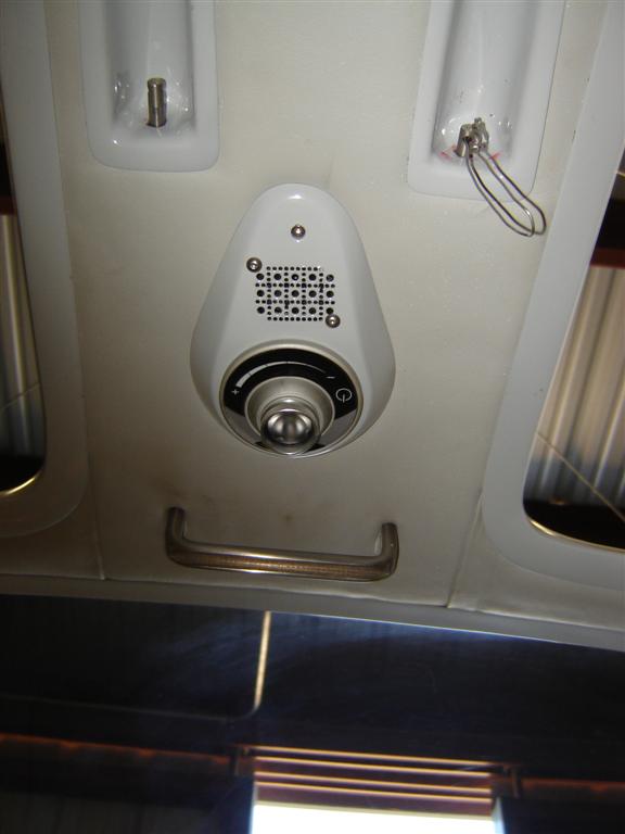

I have installed an EyeBeam mini LED cabin light in my composite airframe. Unfortunately I do not have a schematic of the unit, but it uses capacitance (touch) to control the on/off function and dimming.
The LED is powered by shielded, twisted pair power and ground wire cable. In the same small enclosure on the ceiling there is a 4 ohm 1.25" x 1.75" cabin speaker and it's power and ground comes from 180 deg away from the wires feeding the LED with no parallelism or overlap. The shield for the LED is grounded at the ship's single point ground bus.
The problem:
When I key the microphone, the EB turns on. If I key it again, the EB begins flashing uncontrollably. It is unresponsive to the dimming control and the on/off switch. The only way to stop the flashing is to disconnect the EB from power. The EB works as intended when connected to battery power independent of the ship's electrical system. The LED also turns on if I power up the audio panel with the speaker selected. Yesterday it turned on when my hand got near it.
Attempts at a solution:
Thinking that the the magnetic field of the speaker magnet may be causing the problem, the speaker was disconnected and the mic was keyed. The EB exhibited the same uncontrollable flashing upon keying the microphone. I installed elongated ferrite donuts on the LED cable at various locations and on the speaker wires to no effect.
I contacted the manufacturer and their solution was some huge boss hog thing that I'm sure would prevent ET from phoning home.
If co-located with the LED, it needs to be small enough to fit in about a 1/2" high x 1.25"OD cylinder
Any ideas on what's happening and/or how to fix it?

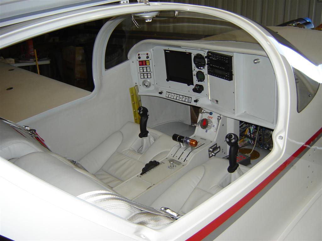

Yes, the same. But I don't know what they mean when they say "no external power source required". That would be some trick!
Aside from the issue I'm having, it works really well when I don't have other devices on. Undimmed, the light is very bright and white. Mine is mounted on the ceiling (attached) of my Glasair in the center and the eyeball range of motion is excellent for reading (pilot or pass) and panel illumination.
Allow about 3/4" for clearance above the spec drawing for range of motion of the ribbon cable, hence the housing I made.
