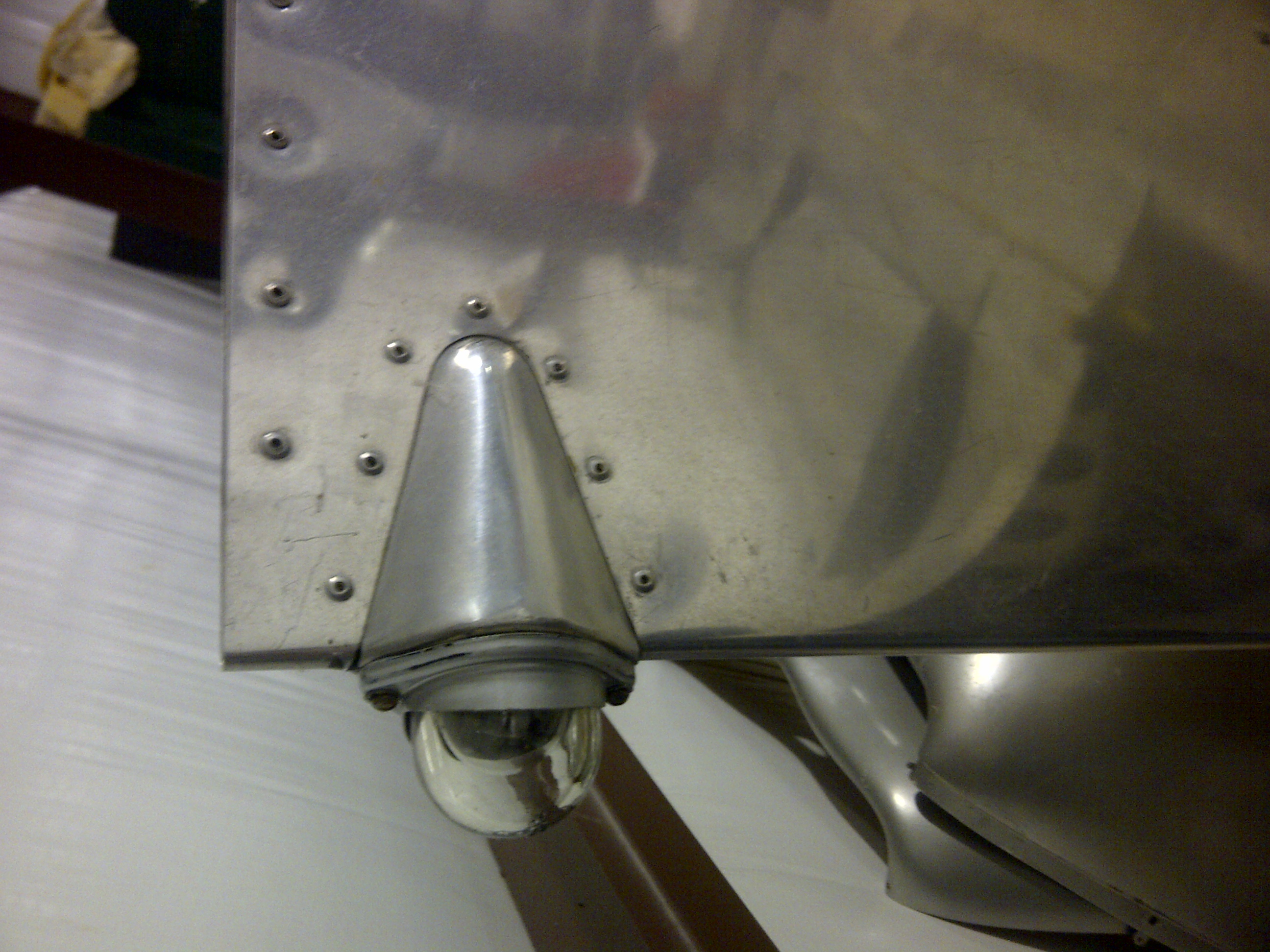

Has anyone on the list seen a metal strobe light bracket. This picture was taken of a 601HD.

I’ve seen ones that were bent on a brake, not formed like the one in your picture. Not as pretty or compact but they worked.

Joe, Daniel Dempsey made one, and if you google it, chances are you will find more examples
http://daniel.dempseyfamily.us/zodiac/index.html
I believe the same process used to make calbe fairings can be used:
http://www.ch601.org/tools/rudder%20cable.htm

I’ve not seen metal ones but fiberglass isn’t too hard to do if you go from a clay shape, to a mold, to a layup.
See link,
http://www.macsmachine.com/images/rudder/full/taillight.gif

I got a fiberglass fairing from Zenith. It took a bit of filling and sanding, but I think it looks pretty good installed.

So did I... Mine looks ok too.

<?xml:namespace prefix="v" /><?xml:namespace prefix="o" /><![endif]--> Zenith sells them in thermoplastic for about $20.00 or so.

I made my own from a piece of scrap ally. It has very simple bends. Make a template from cardboard and cut it out from Ally.
Check out http://zodiac.cpc-world.com/images/IMG_1291_JPG.jpg and http://zodiac.cpc-world.com/images/IMG_0111_JPG.jpg for details.

We used a simple design based on a cardboard template:
http://utdallas.edu/~klaus/Airplane/rudder_nav_light.html
