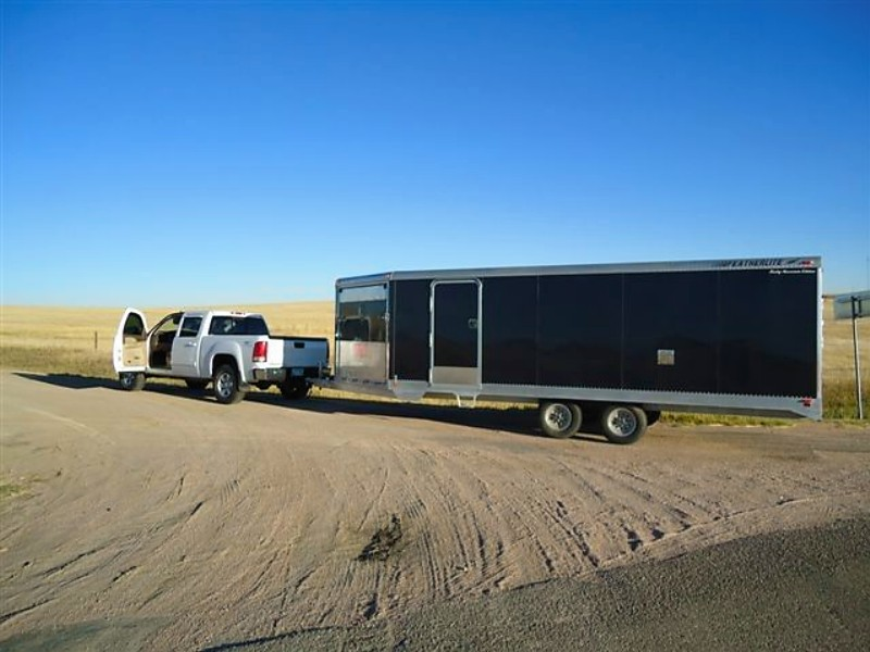

A snowmobile trailer rent is usually very reasonable and they offer great protection and road handling.
A downside is the back main door is usually smaller then the inside dimensions, so you will have remove wings and prop and oil tank.
Never attempt to fly a 400 pound Kolb home if you are unfamiliar with it's handling characteristics.
