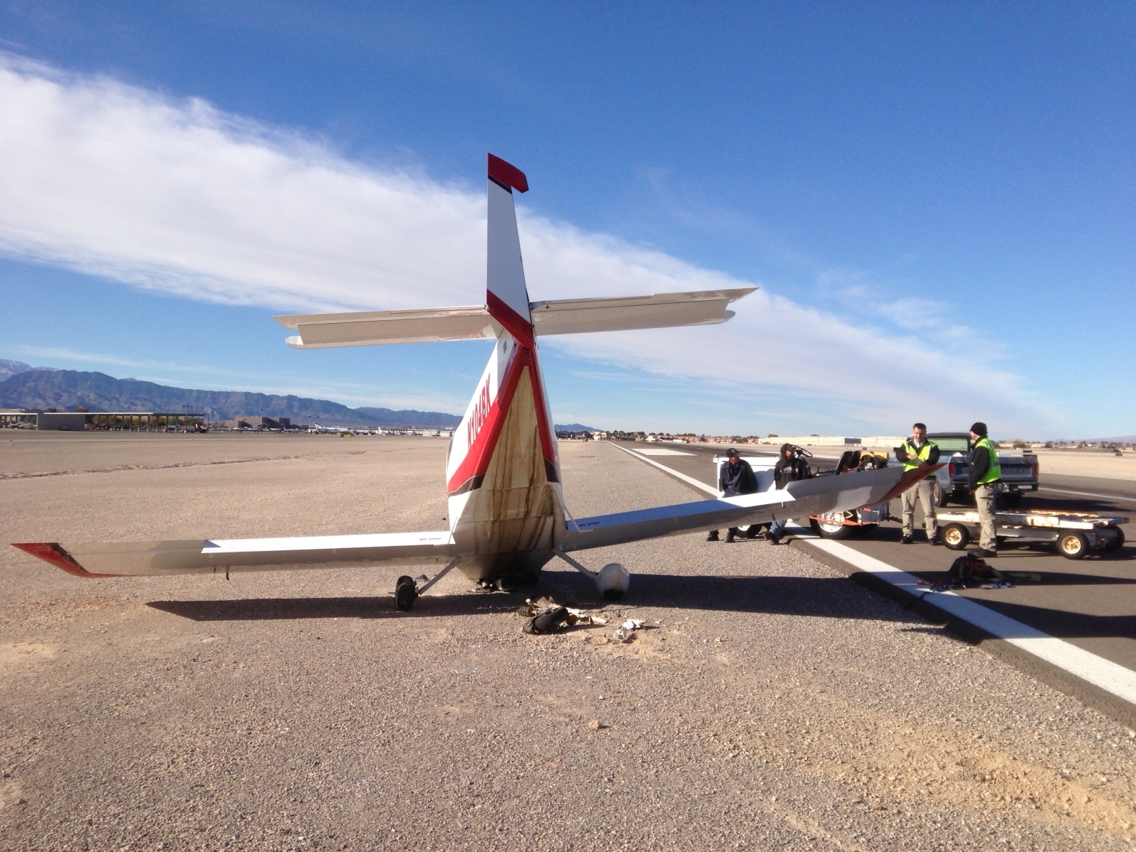

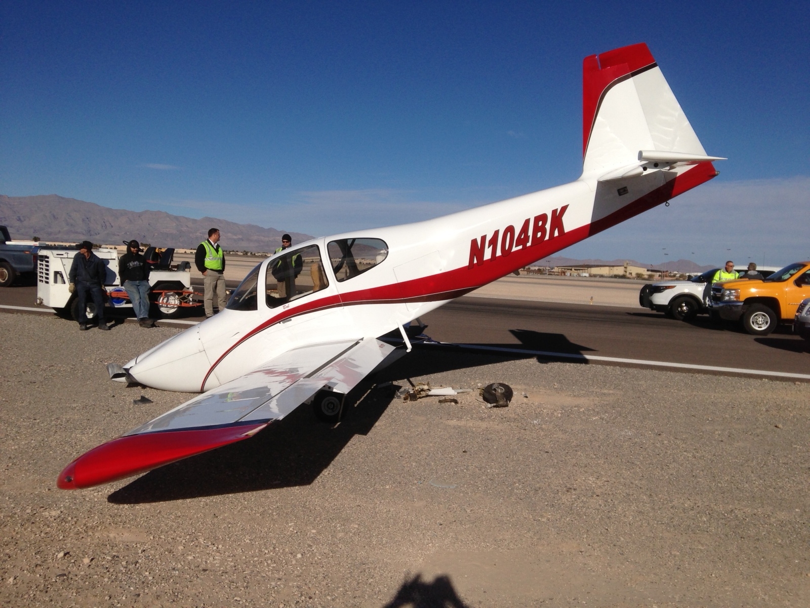

PostPosted: Wed Jan 02, 2013 1:03 pm    Post subject: RV-10 nose gear failure Reply with quote
Came across some pictures of the plane. Looks like the front gear ripped off
and there is oil all over the belly, not sure which one came first however.
Not to spread a theory, but my understanding is that the plane did not flare
completely when it contacted the runway, possible pushrod related. Only the
NTSB report and Bob can confirm that.

PostPosted: Wed Jan 02, 2013 2:07 pm    Post subject: RV-10 nose gear failure Reply with quote
Purely speculation, but I gotta figure that the oil on the belly was there before the nose gear collapse. There is a good amount of oil, and it's wind blown all the way back to the tail.
On Wed, Jan 2, 2013 at 3:01 PM, Pascal <rv10flyer(at)live.com (rv10flyer(at)live.com)> wrote:
[quote] Came across some pictures of the plane. Looks like the front gear ripped off and there is oil all over the belly, not sure which one came first however.
Not to spread a theory, but my understanding is that the plane did not flare completely when it contacted the runway, possible pushrod related. Only the NTSB report and Bob can confirm that.
