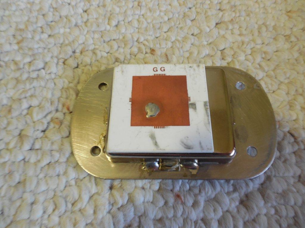

PostPosted: Mon Dec 31, 2012 7:20 am    Post subject: Re: Overhead Console Final Installation & TCAS Antenna Reply with quote
The Garmin GNS 430W and the G3X install manuals do not specify a bonding nor a ground plane for the GPS antenna. I suspect that this may have been revised for the GTN manuals to add the requirement. I have not seen any issues with my installation, which does not have a ground plane on either GPS antenna.
I found an old GPS antenna and decided to sacrifice it. Below is a photo of the inside of this certified GPS antenna. The actual antenna element is etched on the top surface of a copper clad ceramic wafer which has a copper surface covering the entire underside (not visible in photo). The combination of the thickness of the ceramic and the size of the element determines the electrical properties of the antenna. This type of design is called a "patch antenna". Under the patch antenna resides the low noise amplifier. You can see that the antenna itself is mounted approximately 1/2" above what might be considered the base. Any additional ground plane that may be added by mounting this antenna to the metallic skin of the aircraft would "appear" to this patch antenna to reside 1/2" above the actual patch antenna ground plane.
This antenna is an old design, and is probably not representative of the new low noise semi-conductor technology nor GPS antenna design. The noise figure and gain of the newer antennas is so far improved over the some of the original designs that it is hardly a fair comparison. But I couldn't resist taking it apart!
Bill
