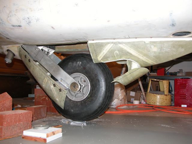

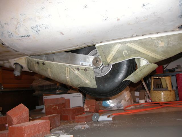

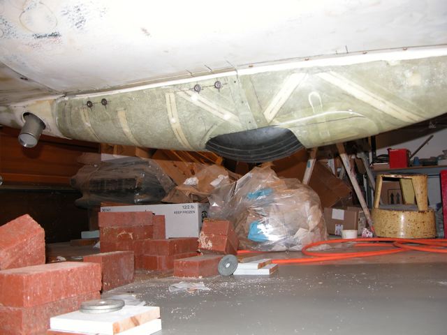

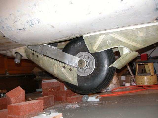

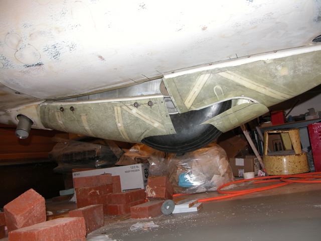

On Dec 16, 2012, at 11:20 AM, graeme bird wrote:
I fancy adding a rear fairing for the main wheel, has anyone made a mould they would be willing to share or any comments on the usefulness of such a feature,
Graeme...here's what I've done...I've used a mold borrowed from Alex Bowman...layup was 2 layer BID + stiffeners...note that the front of the portion of the fairing mounted to the LG fairs into the cowl...also made from Bowman's mold although was much modified...a nice winter project.
Fred
[img]cid:16AE2F2F-41C3-40E1-9574-8C3107873749[/img]
[img]cid:FE016191-4F5A-48C1-95F3-158485D9CBD4[/img]
[img]cid:5FEC94E4-196A-4283-95A0-4862527A1A03[/img]
[img]cid:584B1D65-73AD-410E-B830-68862B3D425E[/img]
[img]cid:9F1DC271-8D58-41B2-BB9A-606930398306[/img]

amazing, ta for the pics. I should want to be sure the wheel will latch up .. and also go down. That all looks quite tight considering my muddy field this time of the year at least.

PostPosted: Tue Dec 18, 2012 6:21 pm    Post subject: Re: mono wheel rear faring Reply with quote
Wow Fred,
I know you said you used Mr Bowmans molds but that looks real impressive. Wonder what a set of those would cost to have some talented soul, with more time than me, to have made?? If you get my drift.
