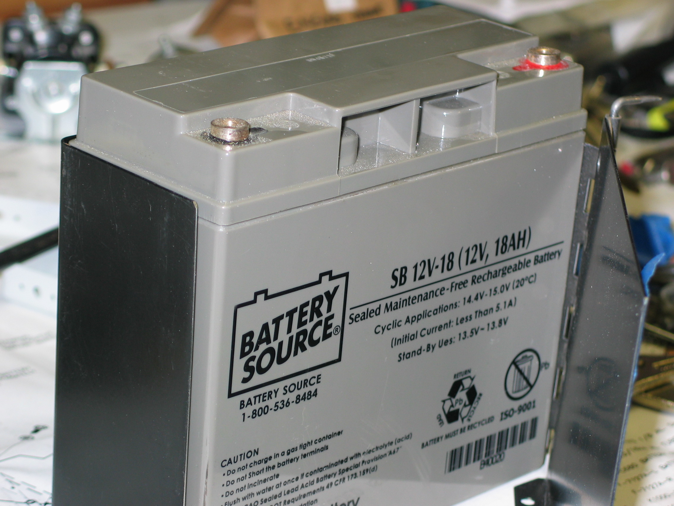

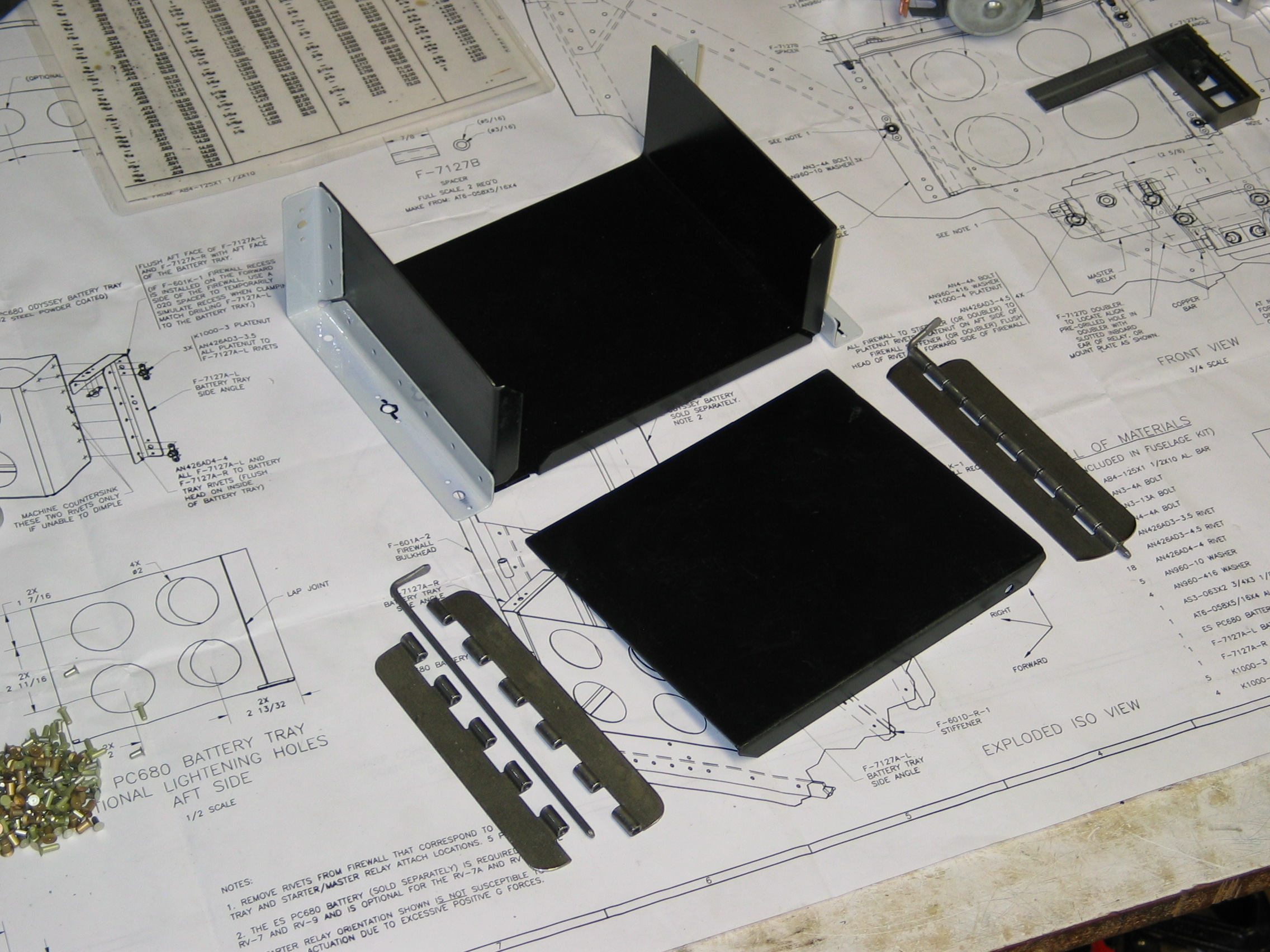

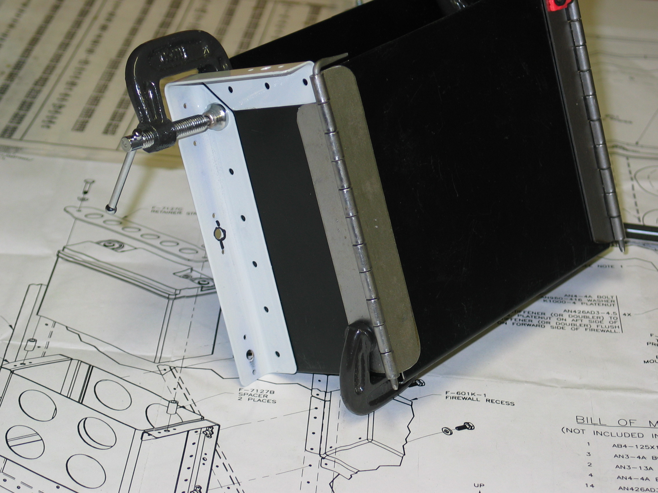

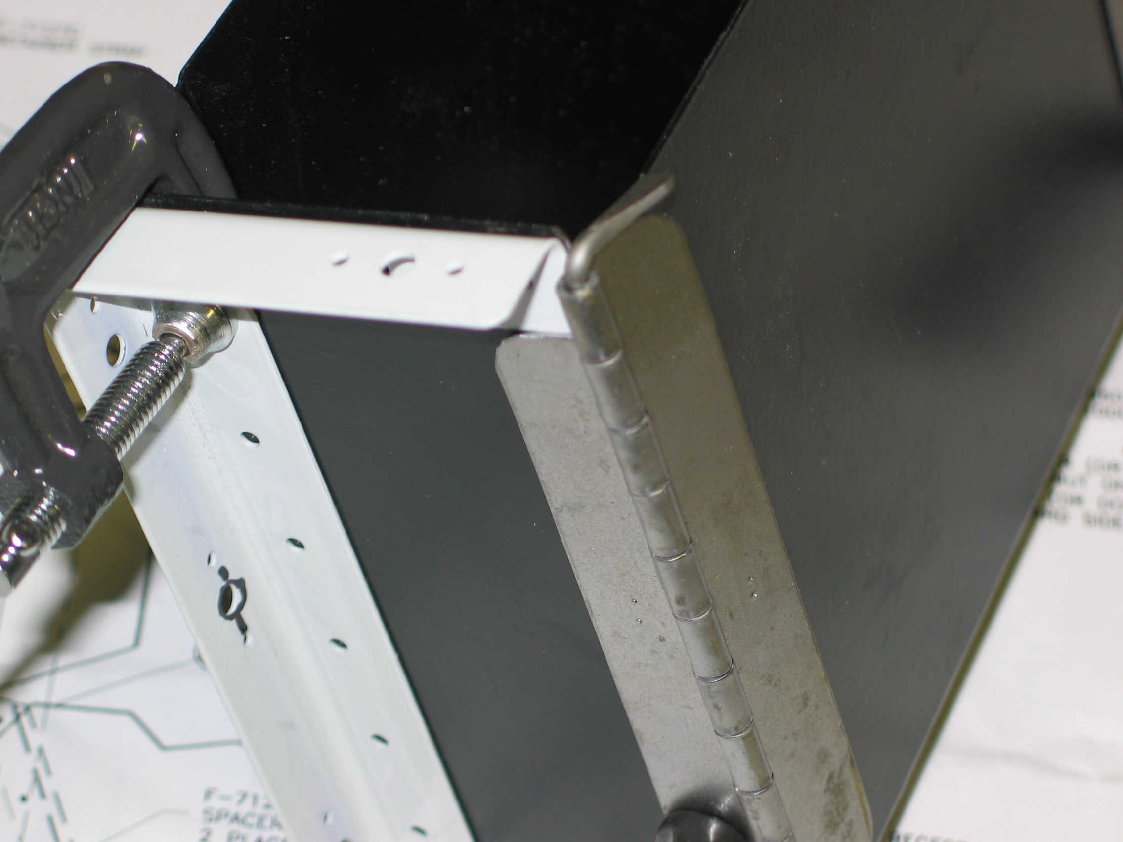

I took a few pix of the mod to the battery box. This should give
you the idea on how it goes together. My first attempt tried to get the
whole "other" battery into the box. However, the Panasonic does not have
the little ridge around the top which holds the battery about 1/4" up
from the bottom. I will file that ridge off the generic battery so it
will go all the way to the bottom. Then again, I might put a spacer in
the bottom to take up that space. I'm not in favor of trimming the
little flange around the top of the "other" battery. It seems to be
where the top and bottom come together. What is your thought on trimming
or spacing for that little protrusion?
