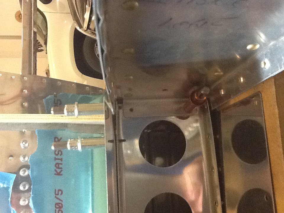

Hi All- I'm trying to attach the Tip Rib assembly to the elevators, and cannot tell what the "order" should be of the parts....I believe the very top is the main skin, followed by the Tip Rib skin.
What I'm unsure about are the flanges of the E-903 Rib and the E-1002 Spar. In the attached picture, the E-903 flanges are on the outside of the E-1002 spar flanges, but then the main skin is not quite tight between the 1002 spar and main skin. It also looks like this is stressing the E-1002 flange as it pushes it down a bit.
The other option is for the E-1002 flange to be on the outside, but that creates a tiny gap between the E-903 flange and the E913 Rib Tip skin. So, nothing looks quite right, and I'm wondering what I'm missing.
I'm sure this is something basic, but I've stared at it long enough! Thank you,\
Steve Farner

I put the rib flanges inside the spar flanges:https://picasaweb.google.com/lh/photo/sgspHys2LPDJPdi22WBl1NMTjNZETYmyPJy0liipFm0?feat=directlink
https://picasaweb.google.com/lh/photo/OrKcmLgostpF9xddmht4dNMTjNZETYmyPJy0liipFm0?feat=directlink
https://picasaweb.google.com/lh/photo/RPF0hrgtZngylLNIJb17S9MTjNZETYmyPJy0liipFm0?feat=directlink
