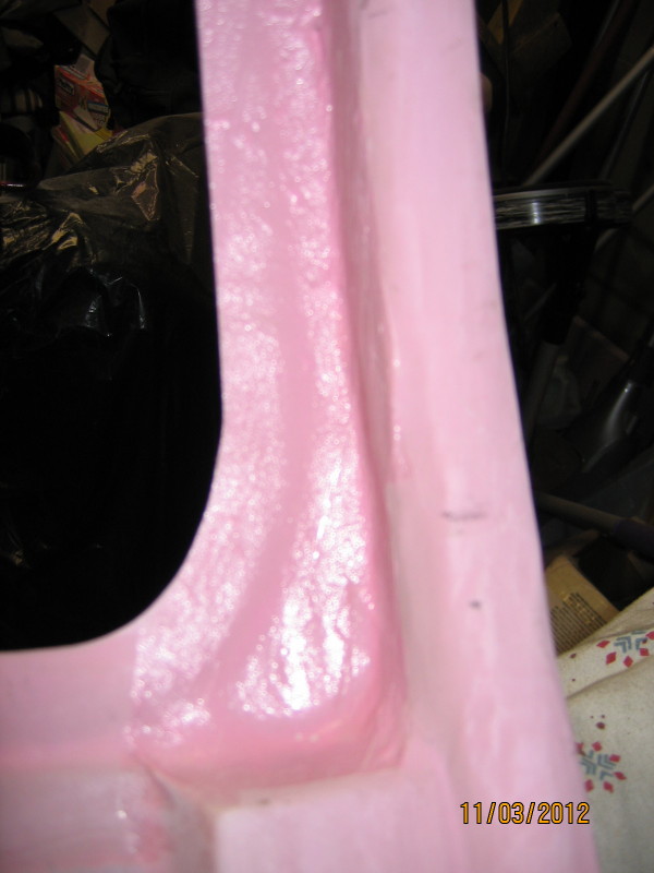

I am working on finishing the inside of the cabin top and I have a question about one area. In the attached photo, there is a shiny area on the vertical portion of the door opening. It has been suggested that it may be some remnants of peel-ply that was not removed at the factory. If that is the case, do I need to try to remove it, should I sand it away, or can I just use Superfil over it as it is? Thanks.
[img]cid:part1.09070902.03010401(at)ameritech.net[/img]

As I recall, the shiny parts are where they missed with the peel ply. The matte areas are where they properly did lay down some peel ply. On mine, there were bits of peel ply that didn't get peeled. Application of a flame will quickly char and burn it away (thanks Dave).
The whole mishmash of finishes had me so vexed that I decided to cover it all with fabric so I don't have a clue as to what to do except to cover it.

Oh wow.  That photo nearly made me turn green as my stomach rolled over.  It's like looking at an old photograph you can't stand.
With all the fiberglass stuff, you want to sand the high spots off first and then fill the lows second.  So get out the sanding block and sand it down until you're left with a few obvious low spots and then fill those.
You'll probably want to mark the lows with a sharpie (so you know where they are) and then rough them up with sandpaper so the filler will have something to bond to.  It won't stick to a shiny surface very well.

Yeah.  I have sanded mine down (and filled it too) to the point where I at least like the profile of the cabin top.
I'm using Geoff's headliner in the back.
2 weeks ago I covered everything that Geoff's headliner didn't cover with blue painters tape.  Then a couple of coats of wax.  Then two layers of carbon.  (Had to use carbon to get it stiff enough).  And I built inserts that I will wrap in headliner material and velcro against the inside of the cabin top.
I'm still in the finishing processes of it, but I'm going to be on the road for a next 3 weeks.  I won't know exactly how it turned out until Dec.

Bill's right, that's most likely an area that never had peel-ply over it.  If it does turn out to still have some on it, you should be able to get ahold of an edge and tear it off.  In that area, it wouldn't hurt to just leave some peel ply there but that's not really the best practice.  It looks to me like it's just plain glass though.
I'd sand it with some 80 grit and finish it however you like.  That's another way to find the peel ply--if the edges ball up when you sand it, you'll know it's peel-ply.
I painted some of those hard-to-finish areas with truck bed liner.  Turned out pretty well.

As others have mentioned, there are multiple solutions available. My first recommendation is to get the Aerosport Products headliner from Geoff. That will cover 2/3 of the cabin cover. You won't have to sand or fill anything covered by the headliner. If you get his overhead console, that will even cover up more area.
I used USC Auto Body Icing, but there are other similar products available. I found it easier to work with than plain micro. There is a fair amount of filling and sanding to get everything smooth.
Just don't attach the cabin cover to the fuselage until the end. It's a lot easier to work on upside down on the bench.

I recommend finishing the entire inside of the cabin top off like the outside of the airplane. Sand and fill
As required. It will take 2-3 days and a lot of elbow grease but when done it will look much better
Than doing minimal work. There is a spray primer called duratec the is a 2 part sprayable body filler. Once you work out the real bad spots and sand spray a good heavy coat on the entire inside of the cabin top. Block it out almost back to the raw fiber glass and do it one more time. Then it should be very close to final paint. Do all this before attaching the cabin top to the fuse.
If using a overhead console you can omit doing the area under the console but do everything
Else. Paint and complete entire cabin top install lights or what ever you want before installing.
Life will be much easier and the results will be very gratifying.

I came to the conclusion that we had to fill, sand & paint once we opted for the OH console. I just could not imagine dealing with a headliner and transitioning from headliner to all the window cut outs as well as the OH console and potentially all the switches, vents, lights... That was my version of K.I.S.S. and in this case less is more. I am still happy with the choice. Of course my preference as always is to have Geoff figure it out first and then follow suit but we started building too soon. Smile
http://painttheweb.com/painttheweb/rv-10/Console.aspx
The painted lid and Aerosport Products interior panels gets you one nice interior.

Follow exactly what Robin did and then add then add headliner if you wish. As Robin said less can be more.
