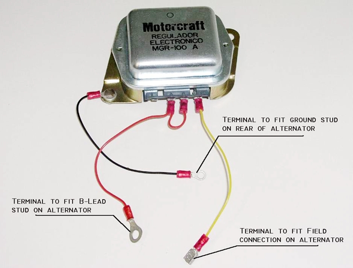

a test regulator like this:
[img]cid:.0[/img]
This is a cheap generic VR166 regulator for "ford".
Convert your alternator to a locally regulated device
with temporary installation of this test regulator
and then go fly the airplane. If the bus voltage rises
to the nominal 14.2 volts, then your problem resides in
the existing regulator . . . if not, the alternator has
a problem.
