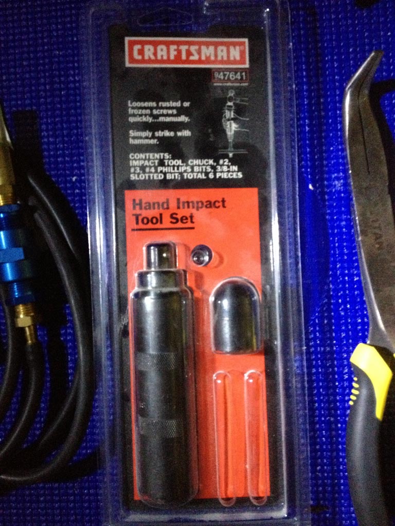

Happy New Year to all, and apologies for returning to an old topic...
Bob (Borger) had an option for a Sears tool that would remove the plug. Bob, do you have details of that (picture, part number?).
Best
Richard

Posted: Tue Jan 01, 2013 6:12 am Post subject: Removing magnetic plug from Rotax 912 gearbox |
Richard,
Yes, I have a Sears tool that works. I'll get the necessary information and a picture the next time I'm at the hanger. Maybe later today.
Weather has been awful for flying for the last several days, but lovely considering the draught conditions we've had. I'll not complain about cool, rainy, foggy weather in North Texas.

Friends,
This is the hand tool that can be used to remove the magnetic plug.
[img]cid:721F83DA-E04F-470D-894C-F1AA6BAA1BAC[/img]
It requires a 1/2" drive #40 Torx bit.
For specific instructions on removal of the magnetic plug see the instruction video at Rotax-Owner.com. They provide a quite detailed tutorial.

Thanks Bob, this may do the trick. I'll order one. Challenge I have is to get it to East Africa, but thats another story....

The impact tool that Bob used has been copied by the Chinese and is available at motorcycle shops and the like. You may be able to find it locally. The Chinese tool isn't high quality but you only need it to work once!
