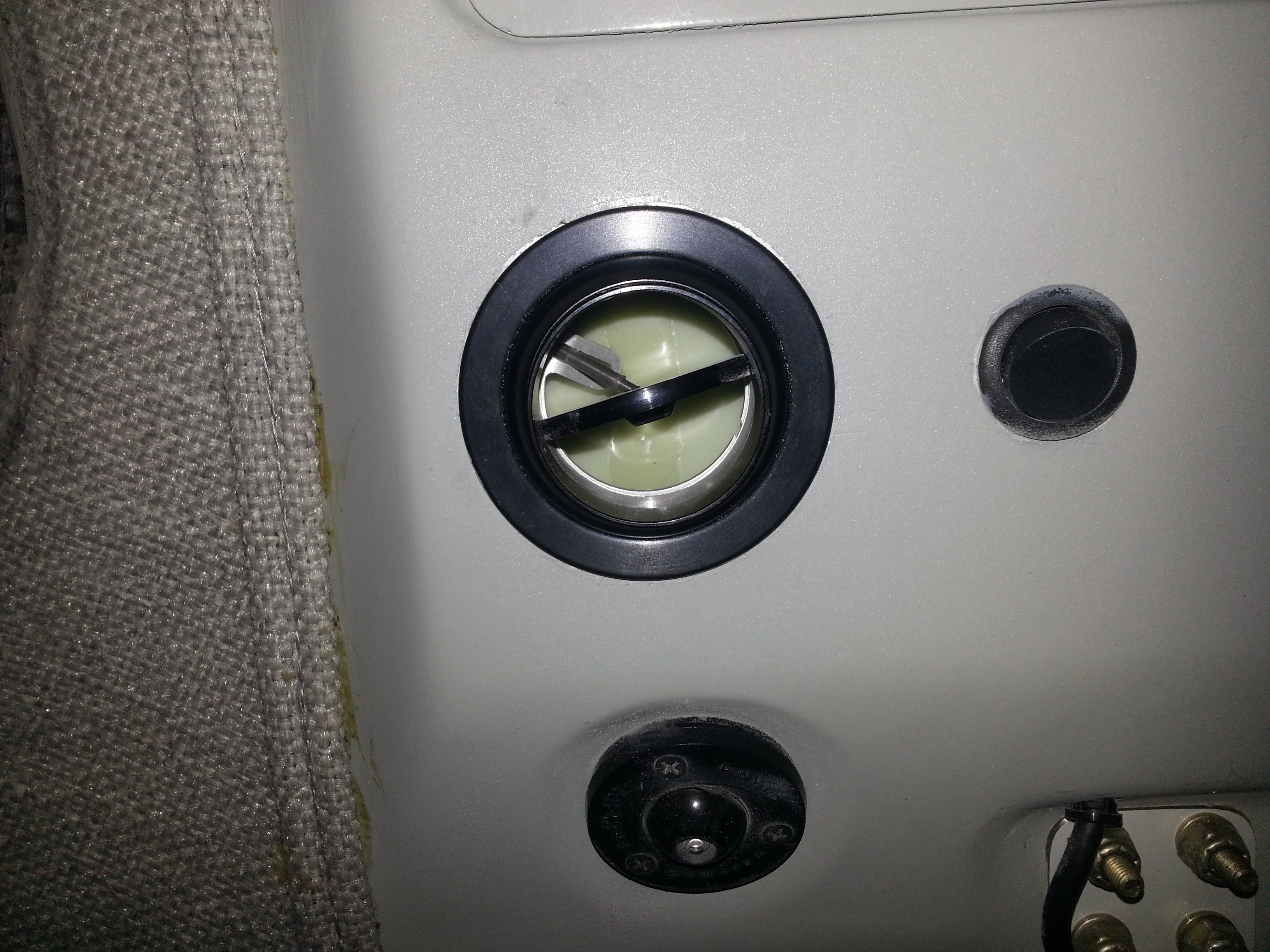

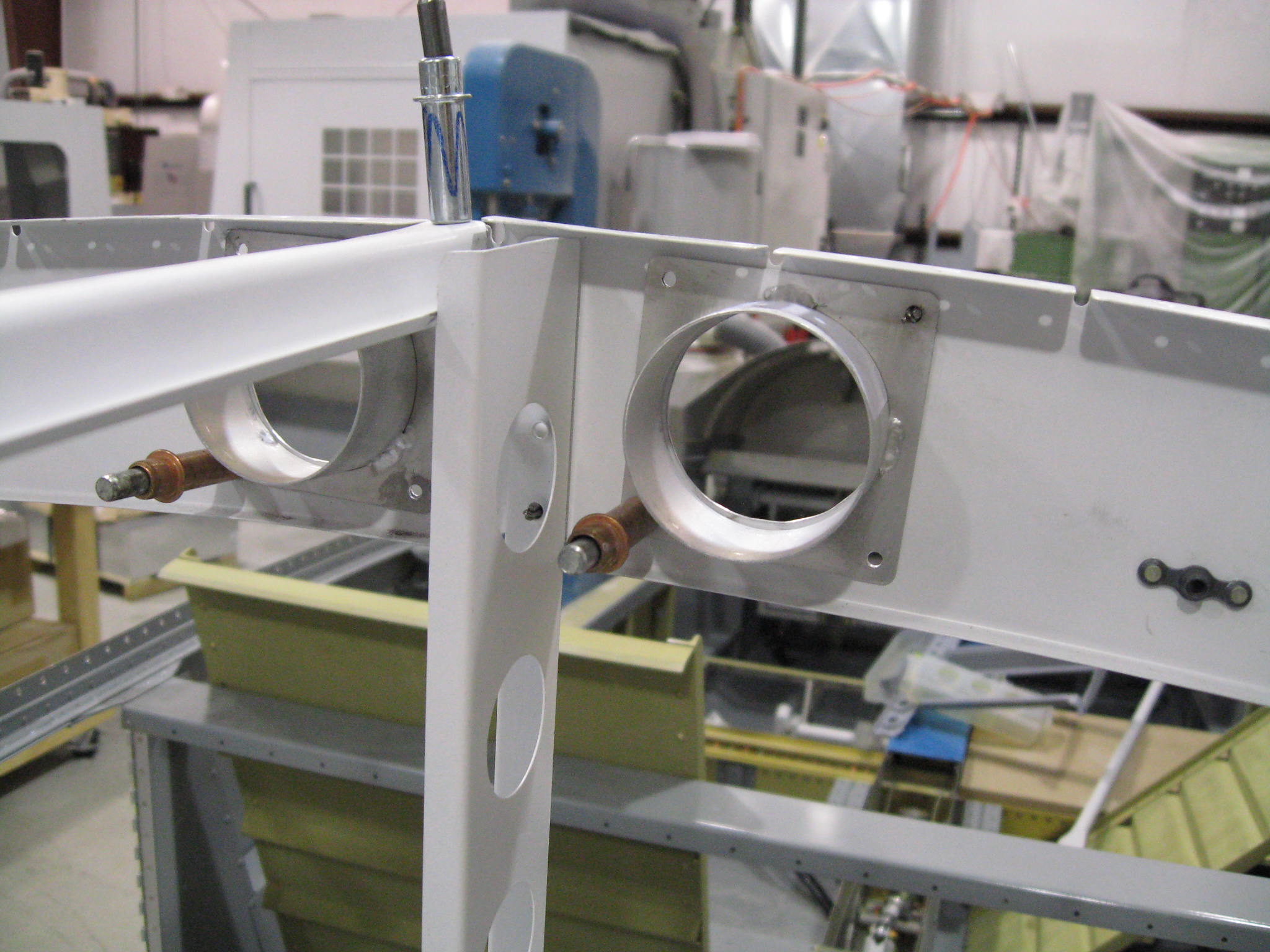

PostPosted: Mon Oct 01, 2012 12:07 pm    Post subject: Re: RV-10 Fibreglass Overhead Console Reply with quote
Patrick, I dug through the hanger and the garage and do not have the 'instructions' for the overhead. You aren't missing much though by way of guidance from them though. On my installation I had no issue with the vent clearance. I tried to attach a close up picture of my vent so you could compare. Were I really had trouble was the joggle on the canopy cover over the back seats. Not even close is an understatement. Not only was it not in the ballpark, but we were playing different sports. I had to do remove the sides for about 8 inches forward and aft of the joggle and reshape it all. Minor work in the grand scheme of things. I did not however have an issue with clearance. With the vents installed there is no restriction of movement and with about 3/4" between the vent and the canopy I get plenty of airflow. Never had the vents fully open in cruise. Getting a whole lot of air out of them. Feel free to PM me if there are any specifics I can try to help you with.
Eric

rv10free2fly(at)yahoo.com
PostPosted: Tue Oct 02, 2012 1:41 am    Post subject: RV-10 Fibreglass Overhead Console Reply with quote
Eric, I had no issues down he back, it's the front that's giving me grief.
I'll need to build up he front with a small base in order to lower the vents away from the overhead and the cabin top on order for the vents to clear the cabin top.
I'll get there, however progress is slow.

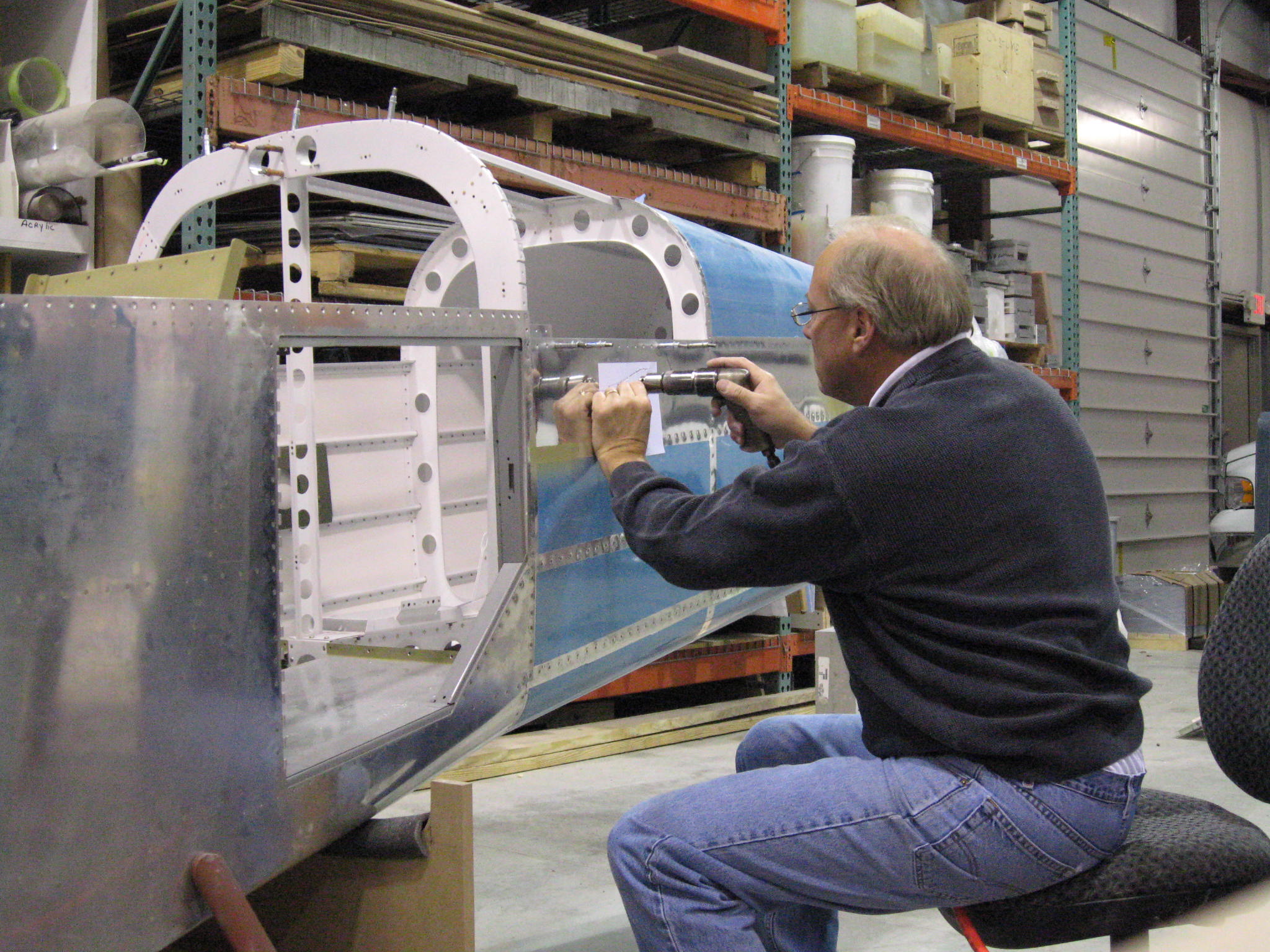

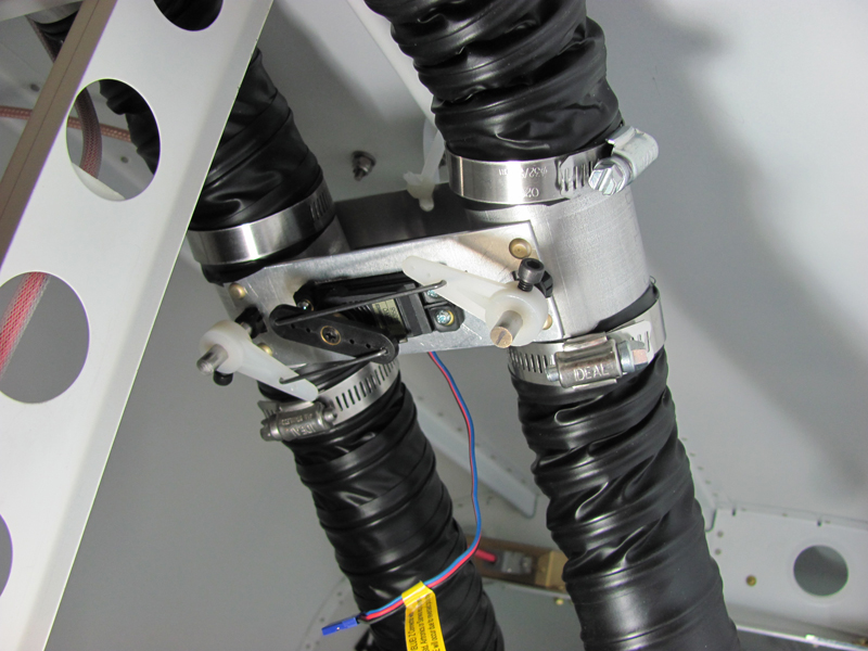

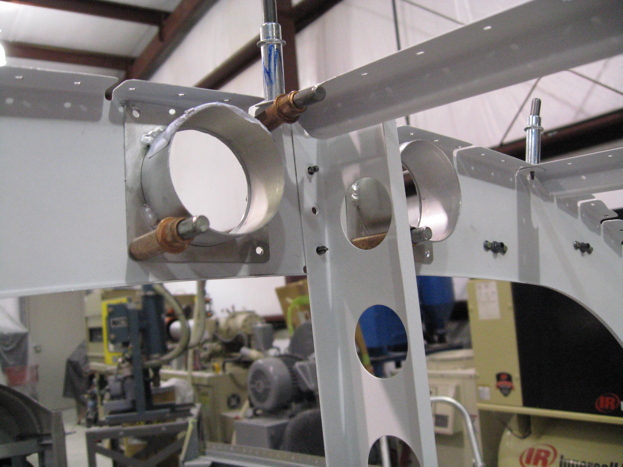

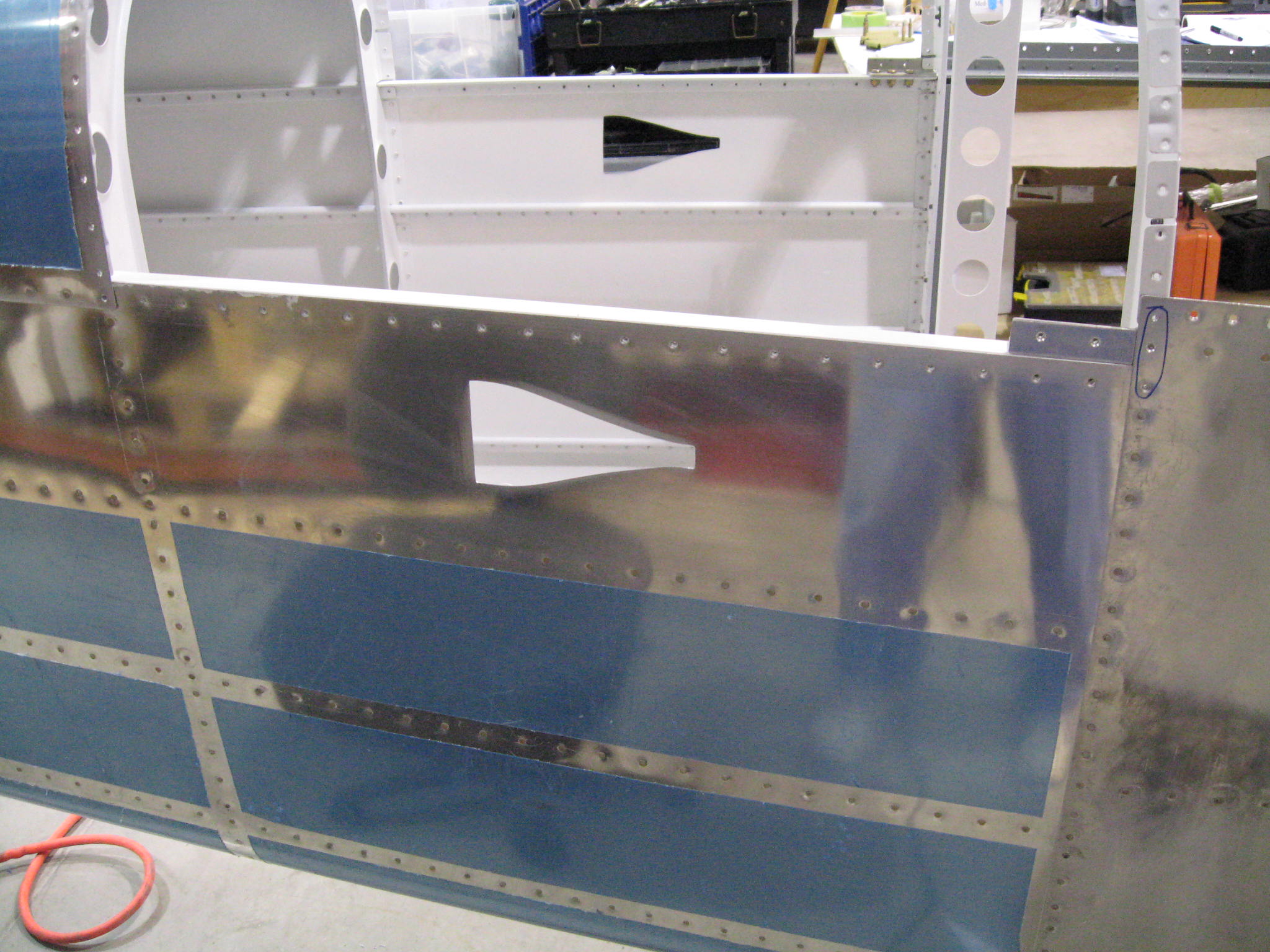

PostPosted: Tue Oct 02, 2012 5:02 am    Post subject: RV-10 Fibreglass Overhead Console Reply with quote
Carlos here are some pictures that might help. Just put a NACA scoop as in the photo 2" scat tubing from the NACA
to the bulk head fittings as in the pictures.
Hope this helps

glastar(at)gmx.net
PostPosted: Tue Oct 02, 2012 5:06 am    Post subject: RV-10 Fibreglass Overhead Console Reply with quote
Carlos,
there are several ideas around however at the end it is always the need
to create an outside air opening going into that overhead console, that
could be an NACA inlet on the top (do not forget to care for the water
entering it or you have a shower Wink or some other opening bringing via a
duct some fresh air to that console.
For Iberia you could look into an aircon as well instead?

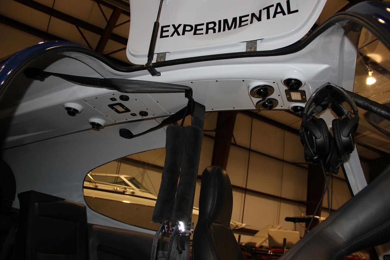

Strasnuts
Joined: 10 Feb 2009
Posts: 502
Location: Salt Lake City, UT
PostPosted: Tue Oct 02, 2012 6:45 am    Post subject: Re: RV-10 Fibreglass Overhead Console Reply with quote
Carlos,
I have 260 hours with Aerosport's overhead console. It is one of the few must have's in my opinion. Really nice haveing multiple areas to adjust air instead of one blasting your left kneecap.
