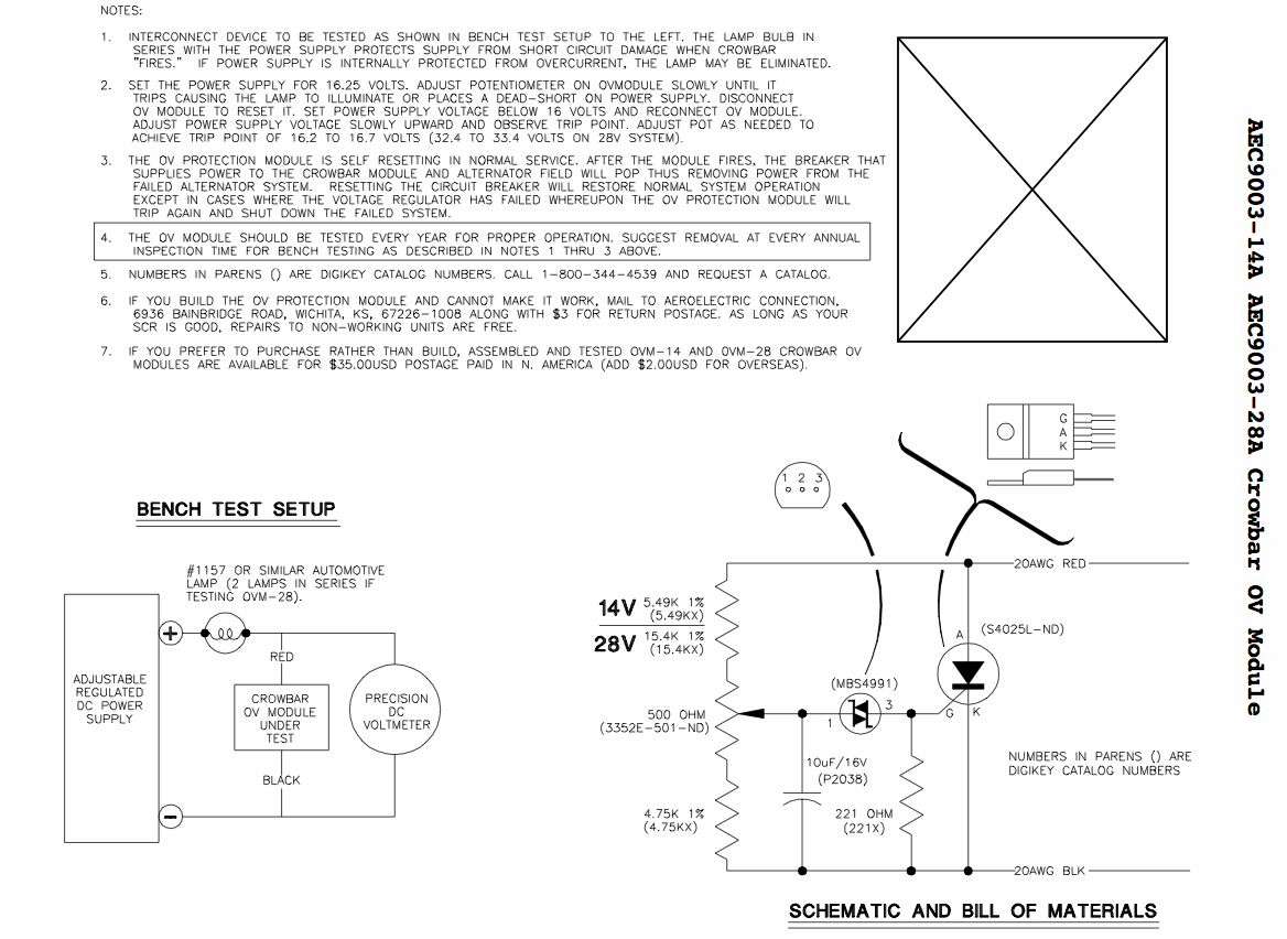

Can anyone suggest a decent Adjustable Regulated DC Power supply I could use to perform the OVM-14 protection module calibration?
How about something from MFJ enterprises? Per the attached bench test from Bob, I'd need something adjustable up to 16.25 volts.
Thanks for your suggestions and help here.
