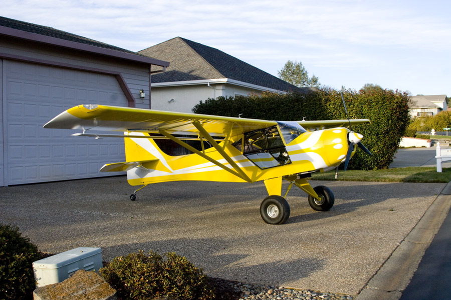

I've been flying my new Model IV for the past couple of weeks and thought it
timely to post some thoughts.
It seems to fly pretty much exactly like the old one. After about four
hours tweaking the engine and pitching the prop, the Hobbs now shows just
shy of 14 hours. Tests show that the ASI reads about 9% low so that will
give give bragging rights with stall speed, but cruise will need an
explanation. I get not quite 1200 ft. per minute on intitial climb. Temps
are all in the green and my home brew rudder trim system seems to take out
the need for right rudder in cruise. I still don't know for sure if I have
a heavy left wing - it likes to make a very slow bank to the left, but
really slow. I will probably put a half turn on the right wing aft lift
strut rod end and see. the first flight was heavy stress on me as I had
made a few mods - home brew engine mount with the engine a couple of inches
forward to provide some room for a lower mounted oil tank. Aluminum Leading
edges on the wings vs. the upper false ribs, the rib warping rudder trim and
a few other mostly cosmetic things. The empty weight came in at 667 lbs.
Unfortunately, I have an hour commute both ways to the flight test area, the
best part of that, though, is that Lincoln Regional is a hotbed of
experimental activity. I have met some great guys - mostl rag and tube, but
up to a Thunder Mustang - and was offered a hangar on a monthly basis, so
the pressure to get back home is gone.
The flight test area is flat as flat farm area in the Central Valley and
gorgeous and the winds tend to be very light to non existent this time of
year.
Lowell

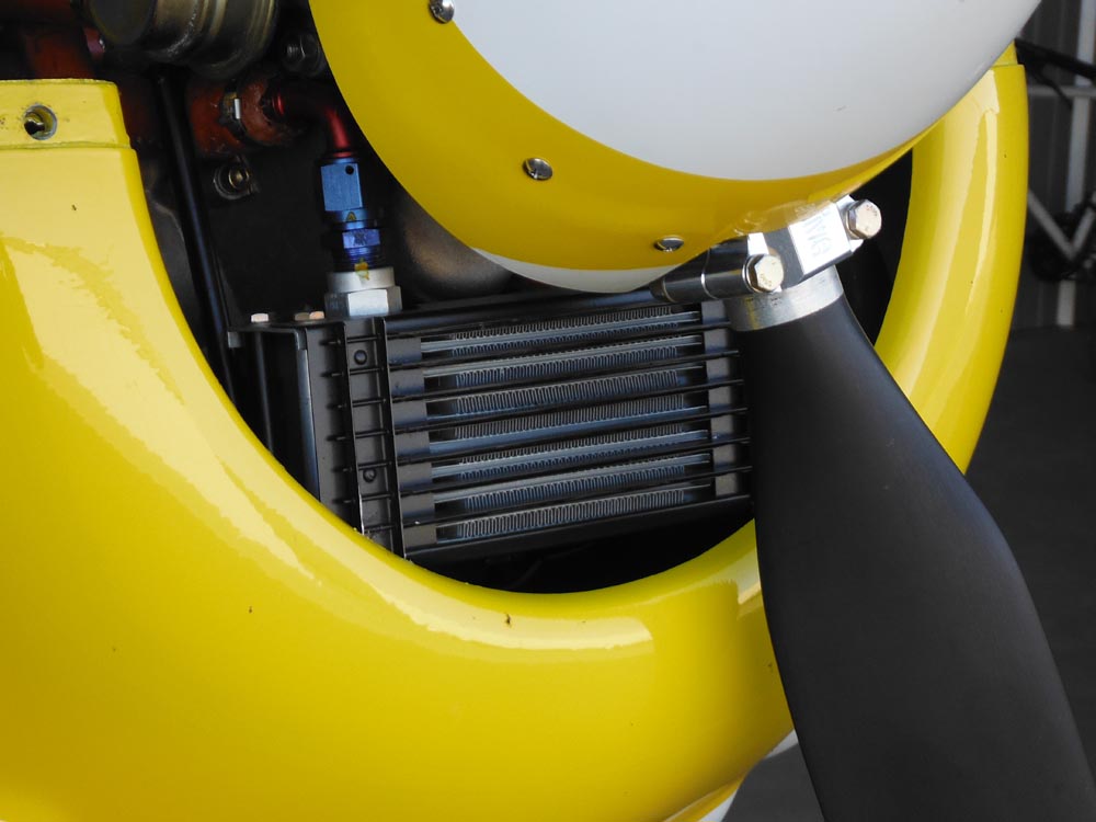

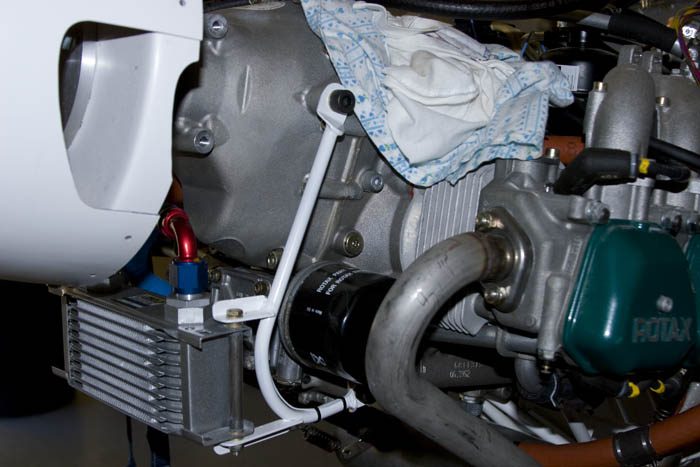

Beautiful Lowell. Can't wait to get back up to your place to see it. I
see you did a standard radiator install, do you have any pictures of
your oil cooler install? Is it below the prop spinner as before? Did you
do the vanes on the radiators? How about thermostats on the oil and/or
water. Your tailwheel looks different too. Did you custom the spring?

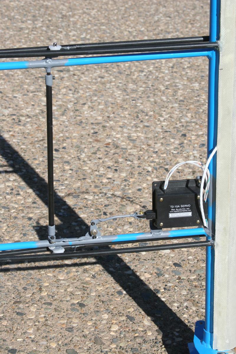

aero(at)rwaltman.com
PostPosted: Thu Sep 20, 2012 6:41 pm    Post subject: Back in the Air Reply with quote
Lowell,
The plane looks beautiful, congratulations!
Care to share details on the rudder trim?
Roberto.

Guy, - The radiator is standard. I had the speedster cowl like housing last time. I think eventually that will be done again. No shutters on the radiator - opted for a thermostat. It works great - contact Mark. The oil cooler is in the same place with shutters. The first picture is the mount style, but this is a V that I helped a guy finish. The shutters have half inch vanes instead of the one inch on the last one. The spring you saw on the picture was an attempt to put on a stinger type spring, but despite protecting the spring on the trailer ride to Lincoln, the stinger was damaged as we rolled the airplane onto and off of the trailer - lots of weight back there with the wings folded and the angle up the ramp so I put the two leaf back on.

Roberto - The rudder trim was something I had been thinking about for about five years before the crash. (emergency landing) With the opportunity, I though I would try it. It consists of the lower two ribs in the rudder being made of carbon fiber arrow blanks - one on each side. (I have the speedster type gap seal in the hinge area so the vertical is an airfoil) There is a cam between each controlled by a servo and by energizing the servo I can warp the ribs. With the rudder in cruise trim, there is an airfoil on the left side and the right side is virtually flat. Picture attached of the mechanism.
