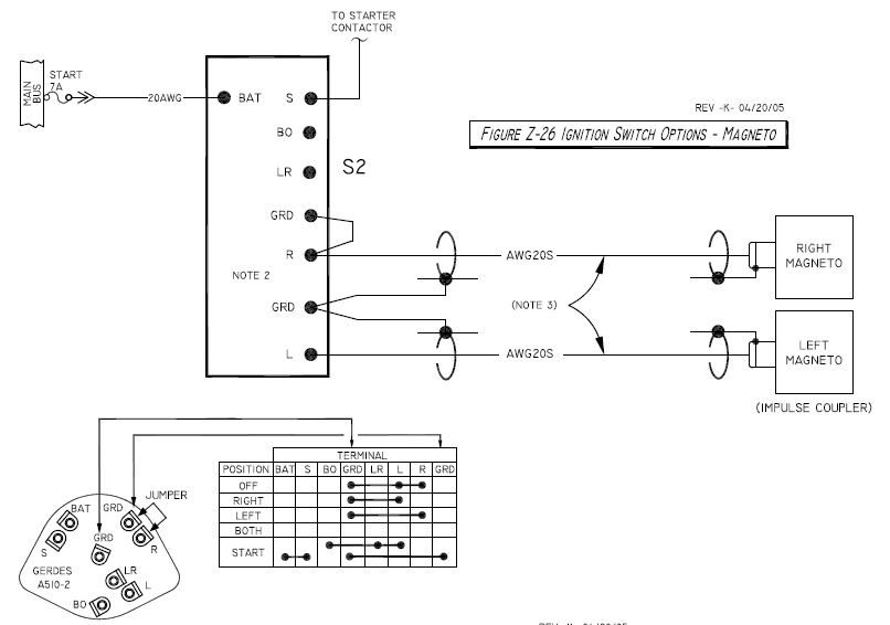

Do this experiment. Disconnect both the p-lead
center conductors -AND- ground wires at the switch
and leave them hanging. Fire up the engine and
see if the noise persists. Kill engine with
mixture.
If noise goes away, reconnect wires to the
switch but REMOVE local ground for the shields.
Wiring data in the book is figure Z-26.
[img]cid:7.1.0.9.0.20120913123717.01e22bb8(at)aeroelectric.com.0[/img]
The shields should be grounded at the engine end only.
I think this may fix your problem.

PostPosted: Fri Sep 14, 2012 9:33 am    Post subject: Mag noise Reply with quote
Thank you for your quick response to my problem. I have been
wrestling with this for two weeks. Every book I have on the subject
says to ground both ends of the shielding. In any event I took your
advise and the noise is gone. Medicine Lodge brings back memories to
me, I went to school at Emporia and my roomate was from there. I
trained on B-29s at Smoky Hill Air Base in WWII. Thank you again for
your help, it is much appreciated. Ed Dunn
I think this is perhaps the third time this
particular set of conditions propagated ignition
noise into the rest of the airplane. I'm not
sure I understand the exact mode of propagation
for noise but whether we understand it or not,
it's a demonstrably good thing to do.
