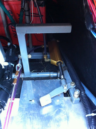

PostPosted: Sun Sep 16, 2012 4:11 am    Post subject: Re: FlagFly heel brake improvement Reply with quote
The Matco brakes on my Slingshot have the heel piece far enough aft that the pilot's heel falls naturally in the proper place for easy actuation.
Slingshot Matco brake master cylinder installation, right side
 Filesize:  70.65 KB
 Viewed:  13533 Time(s)

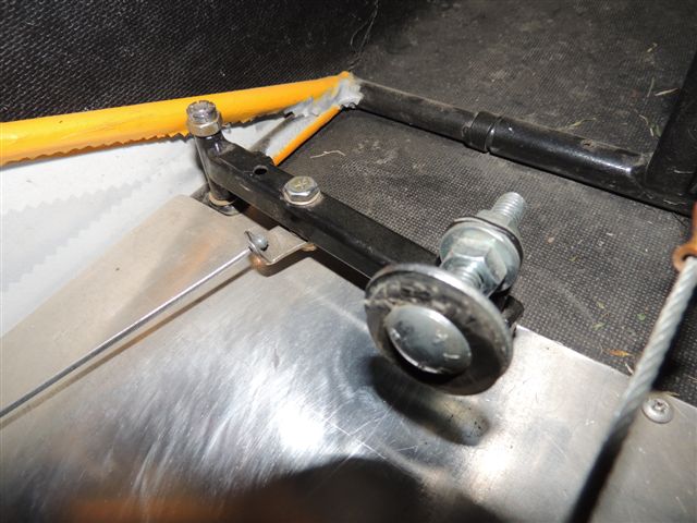

PostPosted: Sun Sep 16, 2012 6:29 am    Post subject: Re: FlagFly heel brake improvement Reply with quote
My Firestar came equipped like this with an adjustable heel brake.
 Filesize:  61.71 KB
 Viewed:  13518 Time(s)

PostPosted: Sun Sep 16, 2012 7:29 am    Post subject: FlagFly heel brake improvement Reply with quote
Dennis,
I notice that your brakes are mechanical, but mine are hyd, so the pedal
is a plunger that goes directly into the master cylinder. So I have to
extend the plungers.
Dave

G'day Kolb drivers,
I did a mod to my Matco heel brakes on my FlagFly that turned out to be one of those YES!!! moments. Reaching for my brakes required a very unnatural thrusting my heels forward all the while trying to steer with the rudder pedal. The way my knees are bent while sitting in the FF made it a difficult thing to do. So I went about trying to improve the situation.
First I cut two 3/4" lengths from a large dowel, shaped the one side concave to match the brake pedals, and epoxied them to the pedals. Felt a lot better in use, but in a short time one of them came off, so I removed the other one, too.
Flew that way for a while, but still wanted to do a more permanent fix, so I hunted through my "stuff" and found that the diameter of the brake pedals is just slightly larger than the OD of 1 1/2" PVC. I trucked over to Home Depot and browsed through related items to try to find something which would fit over the pedals and not have to be glued on. And there they were; rubber end caps with hose clamps to cap off an inch and a half PVC pipe.
Bought two and brought them home. Measured the inside depth and cut two pieces of inch and a half PVC pipe about 3/16" shorter, using my radial arm saw in order to get a perfectly square cut. I pushed the pieces of PVC into the end caps, moved the clamp flush to the edge, and pushed them onto the brake pedals. Tightening the clamps then compresses the edge of the rubber cap nicely around the edge of the pedal while the downward force is transmitted from your heel to the pedal via the PVC pipe. A very solid function.
I checked for any conflicts from the screw mechanism on the clamps and finding none, climbed in and worked the brakes and rudders. Not only does it allow my foot to position perfectly, the rubber creates a slip-proof surface, like the brake pedal in your car.
So, if anyone else has the same annoying foot position with your heel brakes, maybe you can give this a try. About five bucks and fifteen minutes is all it takes.
