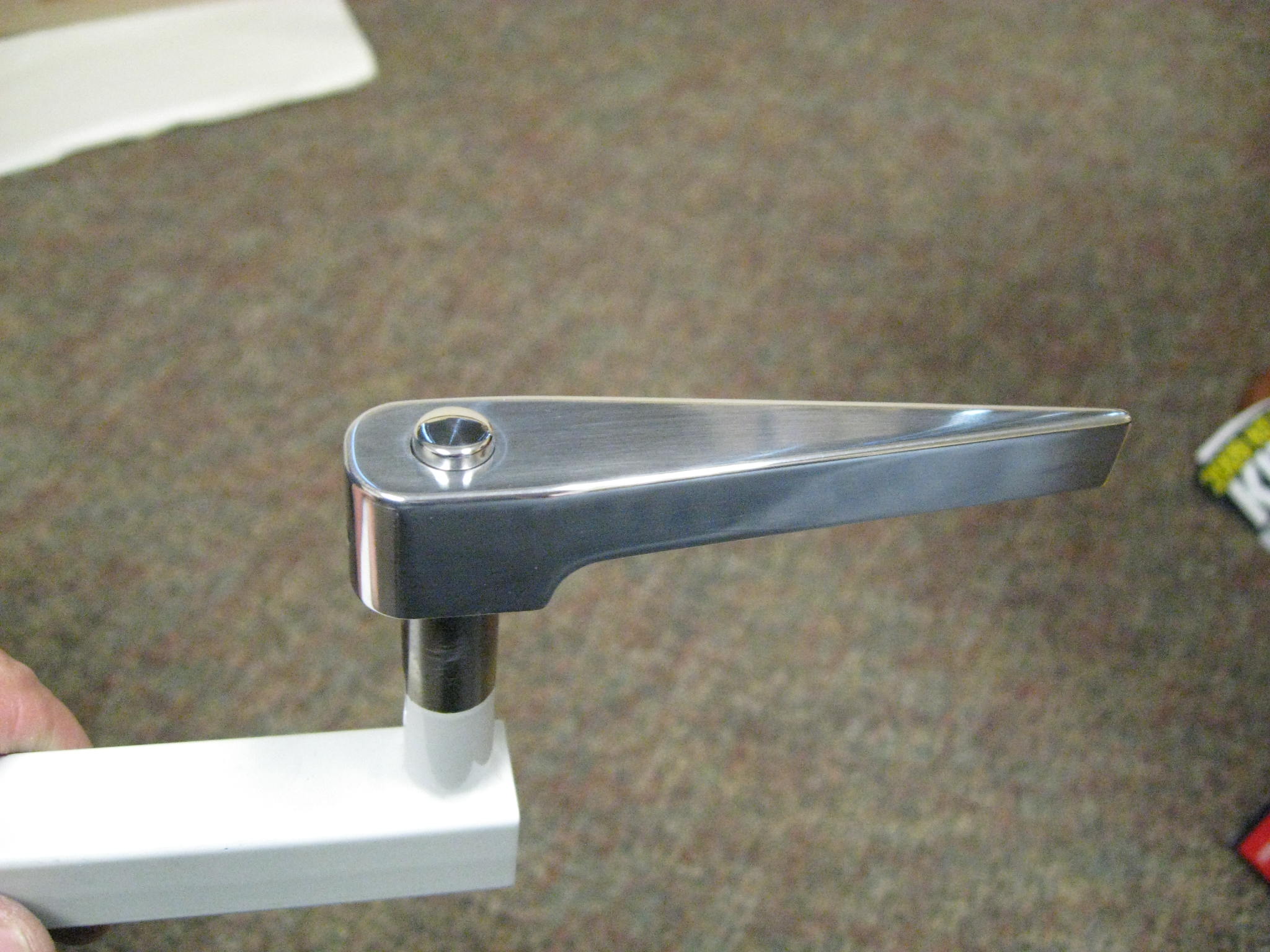

Here is what I did. Made a little aluminum cap that pressed into the rod.
Looks good and
Is easy on the thumb
Geoff

That looks really nice! And the polished handle looks very good too, well done. Just more stuff to add to my list of things to spruce up now that I've had the airplane flying for a number of years.
Marcus

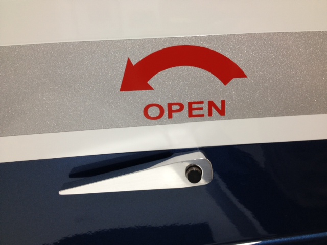

PostPosted: Fri Sep 07, 2012 7:18 pm    Post subject: Button For Exterior Door Handle C-1007 Reply with quote
Mine also have this nylon button. Came with my kit....

PostPosted: Sat Sep 08, 2012 4:07 am    Post subject: Button For Exterior Door Handle C-1007 Reply with quote
Mike,
Where did you get the door open decal?
Alan

PostPosted: Sat Sep 08, 2012 3:25 pm    Post subject: Button For Exterior Door Handle C-1007 Reply with quote
I purchased the decals from Vans, it's in their catalog.

PostPosted: Sun Sep 09, 2012 9:02 am    Post subject: Button For Exterior Door Handle C-1007 Reply with quote
Mike,
just went to order door decals and i noticed my door opens(clockwise) the opposite direction of yours.??
Alan

PostPosted: Sun Sep 09, 2012 9:41 am    Post subject: Button For Exterior Door Handle C-1007 Reply with quote
Hmmmm, mine definitely turn counter clockwise to open. You might want to re-check yours, I don't think it should be any different.

My pilots side opens clockwise
My copilots side opens counterclokwise
Both sides it is a down direction.
Alan
On Sep 9, 2012, at 2:10 PM, Tim Olson <Tim(at)MyRV10.com> wrote:
Hmmm, how many sides does and RV10 have? Do they BOTH open clockwise or both open counterclockwise?
On Sep 9, 2012, at 12:41 PM, Michael Kraus <n223rv(at)wolflakeairport.net> wrote:
> Sent from my iPhone
> On Sep 9, 2012, at 1:01 PM, Alan Mekler MD <amekler(at)metrocast.net> wrote:
>> Mike,
>> Alan

>>>>> On Sep 7, 2012, at 11:18 PM, Michael Kraus <n223rv(at)wolflakeairport.net> wrote:
>>>>>> -Mike Kraus
PostPosted: Sun Sep 09, 2012 1:16 pm    Post subject: Button For Exterior Door Handle C-1007 Reply with quote
Yes, that is how mine work. Sorry for the mistake. The picture I posted was of the pass side. It opens CCW. Pilot side opens clockwise. You need to buy one of each decal.

Mike ,
Thanks to Tim's post I went down to the plane and noticed the difference. I always get in the pilot side and unlock the passenger door from the inside.
Alan
