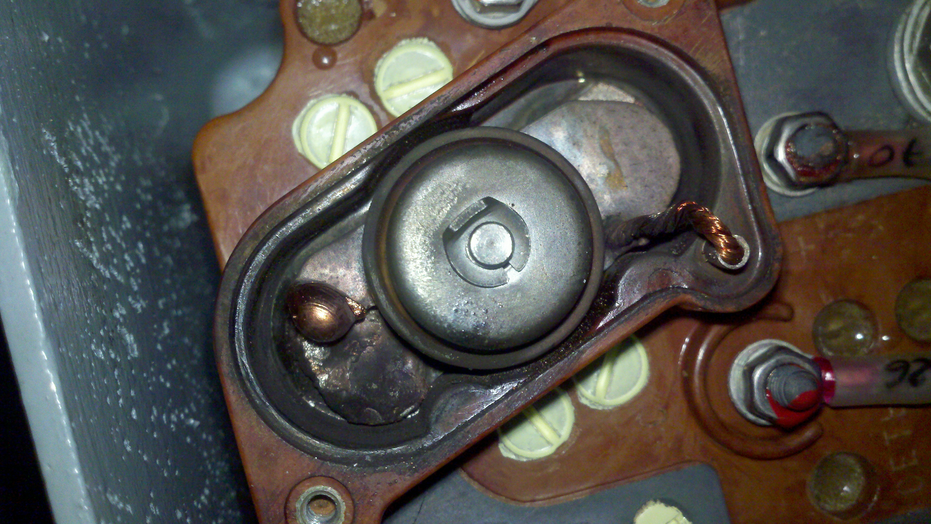

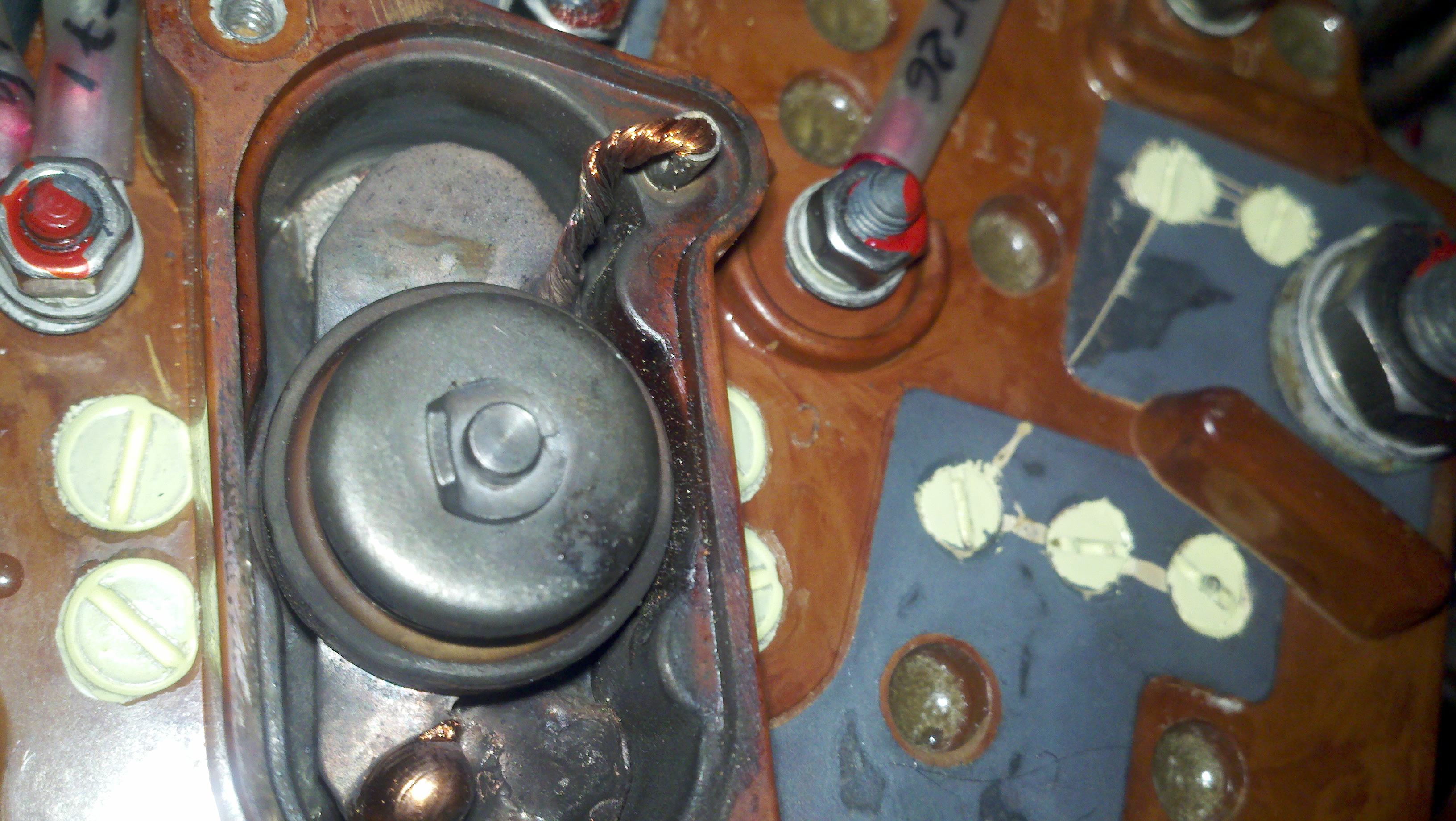

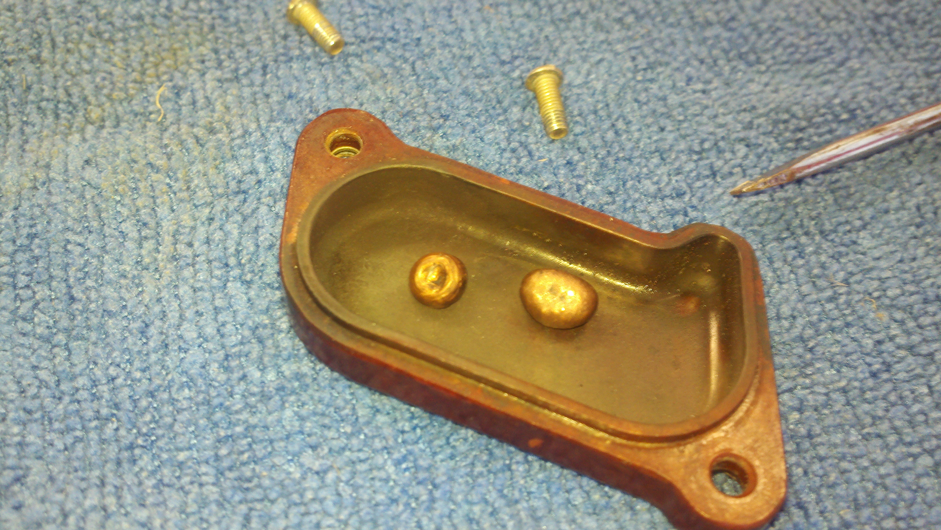

Our good ol' generator went off line and our troubleshooting finally led us to the DMP-200 latching relay. I dug the glue out of the screw holes and when we got the cover off it was totally burned inside and two melted balls of copper fell out onto the floorboard. Suffice it to say we found the smoking gun.

Take a hard look at what "melted", and take a picture and post it if you
can.

Thanks for that info. Attached is a photo I took today with the unit still installed in the airframe. It looks to me like one whole side of the relay burned off. I also took a photo of the two balls of copper that liberated themselves at disassembly. (Formerly braided wire on the burnt side) I will remove the unit and (carefully) try your suggestion to see if we can get battery power with it removed. We did recharge the batteries and have been able to use normal battery power and all electrical systems (sans the charging system, of course) with no problems.
