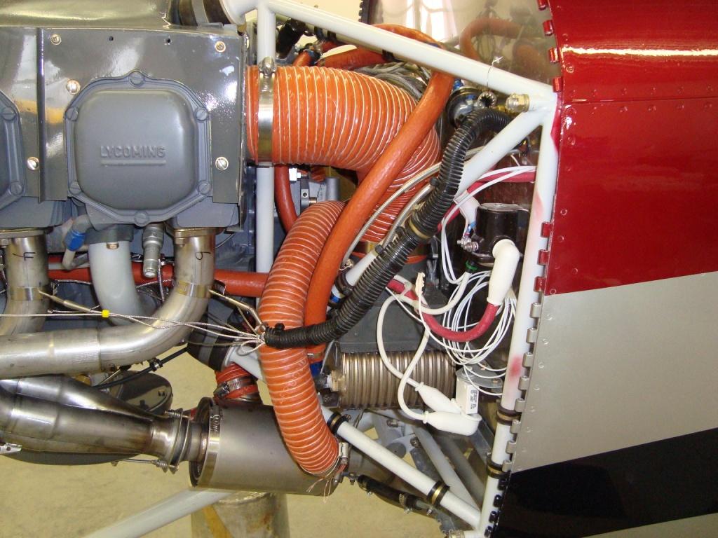

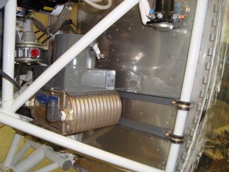

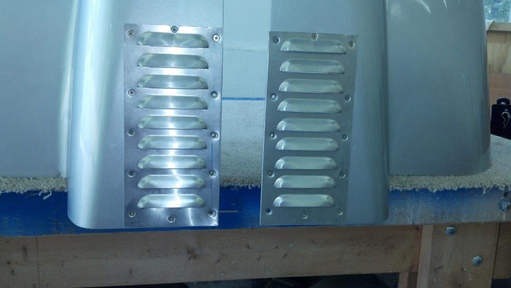

I too have the James Cowl and plenum (stock Van’s IO-360 and Hartzell prop).  At 39 hours now I'm satisfied with the engine temps.  Here are the modifications I made:
<![if !supportLists]>· <![endif]>I was not thrilled with the Van’s lower cowl louvers.  I instead added a set of cowl louvers to the bottom of the cowl.  Photo attached.  While I was able to have acceptable (but on the high side) CHTs with the cowl without the louvers, I had to keep the speed up in the climb (~140 knots).  A hot day run with the louvers (85 degrees ground air temp) have CHTs noticeably cooler – peak temp on an aggressive 120 knot climb to 8500’ was 426 degrees (dropping rapidly once passed 4000’).  In high speed cruise CHTs were between 365 and 390.  I got these louvers from Avery Tools.  I trimmed each side 1/8” and cut off the top two slots.  This is a simple mod, and I will replace the louvers with blank plates for winter time.  Flight data is scattered, but if anything the louvers may have a 1 knot or so speed penalty.
<![if !supportLists]>· <![endif]>I did not use the weird Van’s angled oil cooler mount and my oil temps have been cooler than what I hear on RV-10s using the stock Van’s cowl.  I find it necessary to partially shut the oil cooler air butterfly valve to get the temps up to 190 or so.  Photos attached on how I mounded my cooler.
<![if !supportLists]>· <![endif]>I used the Airflow 2006X oil cooler – and recommend it.
<![if !supportLists]>· <![endif]>I really did not like the heat muffs blasting hot air at the engine mechanical fuel pump (i.e. cabin heat valves are shut).  I mounted the cabin heat control valves on a piece of KoolMat http://www.aircraftspruce.com/catalog/appages/koolmat.php such that the KoolMat folded over the tops of the cabin heat valves and then tucked in between the valves and the forward gear mount (sorry, I could not find of photo but this is very simple).  The result was on a hot day (no cabin heat) the heat muff discharge is directed down toward the cowl exit, not back at the engine.
Still doing speed runs but I’m measurably faster than Van’s numbers.  The James Cowl is not magical, it is simply an adjustment to the tradeoff between drag and cooling.  I’m happy on how it worked out for me.
