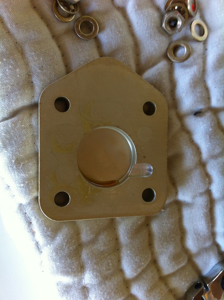

PostPosted: Wed Aug 15, 2012 4:34 am    Post subject: Lycoming Oil Line question Reply with quote
The answer that I got from Michael Yousik (of Mattituck) is "leave the
line in place" because of the plate that is installed on the governor
pad that allows the oil to be dumped into the sump.
See the photo attached to see the machining that was done to allow this.
Dale
