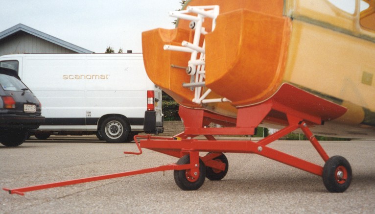

PostPosted: Sun Aug 12, 2012 1:26 am    Post subject: Jacking up the mono Reply with quote
Fred
I have found a picture of trolley that might fit your requirements. Picture
attached and I have added it to the web site. I know nothing about it and
the file name does not seem to help. Looking at the vehicles in the picture
it looks European but not UK.
Does anyone know who built it or more details?

PostPosted: Sun Aug 12, 2012 1:44 am    Post subject: Jacking up the mono Reply with quote
I think it is Finland or Denmark, Used to know his name but can't quite remember, Jens Szabo?
I know he sold his project unfinished, family reasons. He was in the Air Force and worked on F16 perhaps?
Sorry about the head scratching!
Graham

PostPosted: Sun Aug 12, 2012 2:58 am    Post subject: Jacking up the mono Reply with quote
Correct, Graham - as always Smile - F16, RDAF, name ...It was build by Jens Aabo, Jens Kristensen and me.
We build three examples, and Jens Aabo, Jens Kristensen and i each have one.
Works great.
I can upload detailed pictures if anybody is interested.
Gert

PostPosted: Sun Aug 12, 2012 3:07 am    Post subject: Jacking up the mono Reply with quote
Thanks Gert, give my regards to Jens if you see him.
Graham

PostPosted: Sun Aug 12, 2012 8:07 am    Post subject: Jacking up the mono Reply with quote
OK, check here: http://www.dalgaard1.dk/Dalgaard/Europa_jig.html
