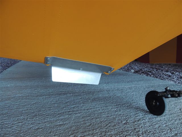

Hope this helps, as a starting point. This seems to work well for pilots 180 to 220 pounds. My Kolb Firestar II 503 , just a 2 "x 7/1/2" piece of aluminum.
 Filesize:  50.47 KB

I called Kolb and talked to Brian and he had the same suggestions as those above. I tried them all and eventually what worked is the trim tab.
I built the trim tab so that it adds nose up pitch per Brian's instructions. My 503 Firestar now trims out around 54 mph and 5,400 RPM versus 63 mph and 5,800 prior to adding the trim tab. The elevator has never fluttered at this slow speed.
Now when I pitch forward to increase speed, there is additional control cable tension and stick pressure. Basically, the pilot HAS to keep a hand on the stick to maintain 63-65 mph - the area where the elevator used to occasionally flutter in turbulence.
I am slowly building my "bump" tolerance for winds and thermals, but the elevator has not fluttered in any conditions since adding the trim tab, so for now at least, I consider the problem solved.
