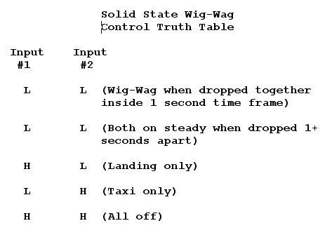

Greg,
Been up to my fanny in loft beds and plumbing but
while plying the asphalt between here and Wichita
I came up with this idea for getting "more" from
the OS wig-wag module.
How about two switches labeled LANDING and TAXI.
Have each switch provide an active LO to produce
an action on the two lights as follows:
[img]cid:.0[/img]
This would give the builder/installer the option of
both on steady or wig-wag depending on a difference
in paired or separate selection of the two switch
positions. If in single lamp operation, the switches
would both have to be placed at off and the simultaneously
placed to ON to switch to Wig-Wag. Otherwise, the two
switches independently control their respective lamps
in steady-on operation.

PostPosted: Mon Jun 25, 2012 2:32 pm    Post subject: Re: OS Wig-Wag Project Reply with quote
Bob,
That seems to be a good solution. I will spin a version of the
software for this and send another PIC chip along to you.
Probably sent off to you by the end of the week.

PostPosted: Sun Jul 01, 2012 9:33 am    Post subject: Re: OS Wig-Wag Project Reply with quote
Bob,
I have a new version of the software that implements the new
control logic and can flash it into a PIC and send it along. I
tested it on a breadboard and it seems to be working fine.
I need to change the sample board you sent to have
individual switches on the two control lines which I will
probably do sometime this week and then I will test the
new version on that board. In any case I will be able to
send a new PIC chip along to you this week that has the
new logic that you can use for your testing.
