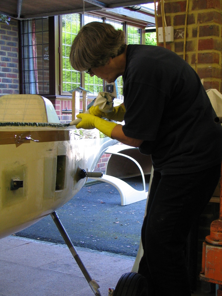

g-iani(at)ntlworld.com
PostPosted: Fri Jun 22, 2012 12:13 am    Post subject: bonding fuselage top Reply with quote
Paul
400 grams is about right. Mixing is the time consuming bit. Getting it on is easy with an icing bag and someone with cake decorating skills. See attached
Ian Rickard G-IANI XS Trigear, 300hours
